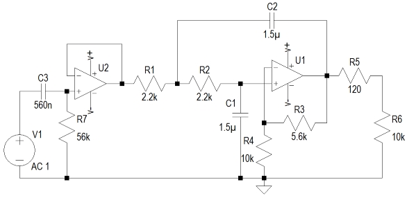

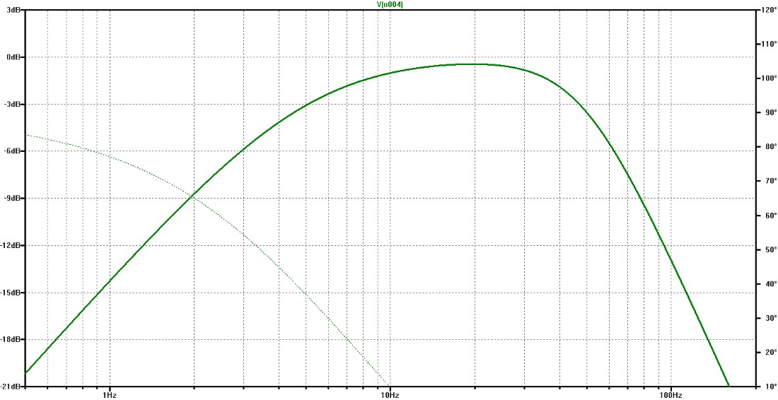

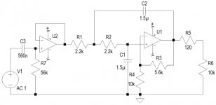

I'm going to design my enclosure according to my driver specifications, and I want to filter the input as in the attached images. I'm really just looking for that sub-bass, everything else is well sorted.
Now, I do have a quick question. How do you design for 2 drivers with quite different parameters? As I said, I am going for a sealed enclosure. My guess would be that I can make the enclosure as big as possible, finding a balance between physical limits and response curve shape. Or I can build an enclosure with two sealed chambers? Which would give the best performance? The problem with two chambers for me is simply size and shape. Is it really worth the effort of building two chambers, or will one be fine?
