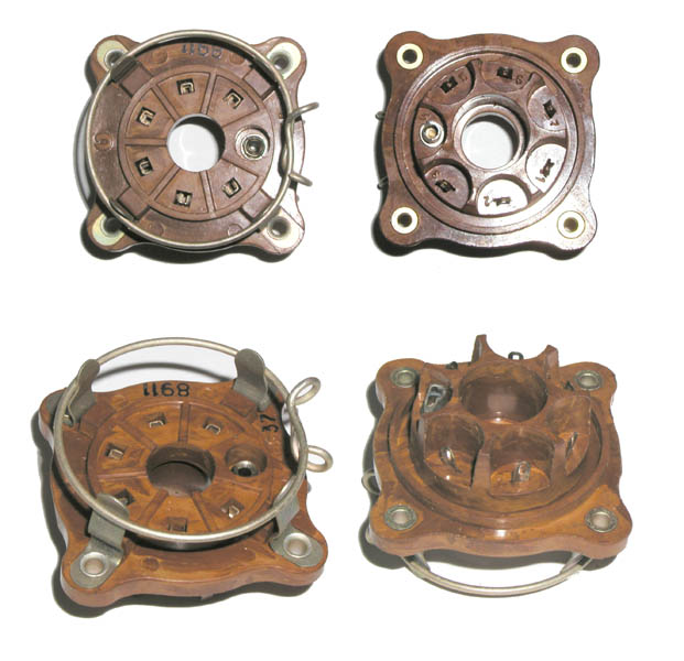

Over the years, Ive esperienced the issues of poor heater-pin contact with certain sockets, in fact I have two different types on this current amp.
One Russian white square ceramic type, --which has had a very hard life in other projects in the past, and I'm using three of the brown phenolic type sockets.
These brown ones grip the pins Very firmly, its Much harder to remove valve from this type socket than the ceramic type....
--The top of the socket in contact with the valve has gone black, but the pin contact is still very firm
Ive had to tighten the ceramic type a few times over the years (in other projects), and one of its heater connections had gone very loose on the rivet...
Heat and time will tell how the phenolic type last!:D

You are 100% right about this square ceramic Russian 6c33c tube socket, with fork type contacts.I seen everybody use them as original,(Profesionals & DIY) for 6c33c OTL aplication,but this ceramic sockets is not just reliable as Original 6c33c brown type (phenolic),but ceramic one is just OK for 6c41c tube. Example:
If Amps expirience some accidental mechanical shock,lets say during the Amps move from one room to other, 6c33c tubes will fall down from their sockets and broke :(
With this brown type Russian socket this is simple imposible,+ elecritcal & thermal contact with tube pins is superior !
About your autobias OTL amps again :Some electrical measurments have to be done(in one of future day),until than Enjoy :)
Finaly Only what is count on the end is the final judgement of Your Ears,nothing else !
Best Regards :up:
Ps: Mr Karsten(Atmasphere) explained somewhere on this DIY site one very good method for 6c33c tube precondition,which is prety important for future normal OTL Amp operation.

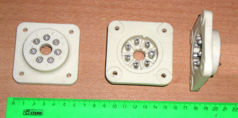

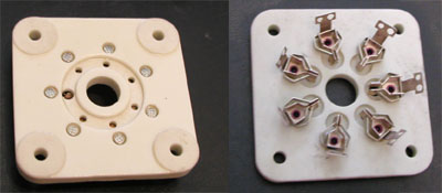

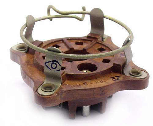

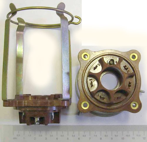

About 6c33c-b tube socket again,there is picture of four Russian 6c33c-b socket type.
Type 1,2 and 3 is just OK, type 4 is with fork type contacts,not bad but previous three types is much better and reliable.
Hmmm...
Like the look of type 3!
I have type 1 and type 4.....

Type 3 with ceramic base is superior one for 6c33c tube,but type 4 is just OK for 6c41c tube,filament current is only 2,7A(6,3V) and dont run the tube socket filaments contacts to the limit of endurance,released tube heat is lower to,
6c41c is about 1/2 of 6c33c tube and is just fine for OTL.
Anyway there have to be good air ventilation all around the tubesocket & tube placed on OTL Amp chassis,whatever tube socket is used for !
Best Regards
