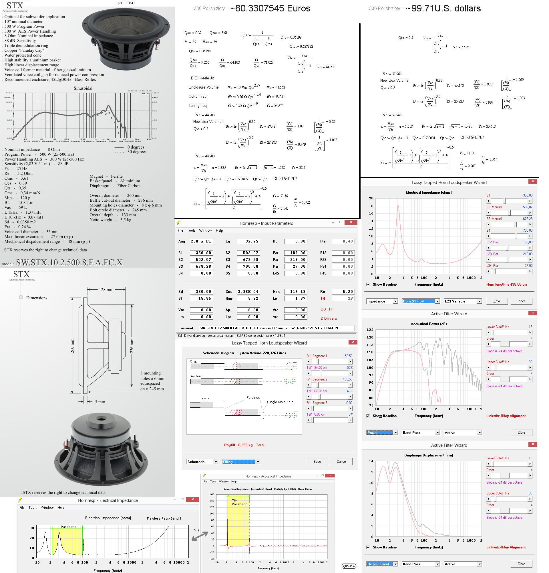

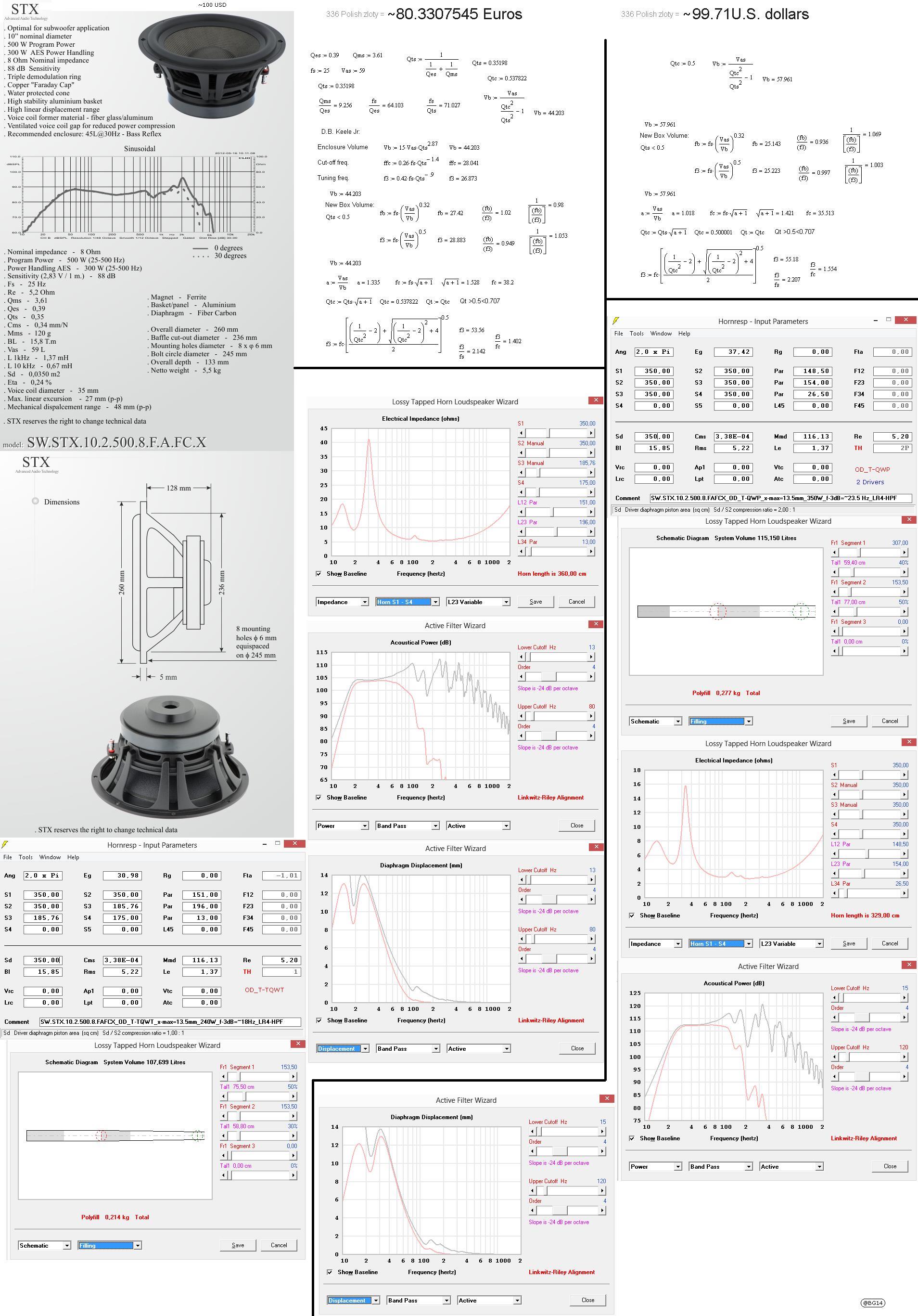

Bjorno is the master, so he'll probably correct me but i found this :
82L, 2x stx 10", 30-100 flat, f-3 a bit higher around ~25hz, 115db @2pi, under 400w/4ohm same filter as Bjorno master, 18mm displacement around 15hz (but mechanical displacement of those speaker is 24mm, so 6mm margin ^^ ), and 12mm around 38hz.
Simple bass-reflex with a lot of stuffing...
Is it viable ?

The doubt is that i get more db, in smaller cabinet !

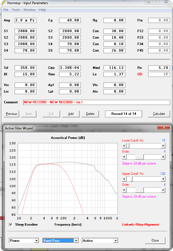

Ho...just simulated the ultimax 12" in 80liters BR...with f-3 @25hz, it hit xmax under 500w /115db max at 30hz, without being flat at all. So, correct me if i'm wrong but 2 stx 10" +/-= 1 ultimax 12" (in maximum db at same cabinet volume)
The ultimax being >>>>>>>200€ each whereas 2 stx cost only 160€, and 1 x swr12d4 found at around 180€ in local car market...
The stx possibly being built in two enclosures for more distributed bass...

Sorry...it's me again...
Ultimax 15" in 80L closed hit xmax @800w @ 30hz with 17-120 LR4 filter and simulate 117db, but with 25hz at -9db....even only 110db@25hz without high pass...
800w been the max power of the ultimax, you have to take in account maybe -2/-4db of power compression....
I've been a just a bit conservative with the 2x stx 10" BR stuffed. They can hit 117db too under 485w (still far from 300+300w aes). But they do it with 25hz at f-3...
