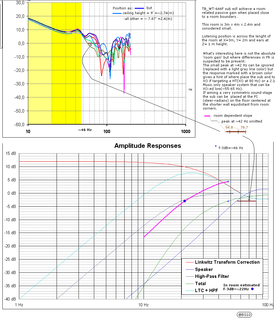

Hi Edmunds,
Here is an idea :
b:)

Here's a little information on the graphs Bjorno posted...
ESP - The Linkwitz Transform Circuit << this explains things pretty well...
The red line is the correction curve applied by the Linkwitz Transform. The turquoise (green-blue) line is the sum of the circuits (there's an infrasonic filter to stop over-excursion at frequencies you'll never reproduce). Below the turquoise line, is the new response of the driver, after the correction has been applied. Bjorno selected ~35Hz as a lower cutoff. You could ask it to go lower, but you start running into serious problems with excursion when you turn it up. The next line down (green) is the high pass filter, which cuts off the really low stuff, and the last line is the bass response before any correction is applied.

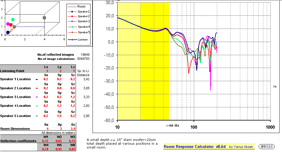

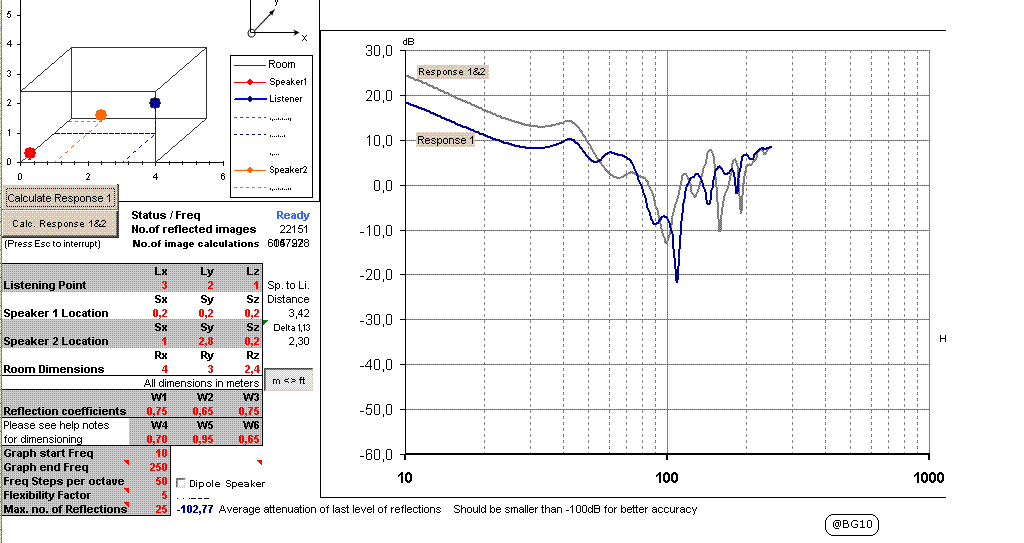

Thank you Cris for a perfect seconding of my simple picture: I've added two pictures that :eek:_probably needs more explanations...
b:)

Not a problem. I've used the same spreadsheet so I took plenty of time to ensure I know what I was doing.
The sims you've posted... I've never seen anything like it, but I could give it a go...
The yellow area is (I think) when the room enters "pressure mode", where the subwoofer pressurises the entire room equally, instead of sending waves around. This happens when the room size approaches (half?) wavelength of the frequency. Anyway, each of the different coloured lines correspond to a different position in the room, the positions and co-ordinates are shown (in metres, from the corner). If I had to choose one, I'd go for the green one, as there's no major peaks or dips there.
Following these sims (they only show how the room will interact - you have to combine them with a speaker response to see what's going to happen), I'd find a cabinet size that gives a fairly shallow roll-off (you could eq it to give a shallow roll-off if you desire), where the -3dB point is in the 60-70Hz range.
Of course, these simulations have their limitations - they only show the result of the bare room. Adding a sofa or other furnature is likely to improve results, as it's not all reflective surfaces.
Chris
