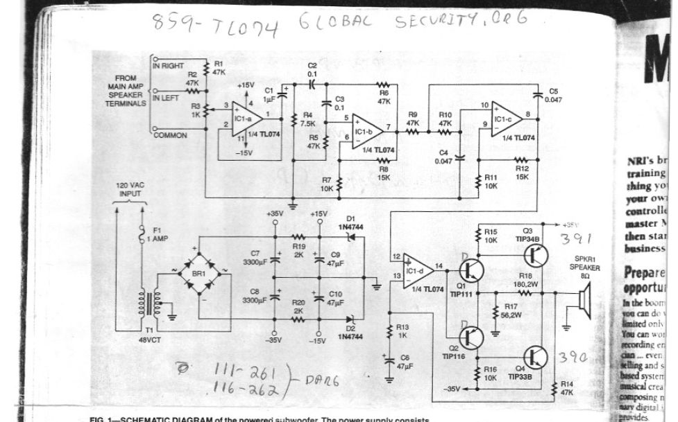

I got this from a magazine I built it and seems to work good,any comments
steven344 Member Joined 2005 2006-02-01 6:50 pm #1 2006-02-01 6:50 pm #1 I got this from a magazine I built it and seems to work good,any comments Attachments sub amp.jpg 92.2 KB · Views: 169 ••• More options Share S simon5 Member Joined 2004 2006-02-01 8:26 pm #2 2006-02-01 8:26 pm #2 To have more comments, I suggest posting this in the Solid State section... ••• More options Share Show hidden low quality content Status This old topic is closed. If you want to reopen this topic, contact a moderator using the "Report Post" button.
