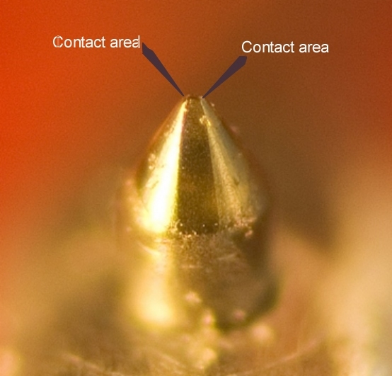

The Titan has a 3x70 line contact so similar to the microridge and certainly at the 'extreme' end of profiles. But from a front view it's hard to tell what the contact face looks like and how much it's actually sunk down the groove. Although his 1000 hours was a guestimate Lyra claim up to 2500 so something doesn't quite stack up. I think some photoshop on the pictures is called for.
