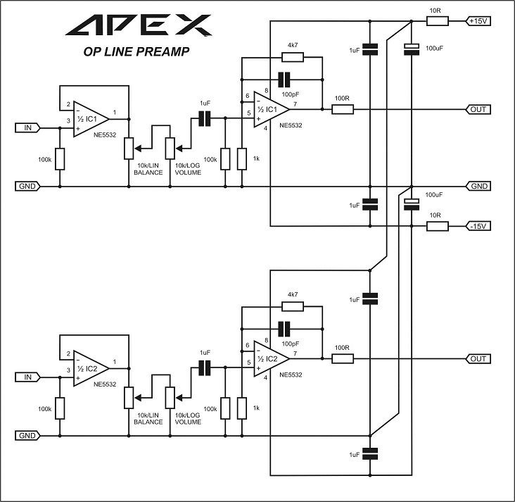

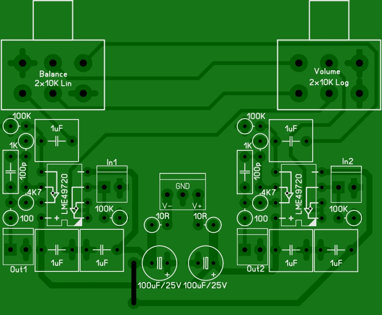

Can you draw a pcb for this Apex buffer? Many Apex amplifiers can be used with this.
Yes, I'll do it for you, but you must wait for a few days. I don't use any CAD program, I draw each pad and track. Also, I'm not experienced as AlexMM, Olaf or Mile, so my designs may not be optimal, but I'll give my best.
Thanks dobrivoje, for fast respon. I will build this.Apex SR PP12 not tested. 80 x 42.5 mm.

Use this preamp.
Thanks,take your time.I can wait for this.Yes, I'll do it for you, but you must wait for a few days. I don't use any CAD program, I draw each pad and track. Also, I'm not experienced as AlexMM, Olaf or Mile, so my designs may not be optimal, but I'll give my best.
A simple buffer like this, with common parts is useful.
Thanks Mr.Mile this is another option.Use this preamp.

thanks i will try this please give me black layout file and size if you have.Use this preamp.

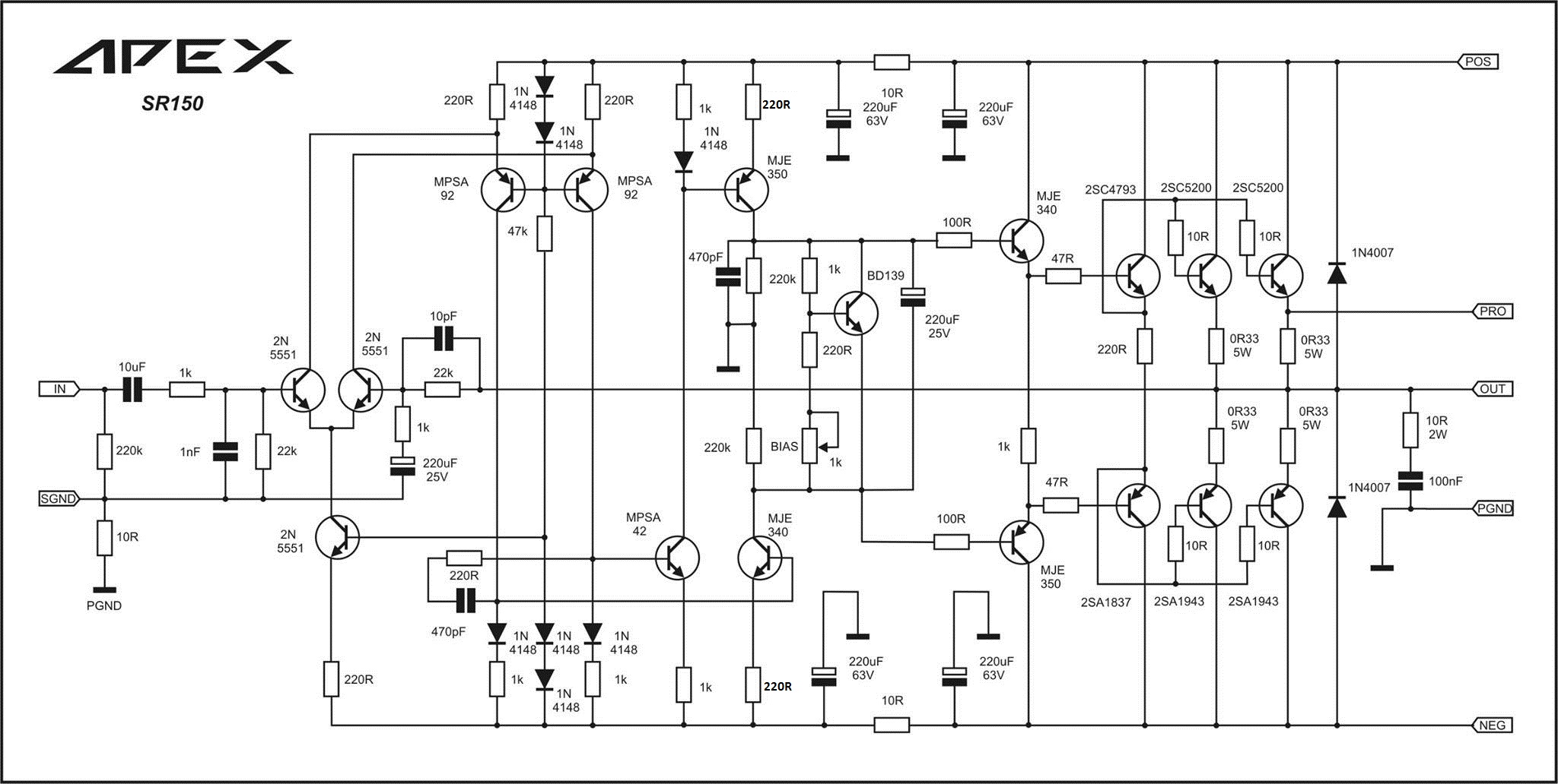

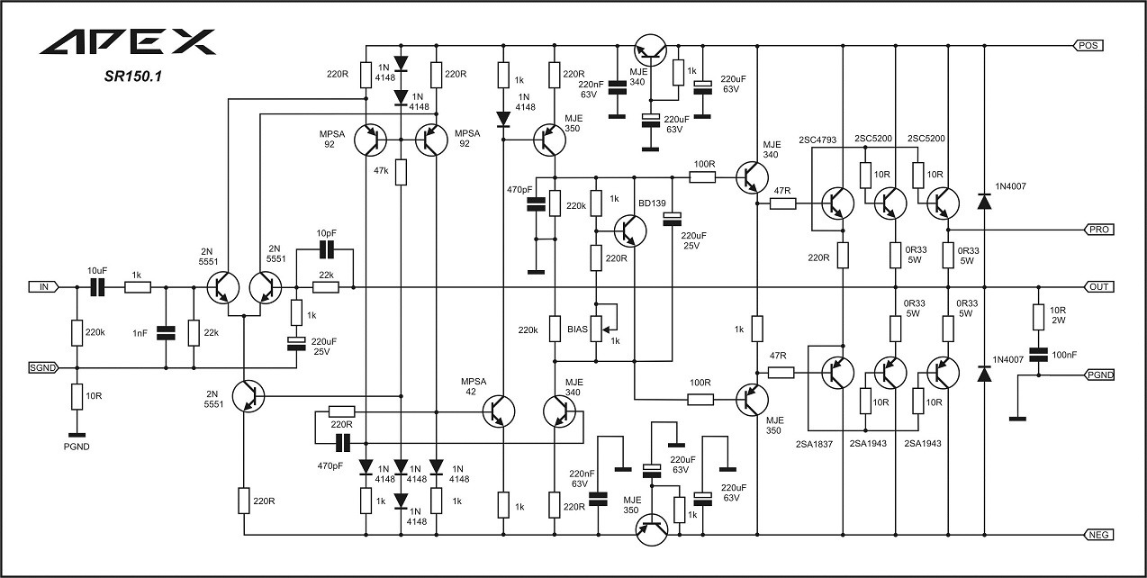

hi apex sir,i have 225va transformer and 14700 (10000+4700)uf per rail with 6 ampere diode.dc voltage +-55 and +-24(for sr preamp) and 5vdc for mp3 palyer.is 14700uf per rail is enough for sr150 stereo?thanks.
14700uF is ok.

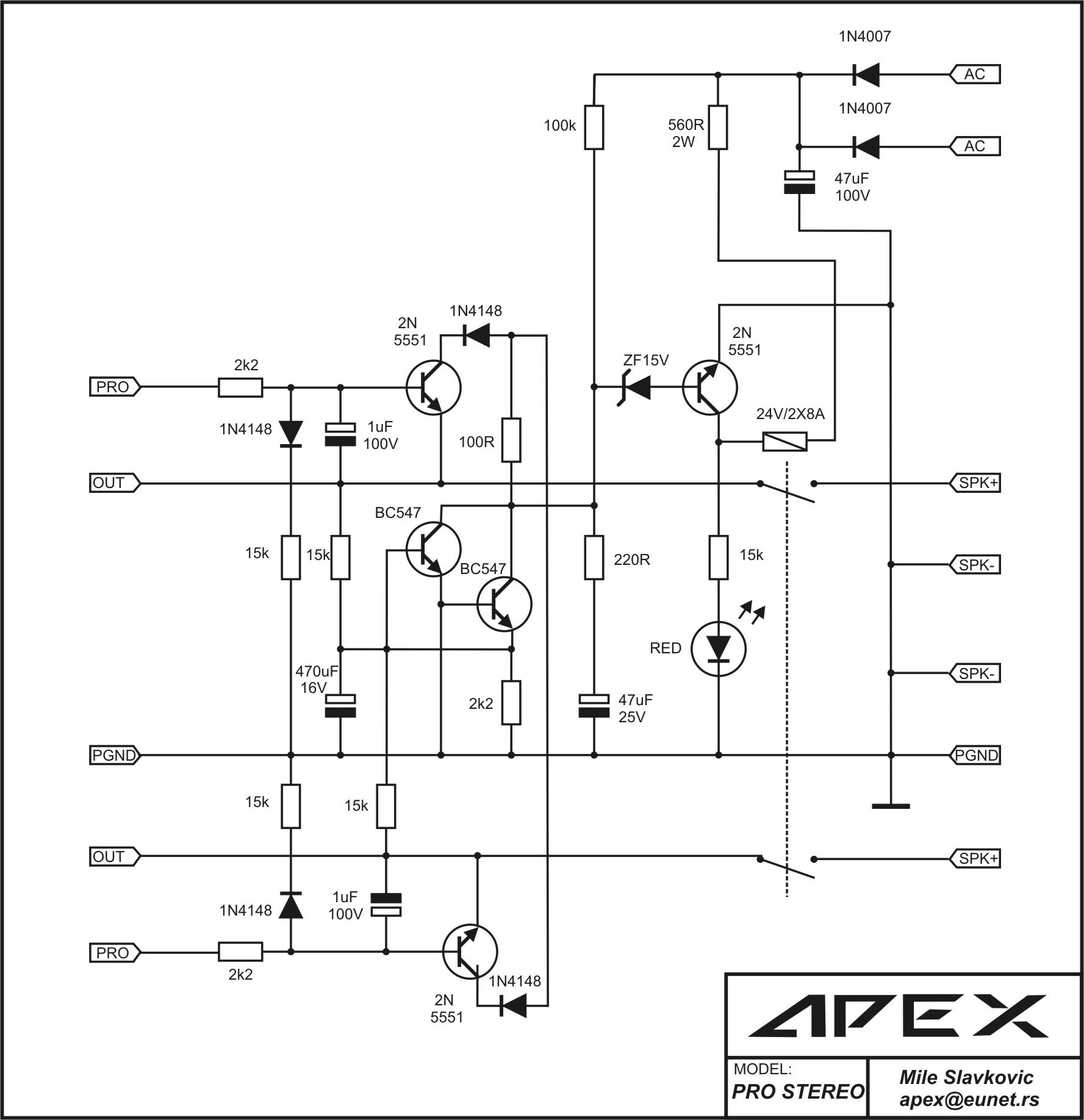

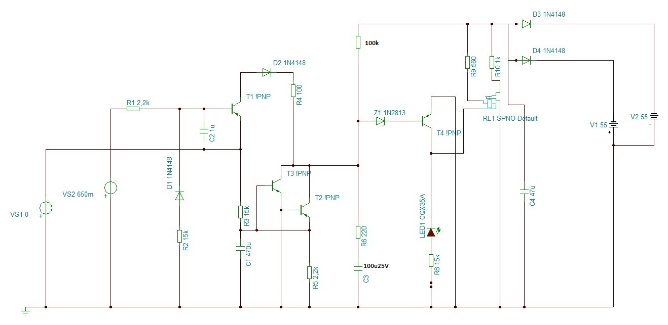

my SR150 works with 2x35Vac transformer,and that is a voltage that you connect to AC/AC on left/bottom side of pcb. AC/AC are connectors to supply protection circuite. you have a schematics of protection circuite in a post where i posted that pcb,instead 2N5401 better use BC516 (reversed pinout!!!),there is also an explanation how to chose resistor 560r,depending on your relay coil resistance.
protection circuite is based on APEX simple protection,only i changed voltage direction and with it polarity of diodes and capacitors and type of transistors (npn to pnp).

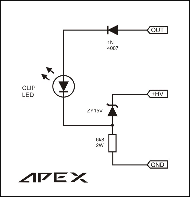

there is also clip-indication on this pcb.
here are all those schematics used on pcb again:
