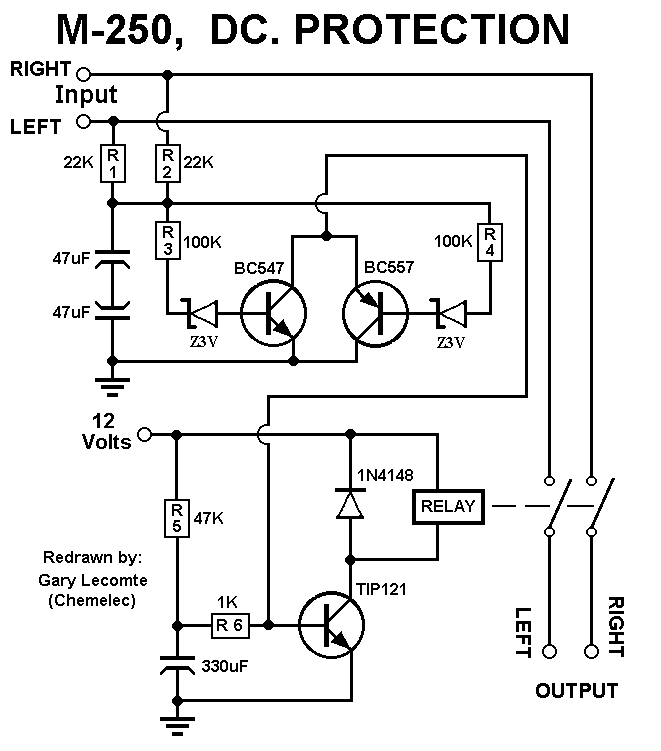

apex sir can i use this diagram
Shr,
have you calculated currents for that relay driver circuit?
The tip is supposed to be a switch. How much base current does it need to become saturated, so that it can act as a switch?
The BC transistors will have a Vce that is very low.
Again, have you looked at what base current the detector transistors need to operate with low Vce?
