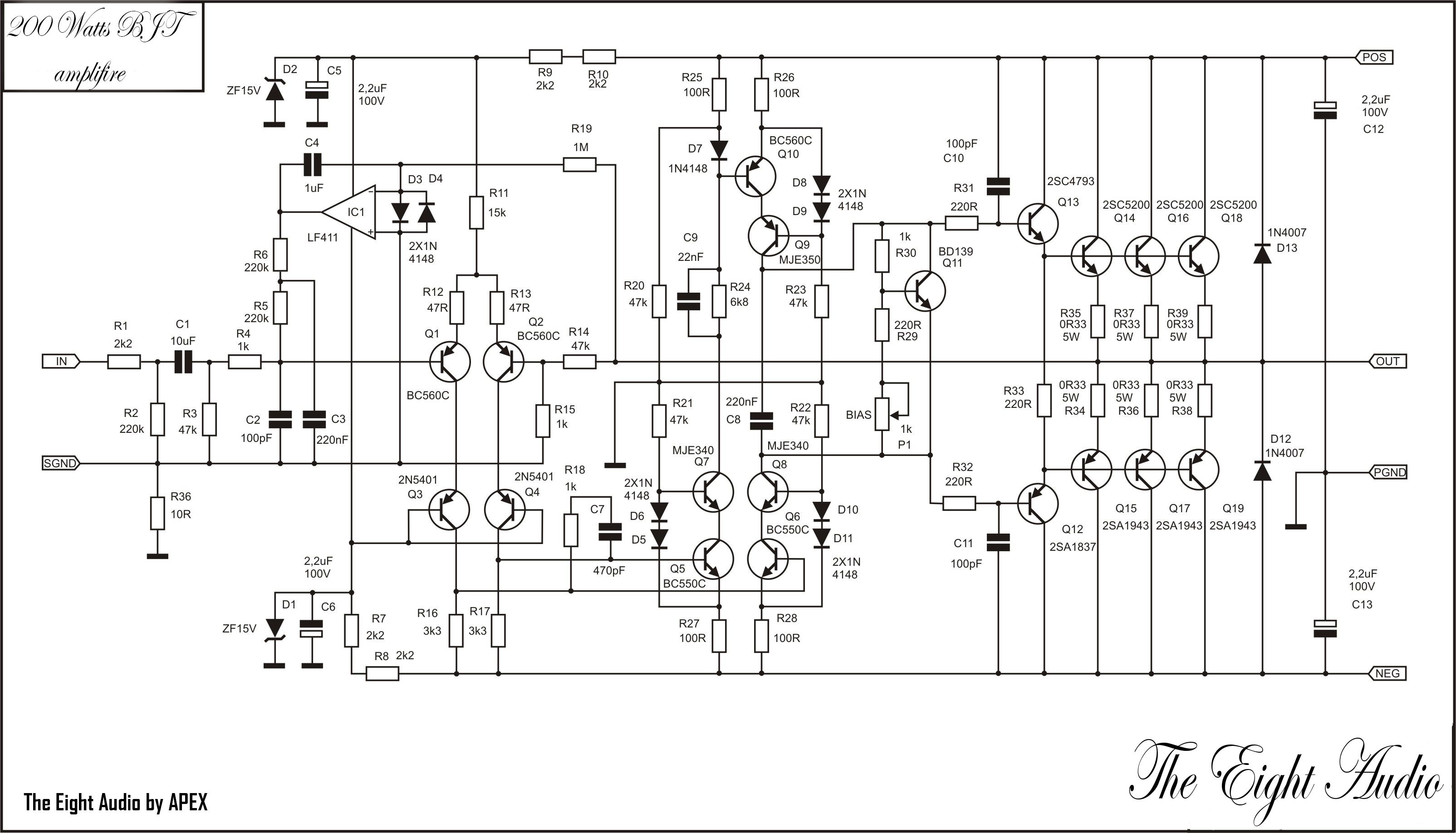

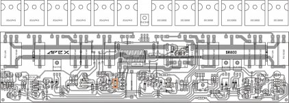

..... at first look you have supply rails to IC reverse . At pin 7 must connect positive voltage and to pin 4 negative voltage ......;)
Regards Alex.

this amp is designed to give 200W at 8R load and about 300W at 4R load. knowing APEX work it can only give you more power than rated.
putting more transistor pairs in output WILL NOT effectly increase output power because more output transistors burdens more the DRIVER transistors and than they become weak link in amplifier.
more transistors at output with the same load as predicted will make driver transistors work as they are designed to,and output transistors will work more relaxed than usual.
for more power you should either increase power supply voltage or put lower resistance load-in both cases there should be more corrections on the driver transistors and the whole amp before them.
put it this way-you can put 500HP engine in toyota yaris,but if you do´t work on chasis,suspension and breaks you will get nothing more than regular one unless you are willing to destroy it.
this amp with two chanels, extra pair of output transistors,transformer with 2x54Vac / +/-75Vdc power supply will need transformer of 800VA for 200W/8R load or 1200VA for 300W/4R load so factor is 2 counting power of both chanel. you can also use a factor of 1,5 but with factor of 2 and extra added pair of output transistors mounted on right heatsink this amp could work just about forever at full rated power (capacitors life would be than "the weakest link in the chain").

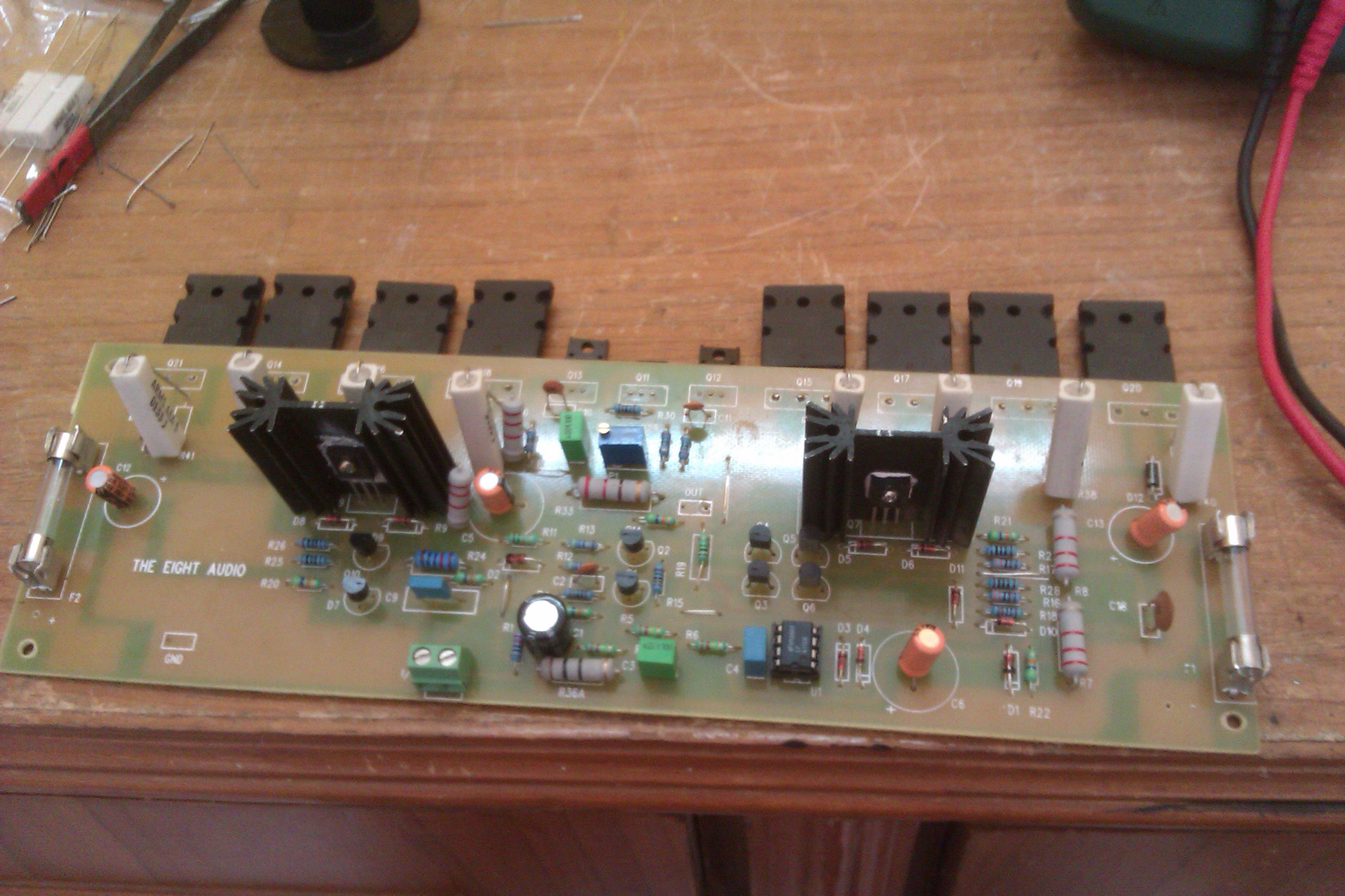

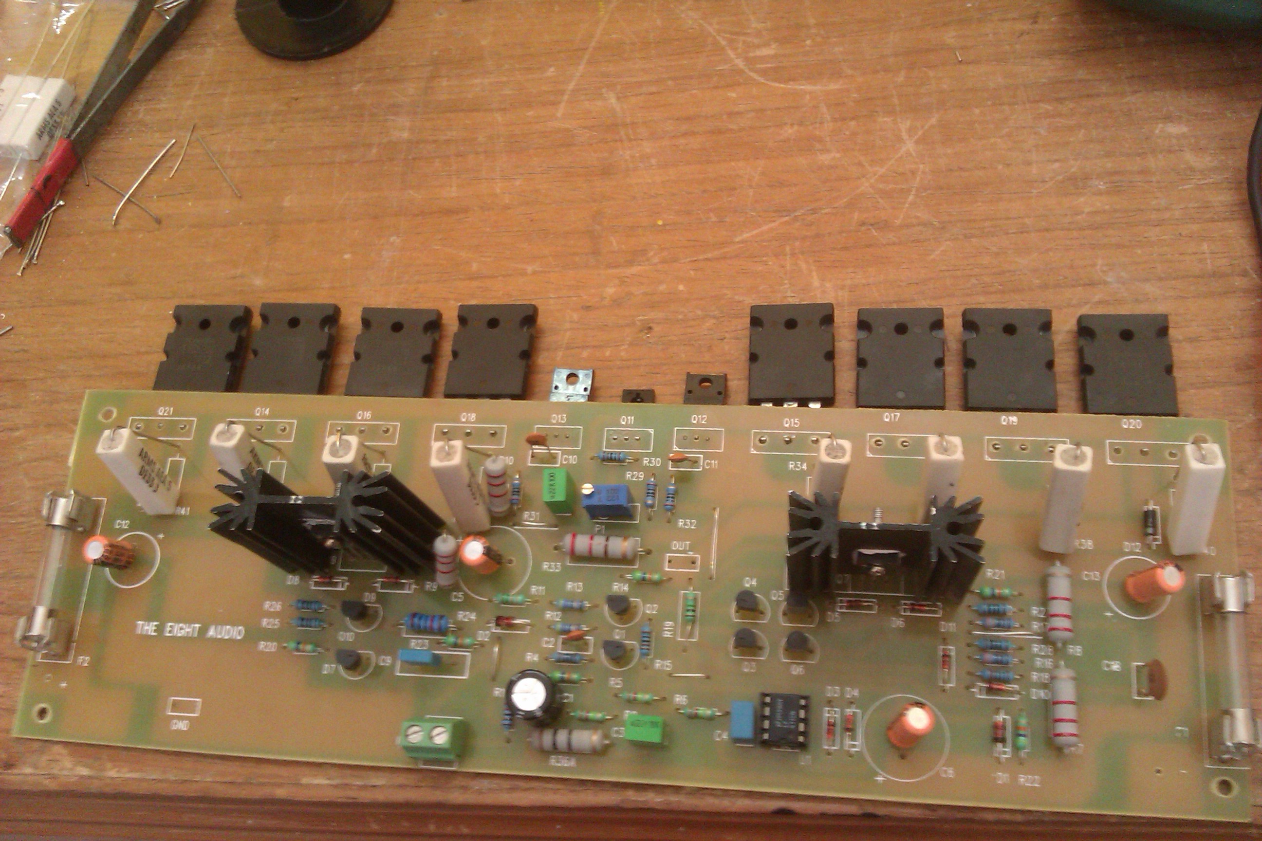

Dear Sir,
Thank you for your reply. let me know what corrections are required to be incorporated in the Driver stage if I use 2x54Vac / +/-75Vdc, 1.5 KVA power supply with load at 4R.

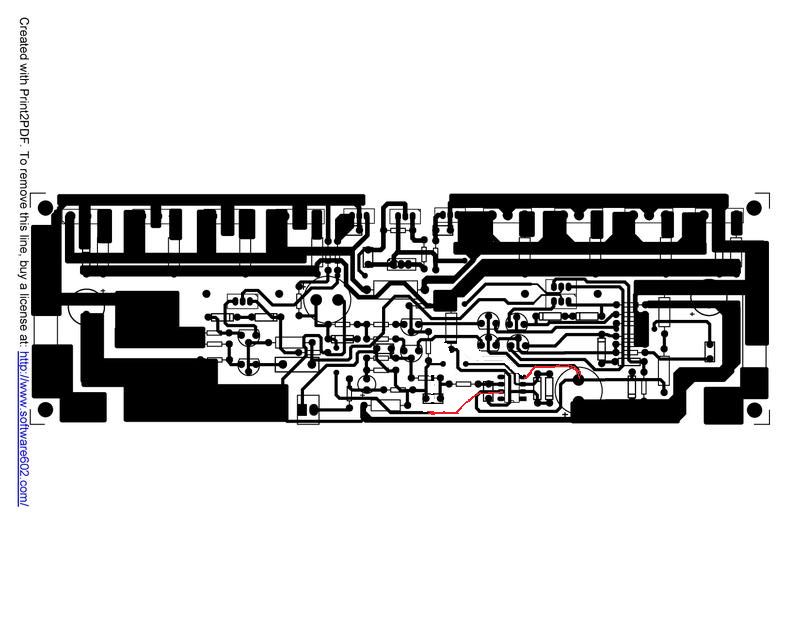

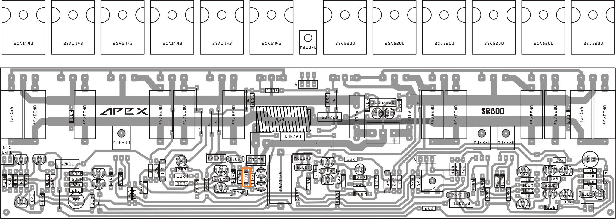

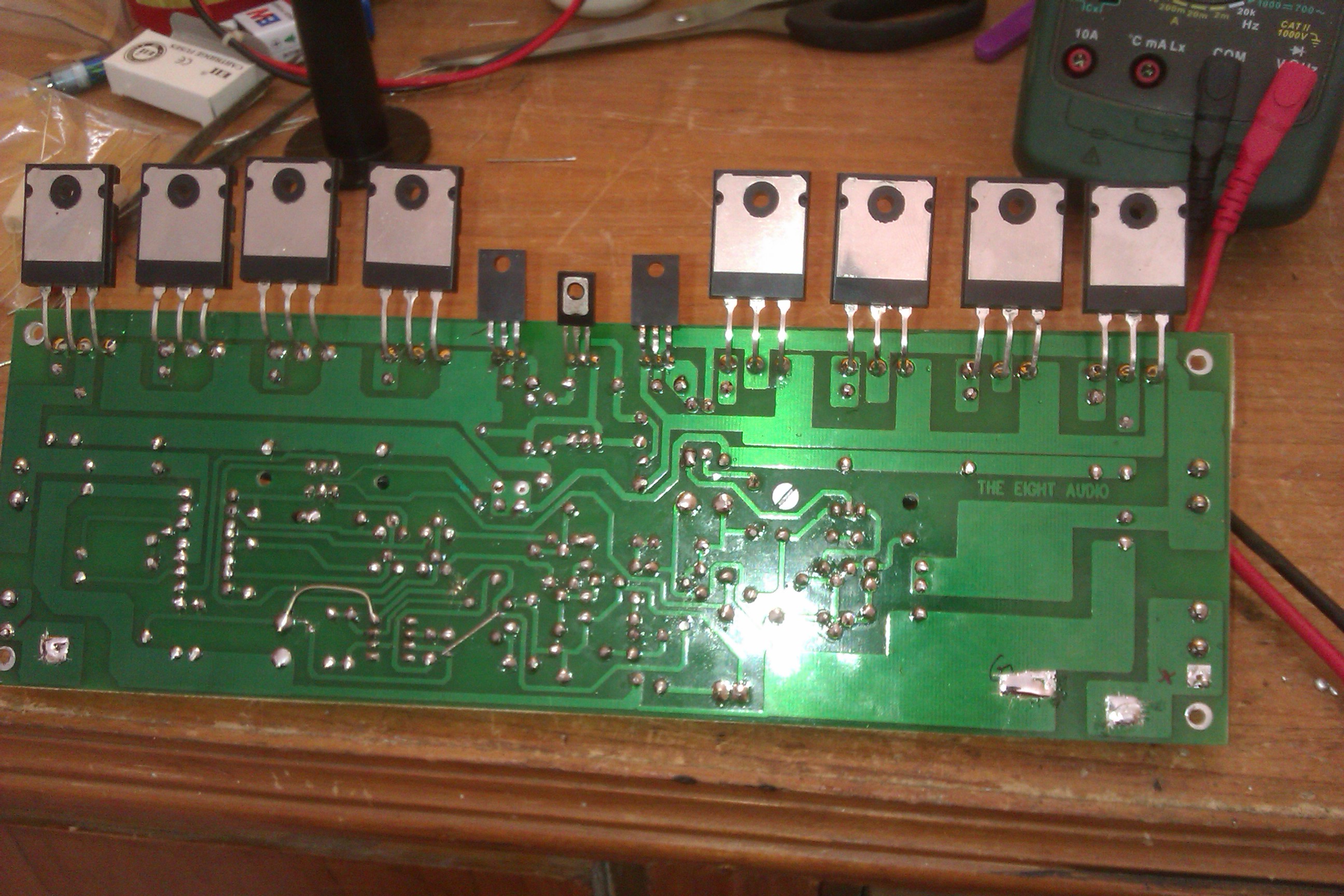

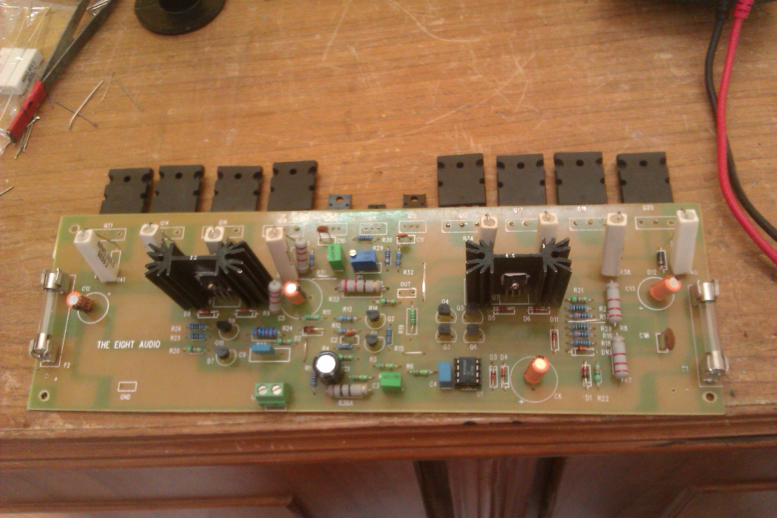

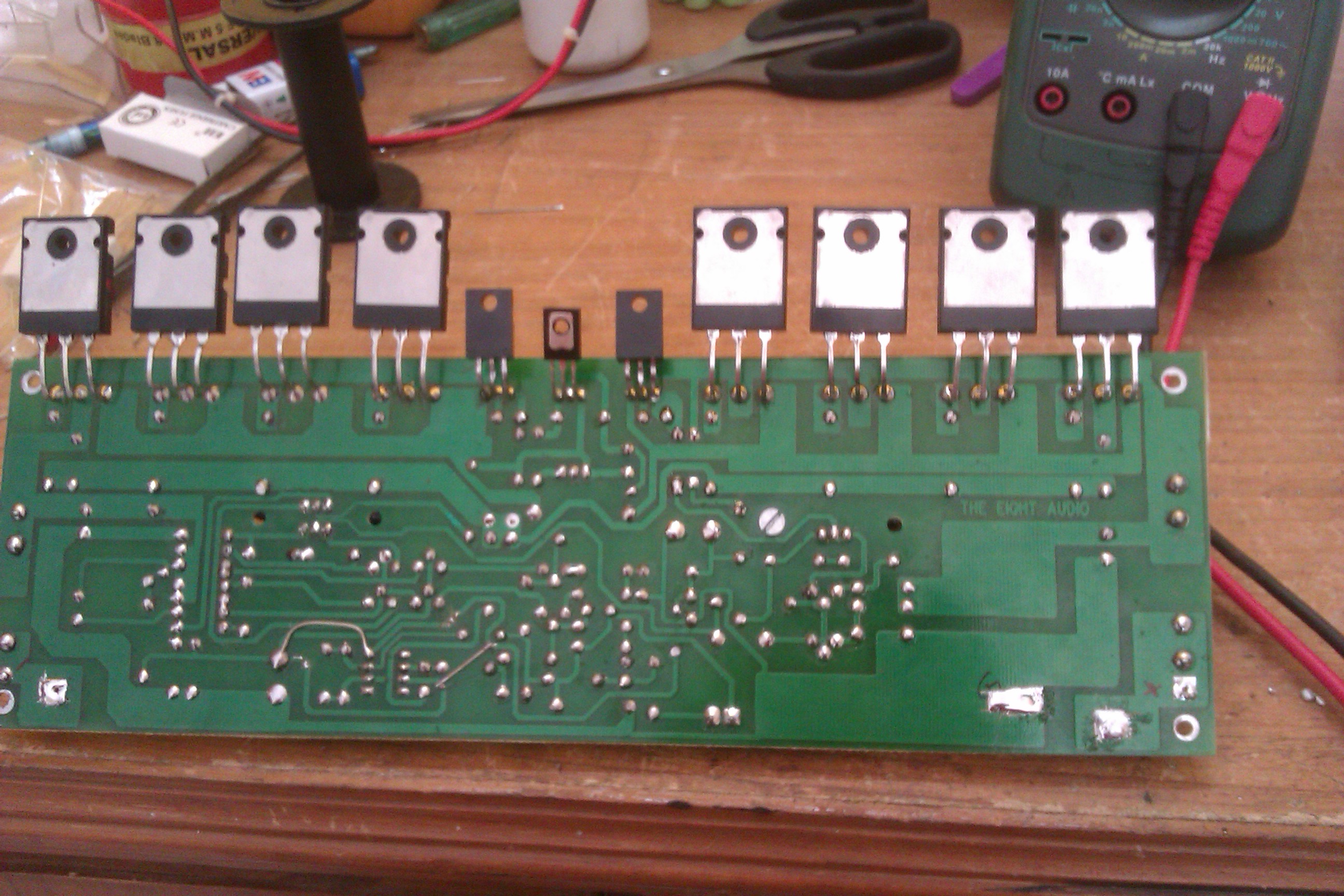

One of the forum member has given me the design of SR 200 and Assembled the PCB for me by using 4 output transistor. Let me know where correction are required. Enclosed below are the PCB with components.
Can you share a link where I can get the the entire project construction pages of SR 200?
Samrat
