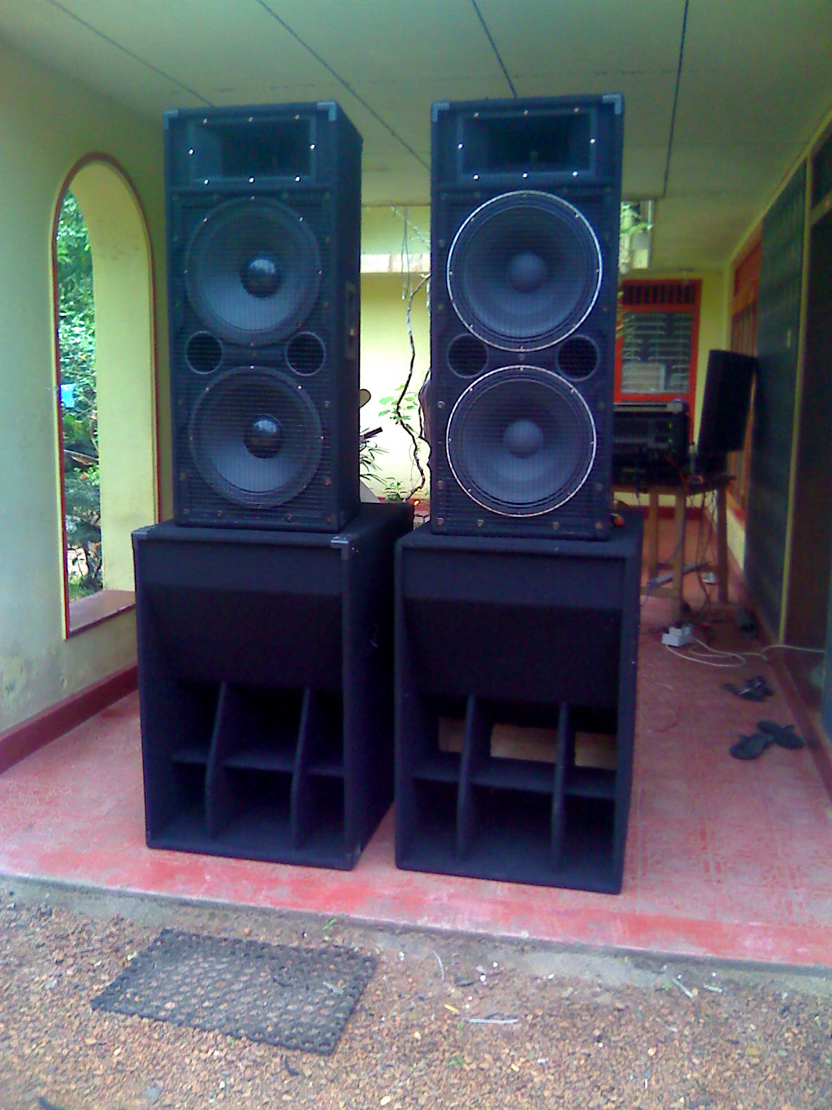

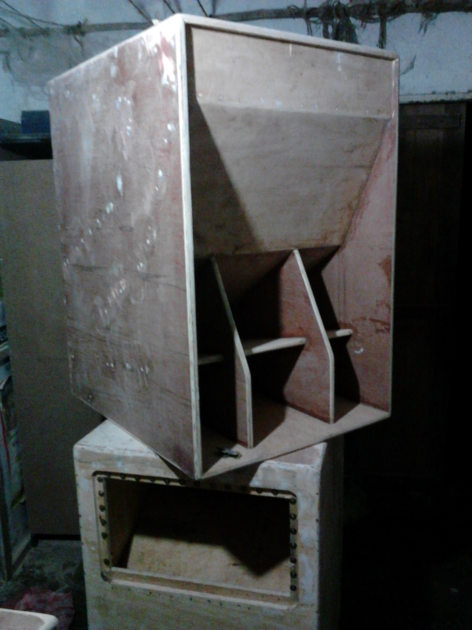

don't mis understand me.i just want to show the speaker i am go in to select for my next stage monitor project.i am new to diy i don't know much, that's way i post speaker pacification file. sir apex or any one who know abut this thing can help me. i all ready made pair of folded horn & bubble top's for my friend we don't have heavy gig. we are in tight budget. i will post some of pic speaker cabinet we made. i did not disaign cabinet drawings. this is just for fun & practice for our boys.

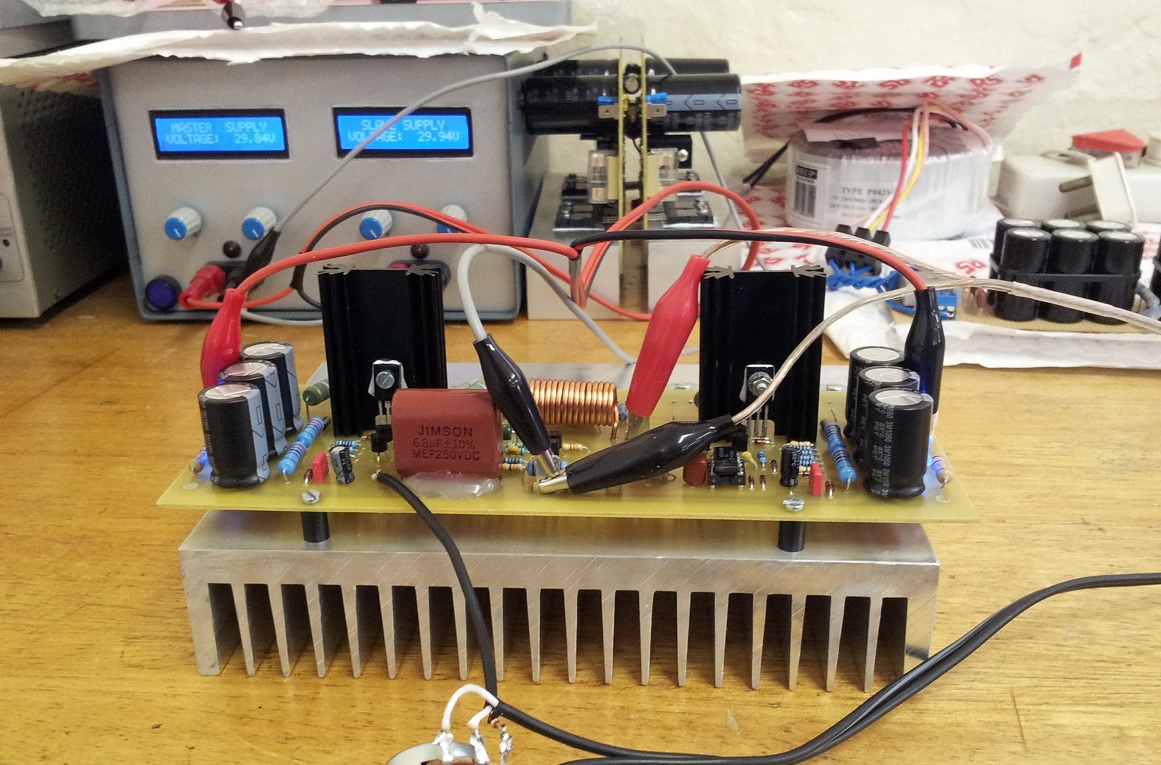

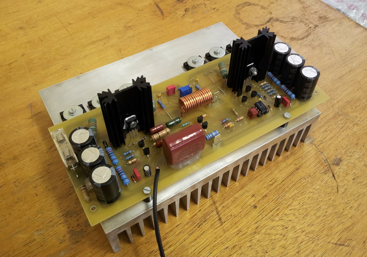

Finally I'm getting some time to spend on my APEX SR200.

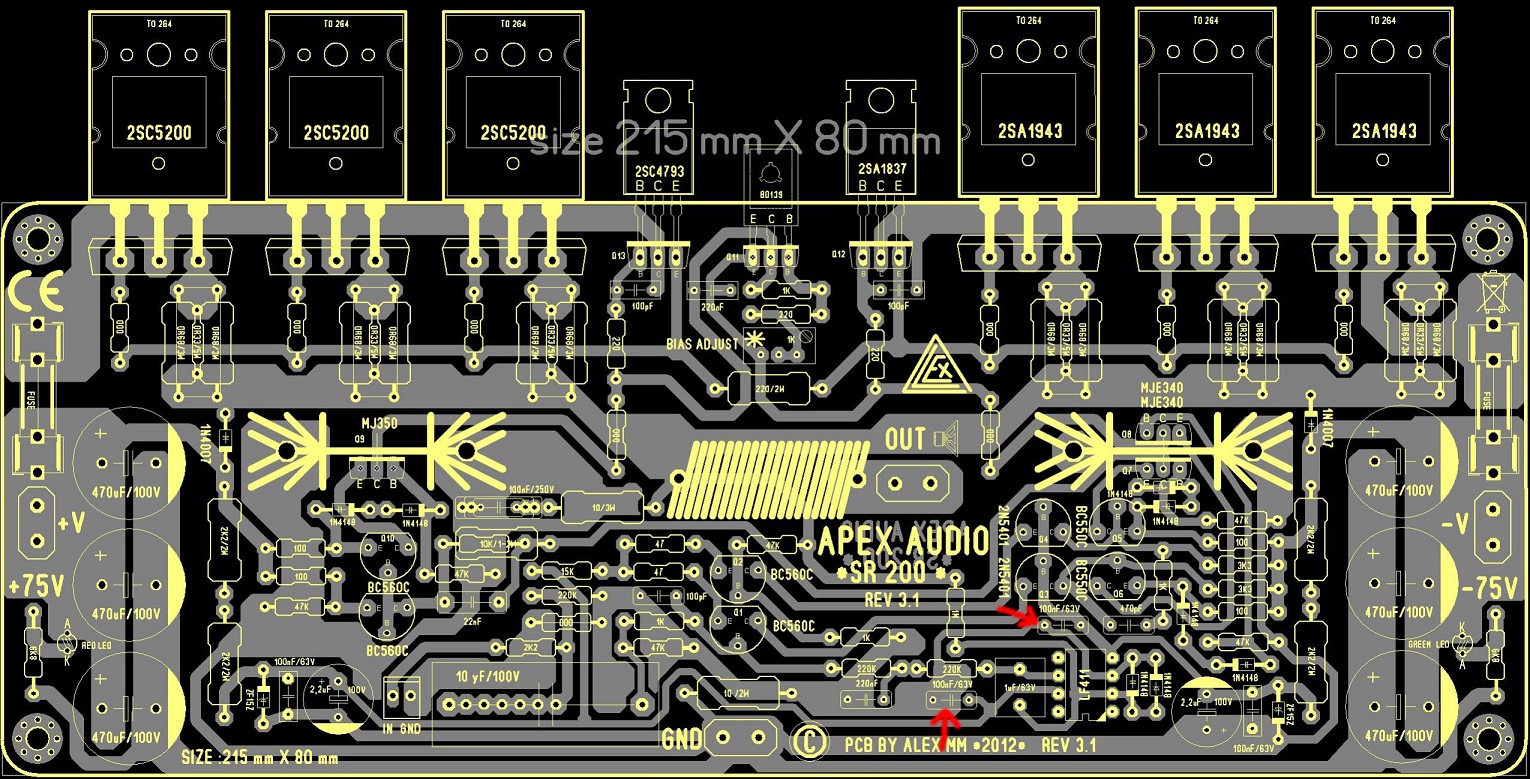

I'm using PCB3.1 from ALEX_MM, I've not populated the two 100nF shown.
I've only had it on my bench supply, first limited to 200mA at 30V-0-30V DC.
Then unlimited (which is 5A per rail for my bench supply).
Worked first time with no hums etc. Offset 0.1mV on bench supply, biased at 10mV over 0.33R's.
When I get some more time I'll connect it to my 45-0-45V AC 500VA transformer and have a listen again.
I don't have any bigger transformer at hand.
Thanks again to Apex and Alex.

First of all, I'd like to know how to rate this thread 6/5 stars.
I've connected up my SR200 to my transformer, set bias at 10mV over 0.33R.
Measured 0.1mV DC offset at output.
Measured 0.00mV AC(rms) on 200mV Digital Multimeter.
NO hiss and no hums etc.
wow wow wow , excellent amp and sounds exceptional, now the best amp I own.
I've designed and built my own Lin type amplifier, and I have to be honest
this amp from Apexaudio, is far far better sounding.
sorry or all the repetitive words, but its that good in my opinion :)
Thanks again to Apex for amplifier design and Alex for pcb design.
