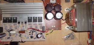

I have 4 pcs. of 28VAC toroidal Trafo 300VA each, can i use those 4 in series to have 55VAC w/ CT to supply stereo of SR200 or B500??
I started builing B500 for sub with most of the component installed and will be followed by SR200 for mid, high. Please advise if those trafo's are usefull for these amps.
I will share some pics as soon as i have all components on.

Yes, you can use 4 identical transformers in series to have 2x55vac for SR200 or B500.

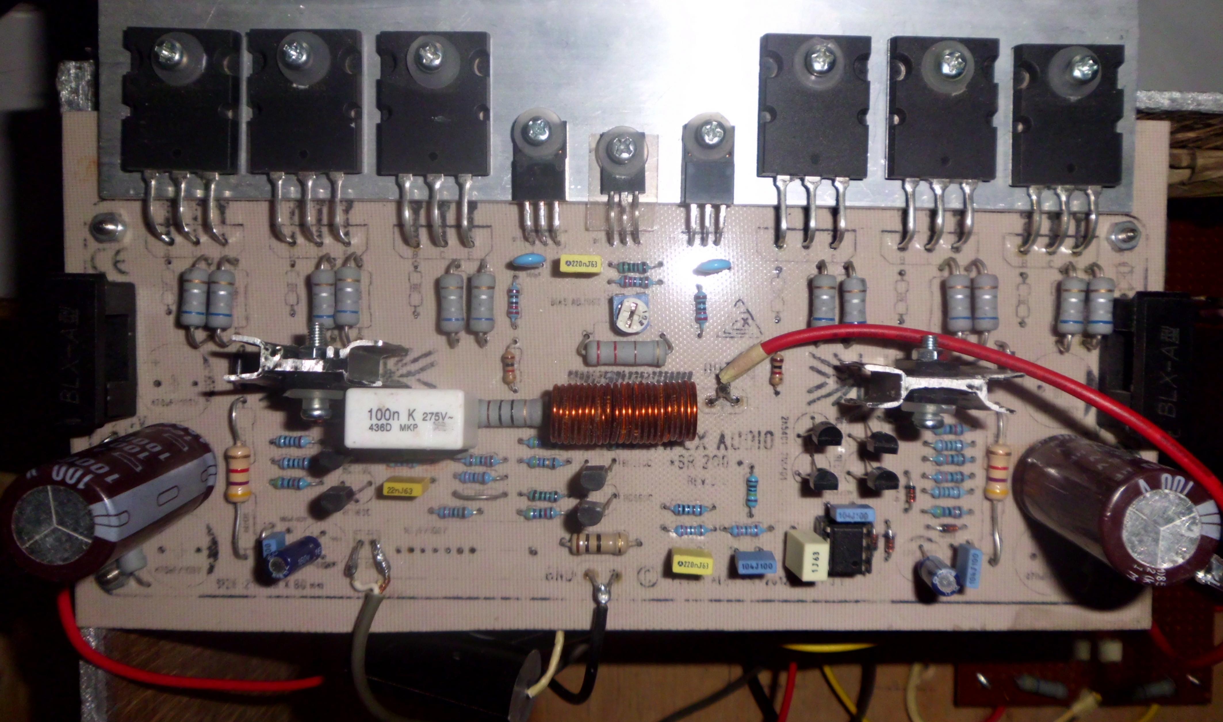

SR200 V3.1 on progress.
