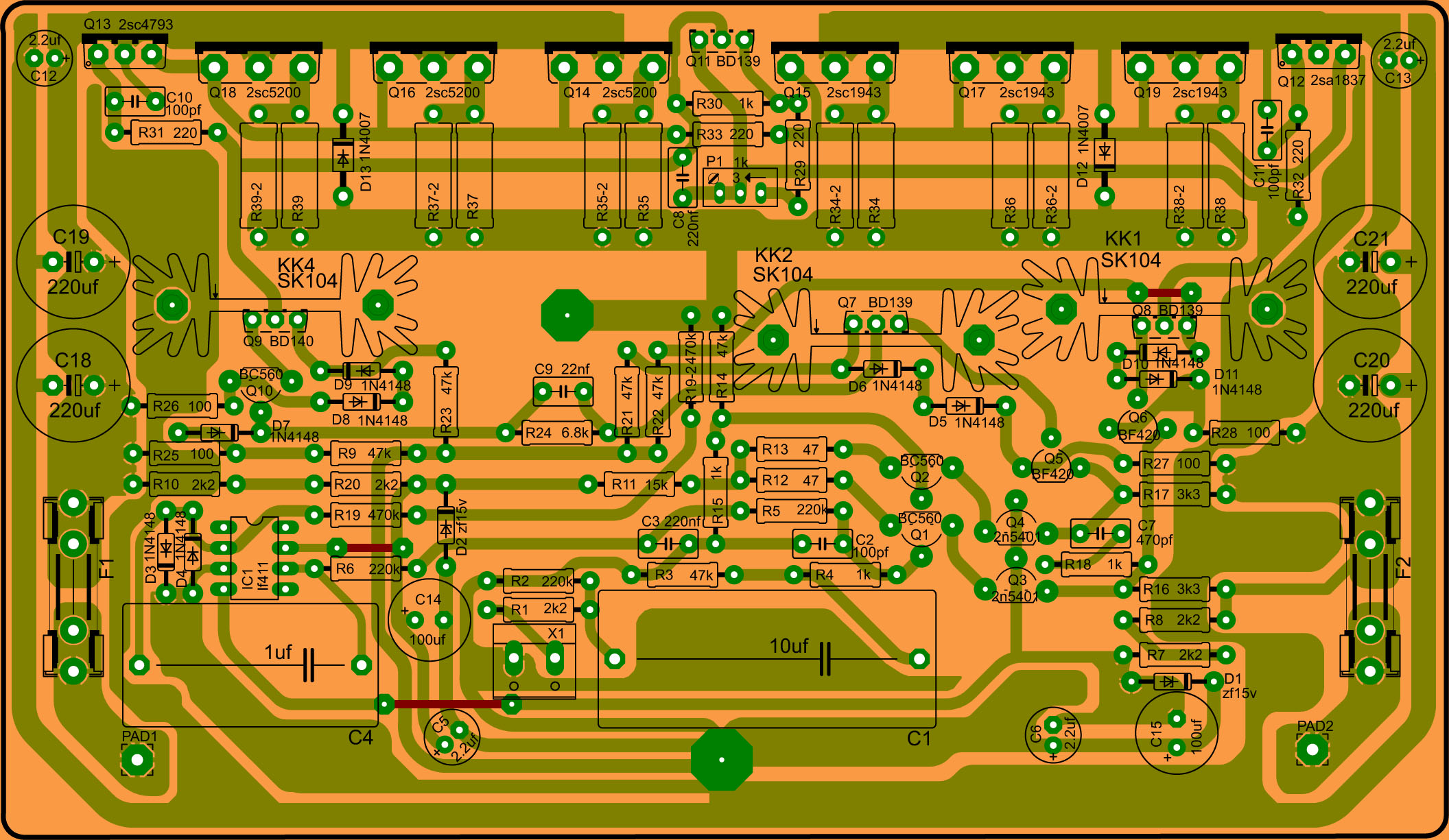

Studio Reference Amplifier
getting addicted....
this is what i do in office...:D

Nice work, but C4 is 1uF/50V :)
Regards
Hi Apex,
For C1, C8, C9, C10, C11 it is also 50V or higher?
if we use max +/-75VDC, what is the minimum allowed(safe) for these caps rating?
I've remove wire jumper in the bottom side.

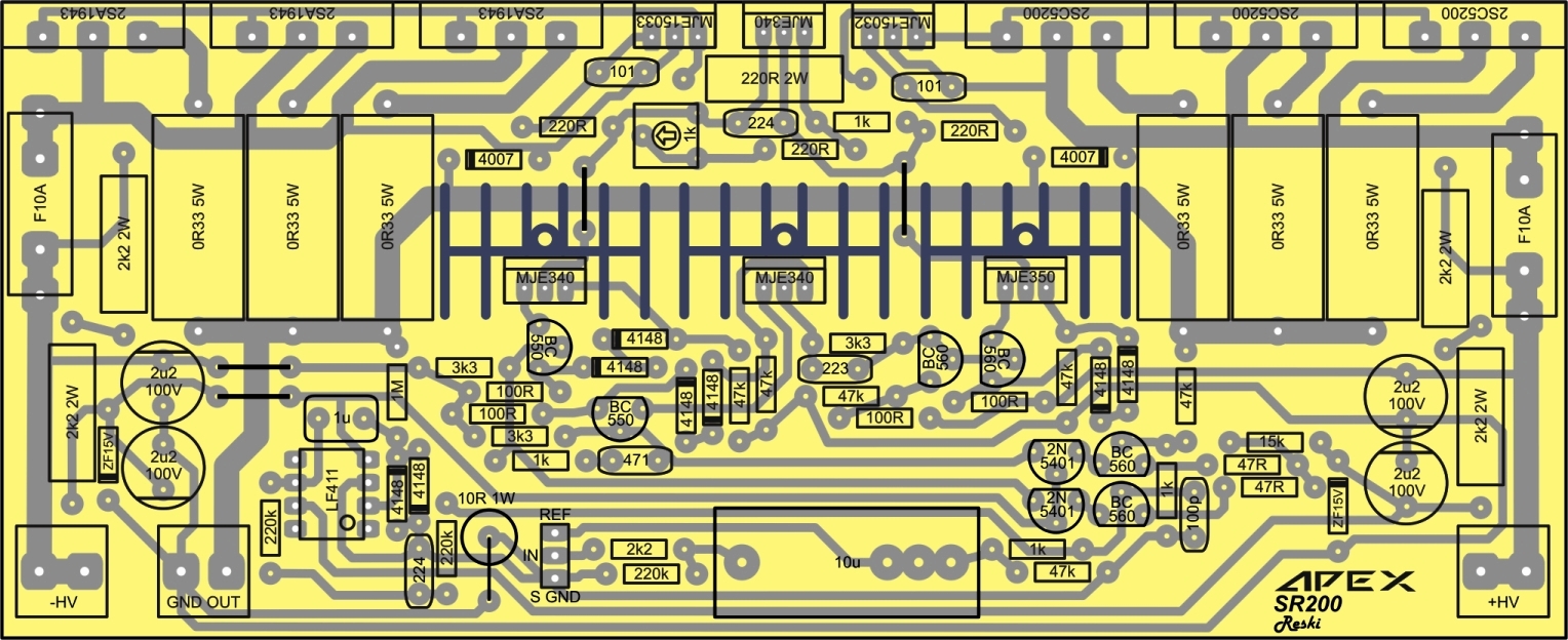

Hi Reski,
well done
PCB size please?

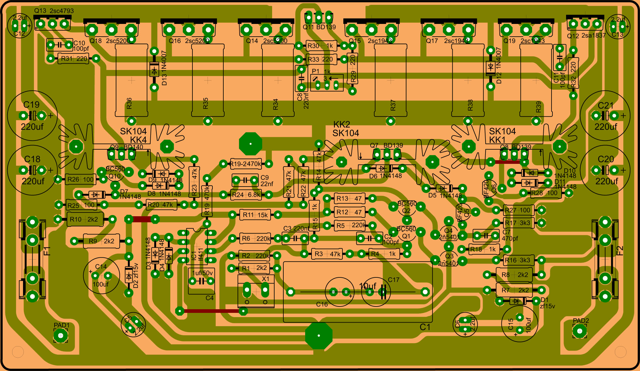

Mine also has been changed(not tested yet), now its look more symmetric :D
Regards
my version of sr200
I have modified the layout for dc servo.I uploaded this to share with, however this board has not been tested so be aware and try to review my work.goodluck and enjoy:)
