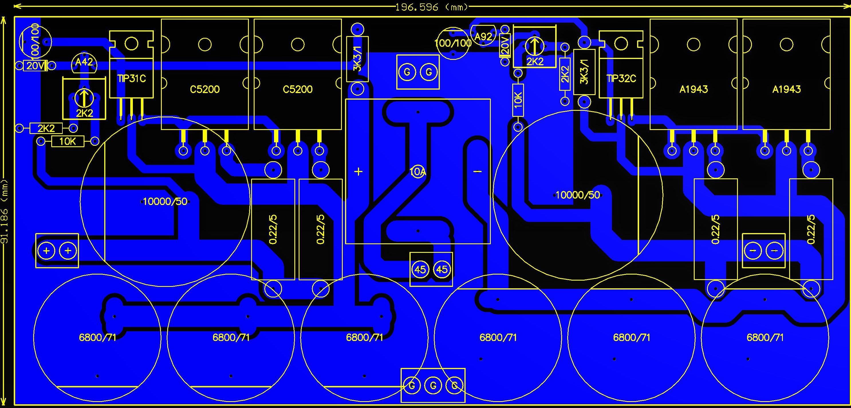

The pcb should be a little bit bigger,i´d say about 20% . I´ve searched forum pages and pages earlier written but i haven´t found this file,could someone suggest me a page/post where it was posted?
And yes,ALEX MM you´re amasing! I have allready saved two pcb/layouts of SR200 designed by you,and if i find it this would be third!
Thank you for all pcb-layouts given to us!

This pcb is in post #154
Regards
Yes yes that is the one! I´ve started with searching from last to first page,that is why i haven´t found it. Thank you so much!

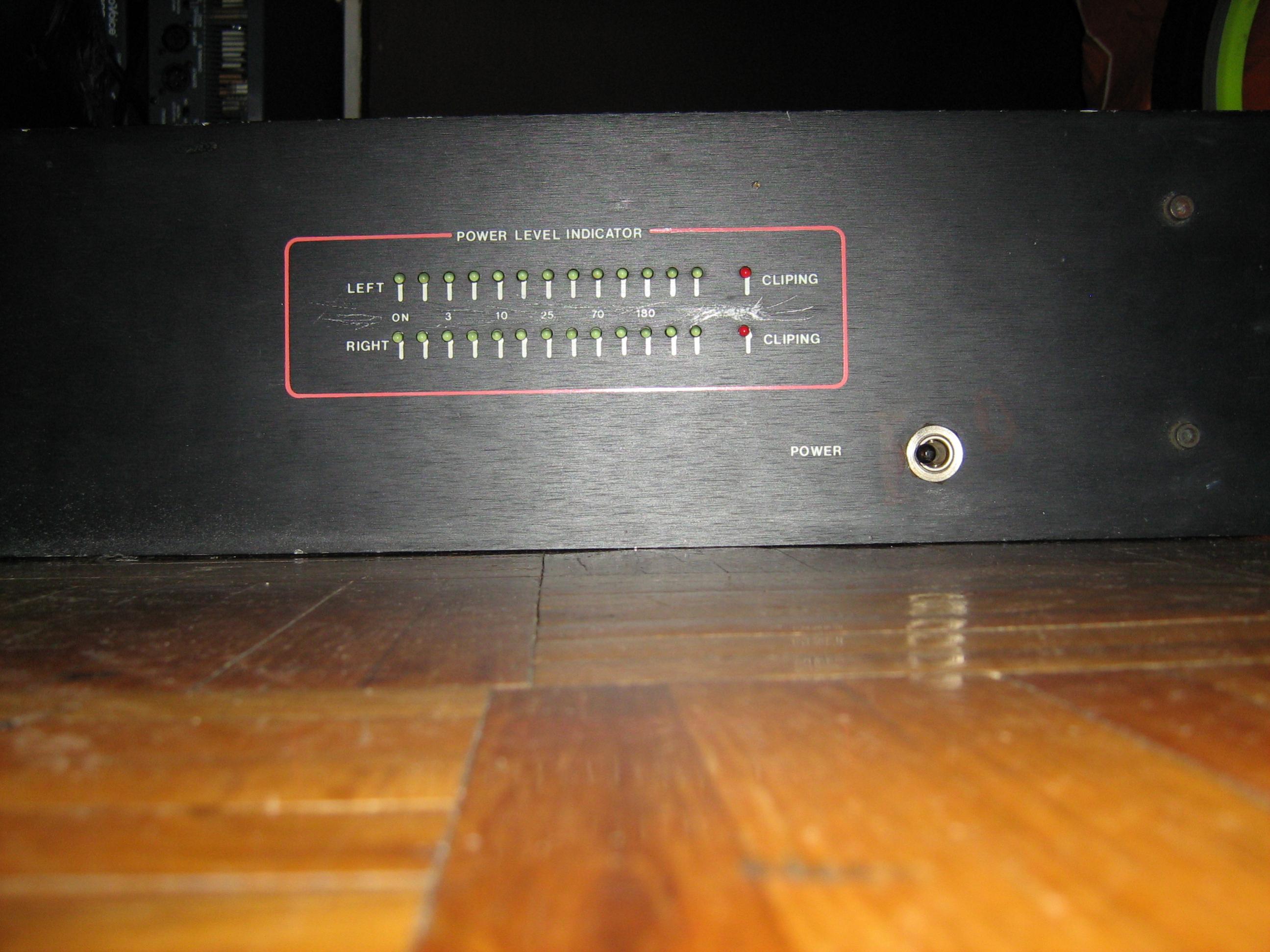

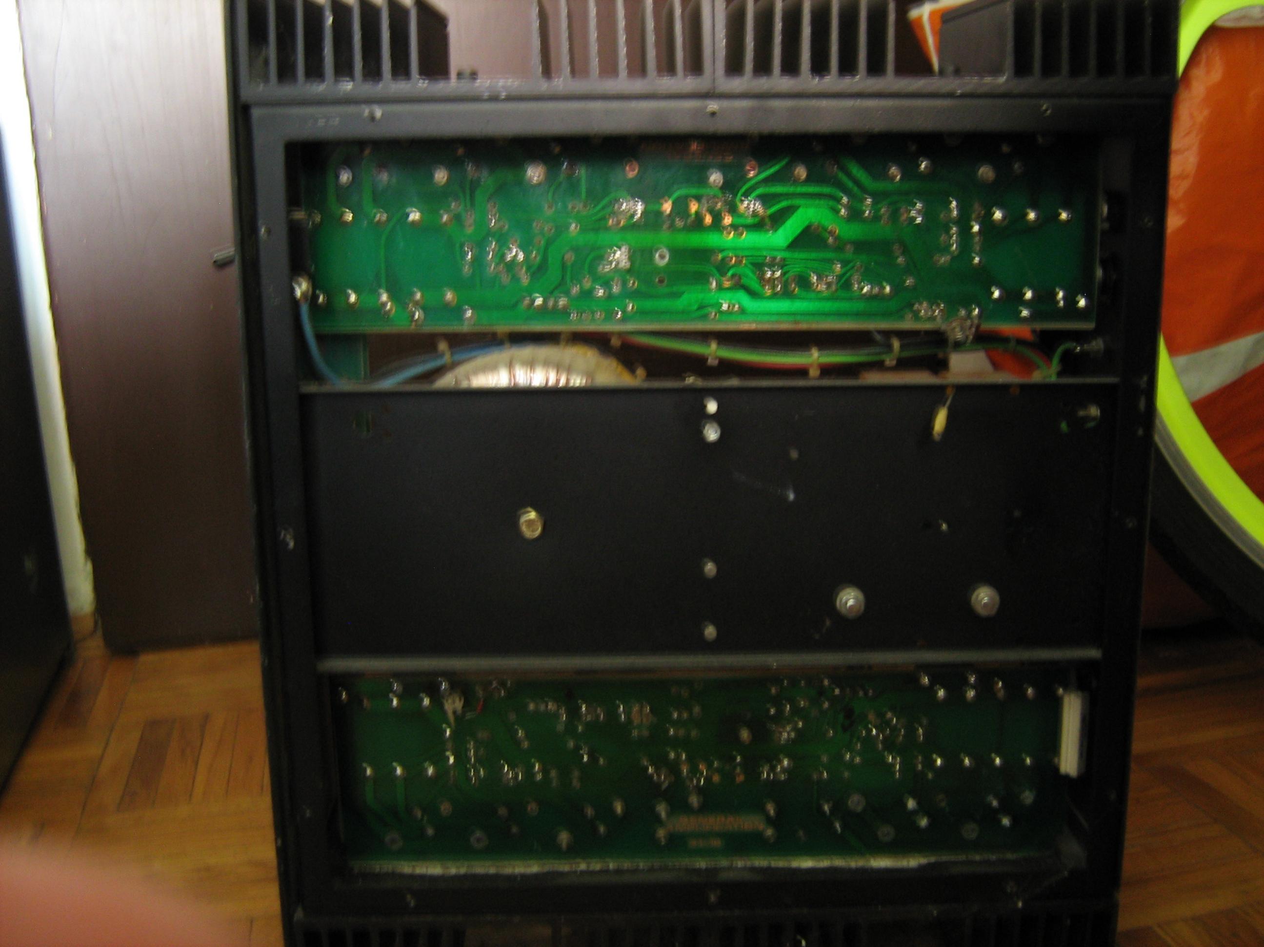

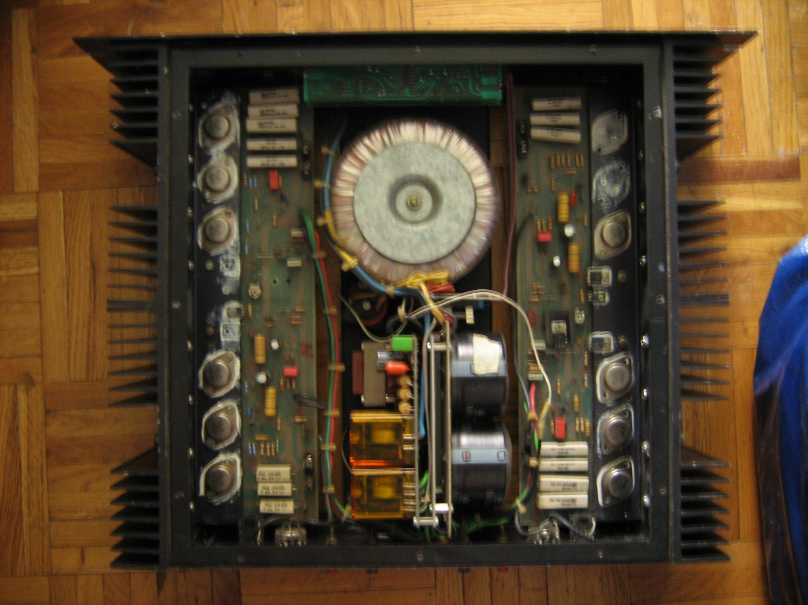

I allready have files for "SR200 V2" and "SR200 V2.3" (both done by alex mm) ,but i haven´t had this one with side mounted outputs. When i begin to do SR200 it will be V2.3 ,and i allready have donor for it,it is some unrepairable amplifier with working 2 x 53VAC 900VA transformer,side mounted heatsinks and good looking fabric metal box with 2 x 14 led power level indicator...more than half parts needed. If i find a picture of it i will post it.

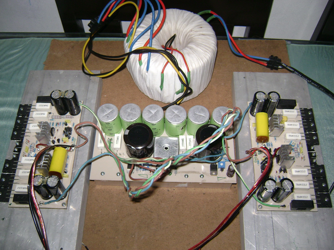

Hello,
OK, I have not paralleled the resistor to inductor, Will do it.
Alex I mounted the transistors, and connected to psu.
Fired up and connected to mobile phone---- No sound.
Mobile disconnected Touch input pin with hand it make lots of noise and 22e resistor on psu gets extremely hot.
Checked all the connections.
Checked for shorts- No shorts.
Checked transistors for short to heat Sink- No short.
Disconnected speaker gnd from psu gnd- Psu resistor does not get hot, Connect again gets hot.
what Could be the problem.
And how do I Measure and adjust the Bias, Please Show exact procedure, I have never done it before.
