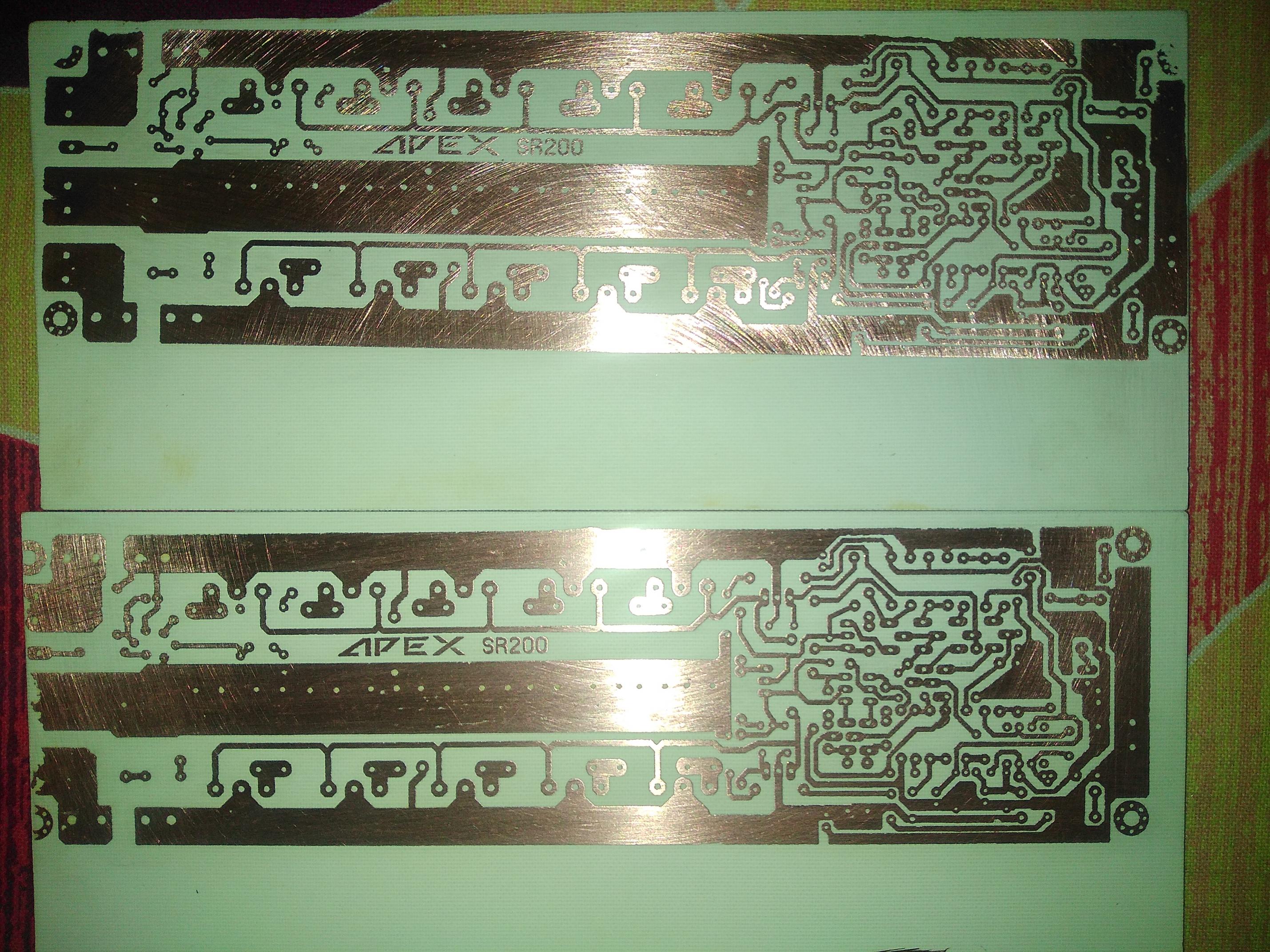

That's ok - my idea was to see what you mean by "popped capacitor" looking at its photo. Please give more information when you describe the problem.
There are only two reasons for the capacitor to pop - overvoltage and wrong polarity. Which one took place in your case?
Lack of bass is very subjective. Pretty easy to diagnose making a few measurements with the signal generator in place. Otherwise, we can only guess. In case the PSU provides the steady rails, powerful enough, the only part limiting the bass is the input filter C1, R3. What type of capacitor do you use for C1?

How we can help without measurements and clear pictures?Greetings guys .My main problem is my sr200 is not go louder.i have 12 "woofer 8 ohm . 135mm magnet..Can any 1 tell me how to solved this .I am using ttc5200.or tta1943 is that problem.or small transistor problem
What you are using as input signal?
Is the level enough for full output?
Look at the resistors value carefully!

Sir I updated pictures many time.bias is22.i am using computer source for input. .Is just playing .I amusing 45 0 45 Ac transformer.dc off is 2 millivolts

i cannot see any pictures and measurements of your work being uploaded. a simple good resolution picture will let others look at your work in terms of resistor VALUES, POLARITY of diodes, capacitors etc....

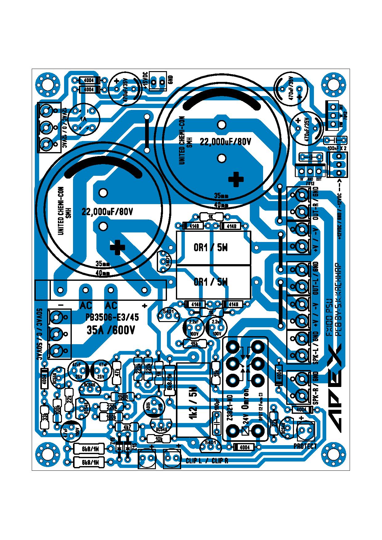

Studio Reference Amplifier

Have you measured your voltages and written them on the schematic? It's the only way anyone can help.
