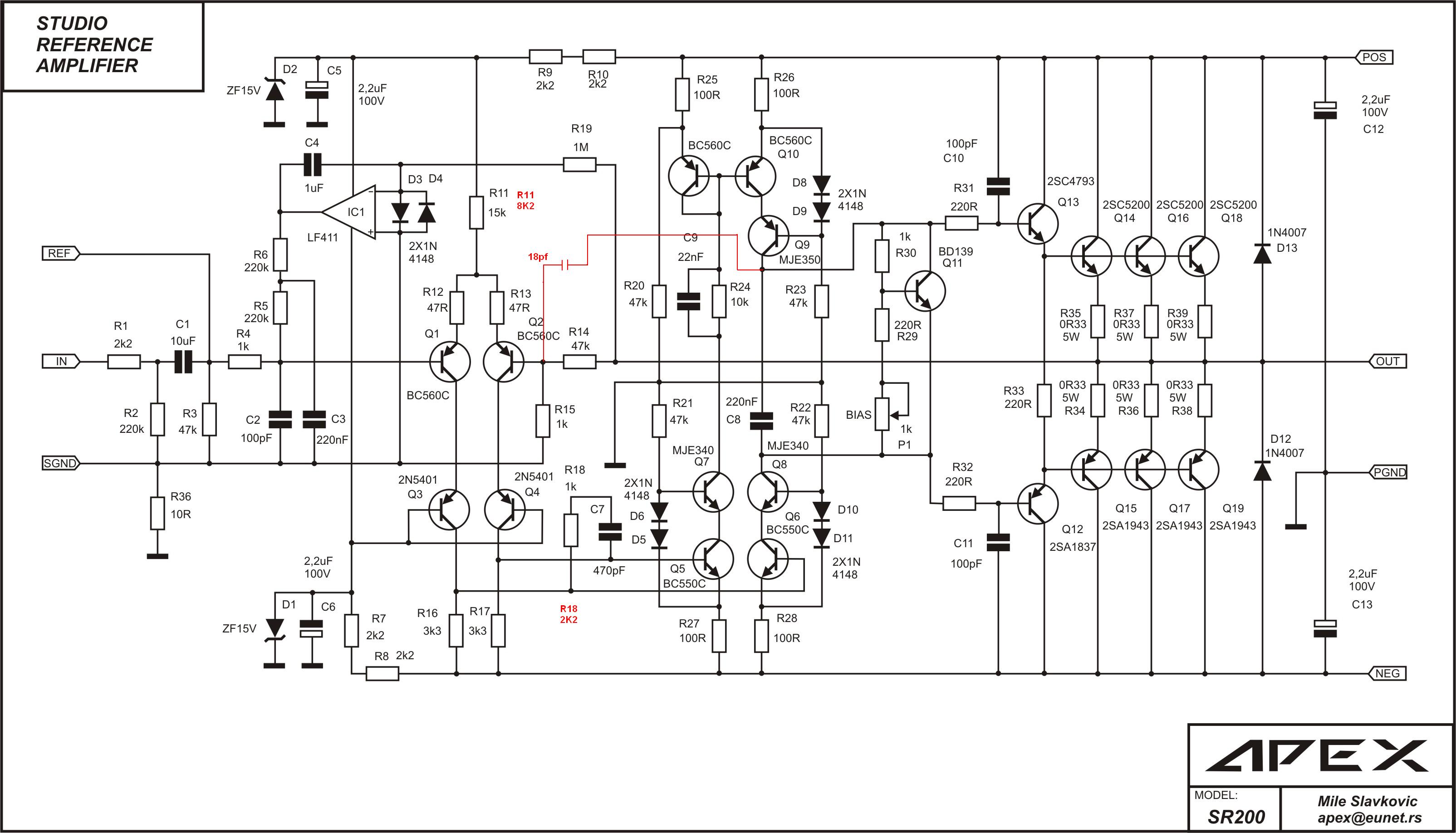

Studio Reference Amplifier

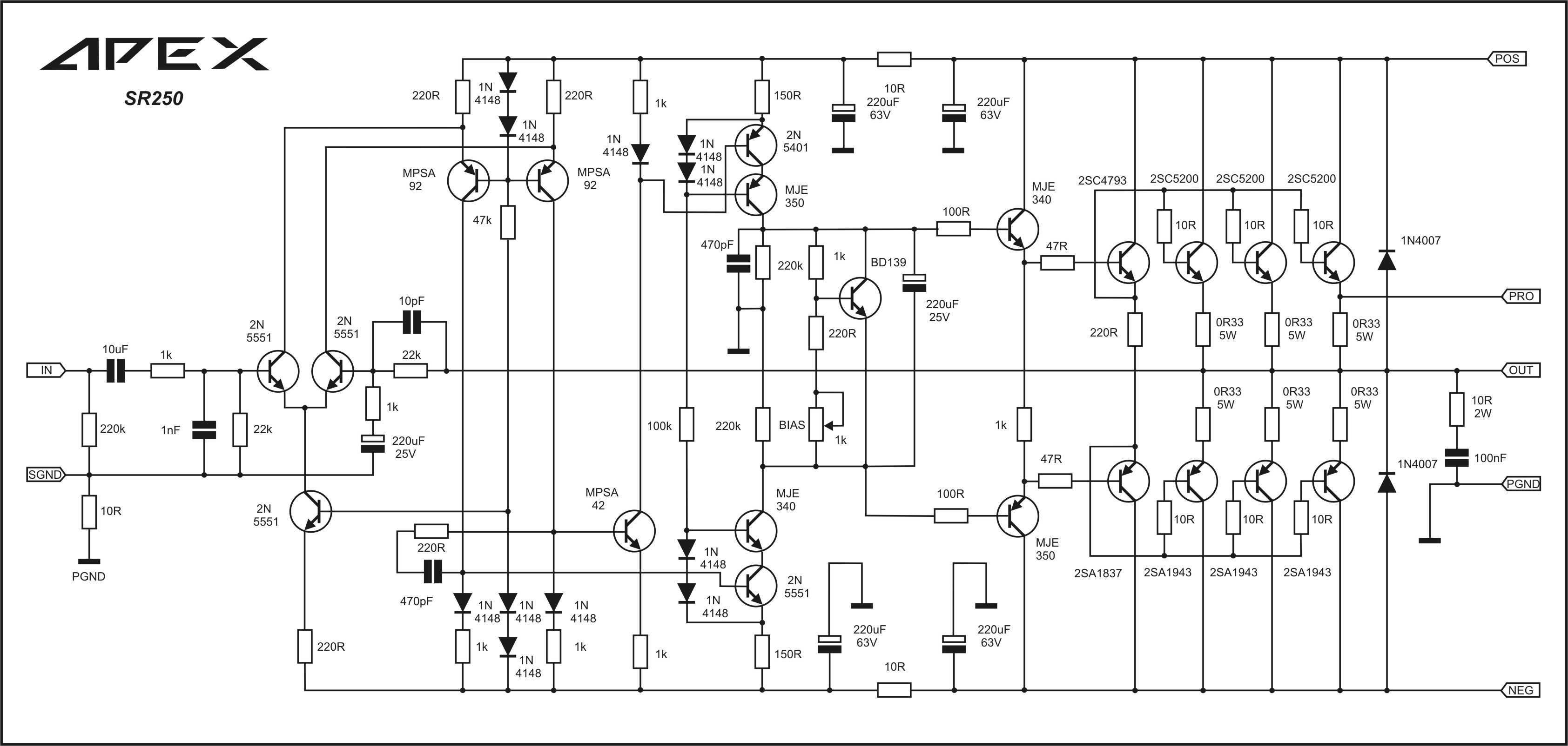

My contribtion for Apex SR250 with Pro detection, On, Signal and Clip.

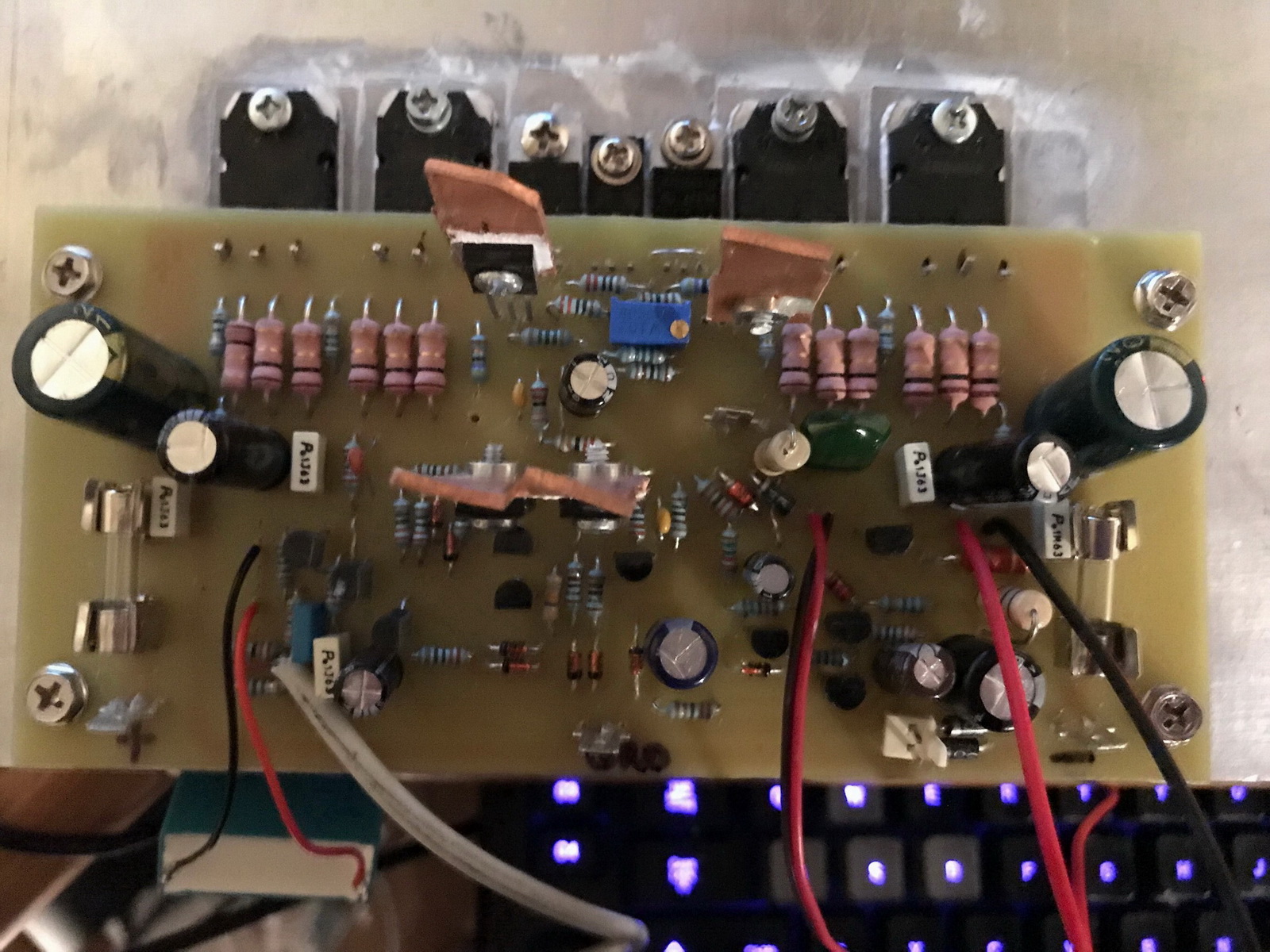

SR200
Good Day Kandimba,
Hope all is well... can I use your SR200 and SR250 layout's with Apex PA protect circuit?
I've attached pics of my protect build for my B500 amp that I'm busy building. This week I will make soft start and PSU PCB's.
Thanks in advance,
macd:):):)

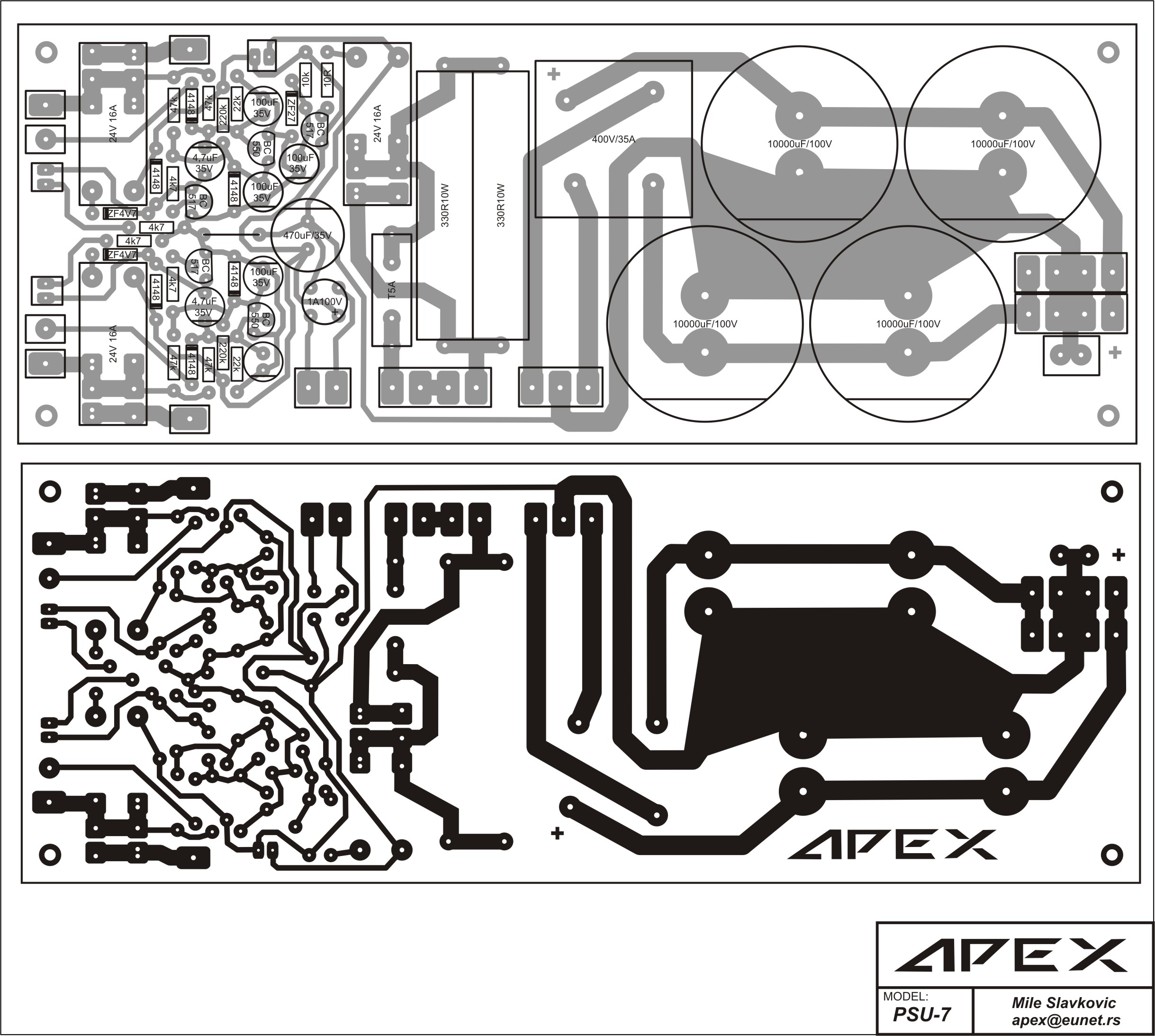

Hi Macd! No !! For SR200 and SR250 you only can use the protection 7.

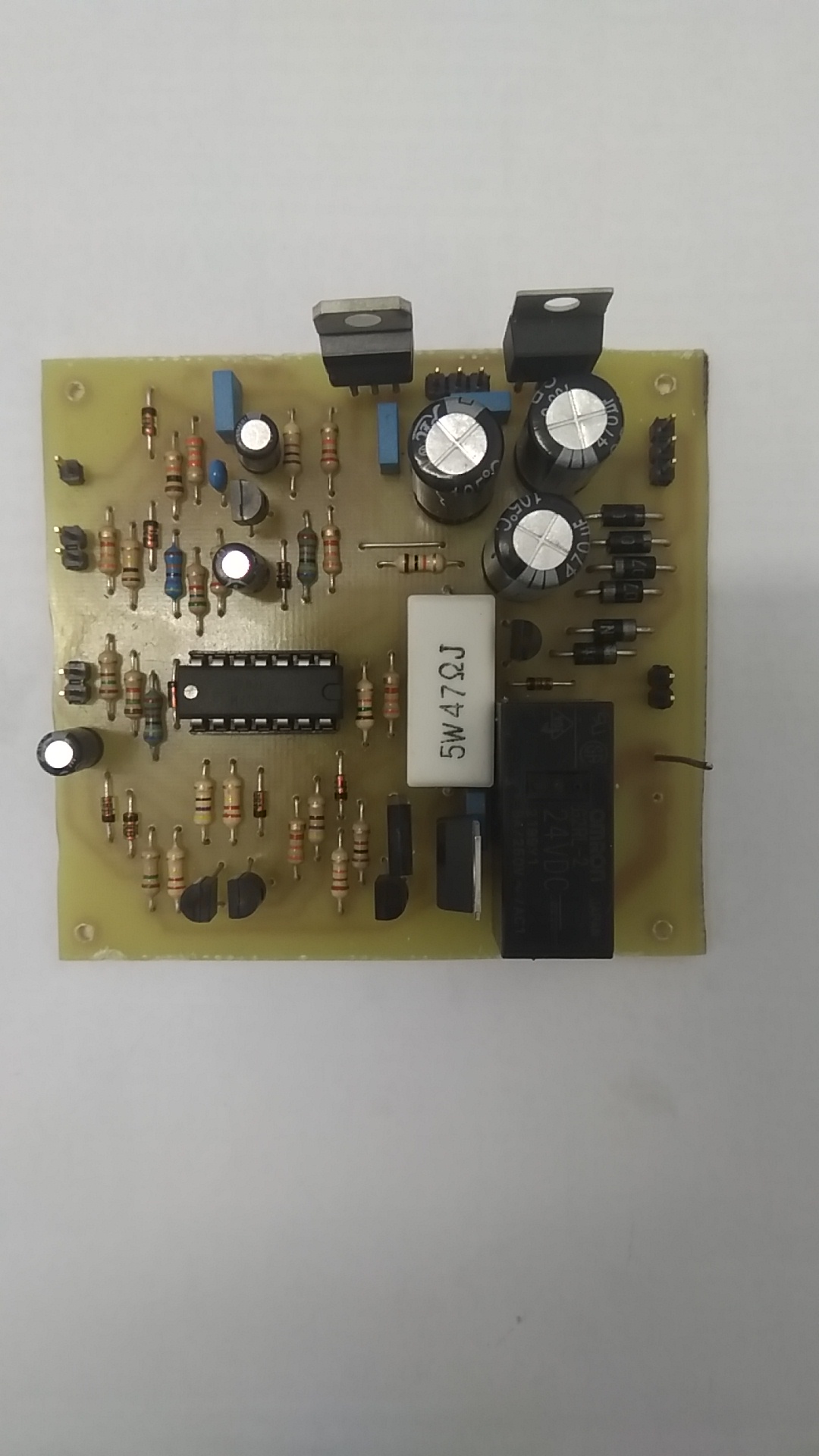

SR150
Hi folks, I have completed the SR150 build and I'm in the midst of testing it. So far the sound is very detailed, but I find the highs are a little too bright, almost harsh. I'm pretty new at this so any pointers are appreciated. :)
I've attached a pic and the files I used.
R
