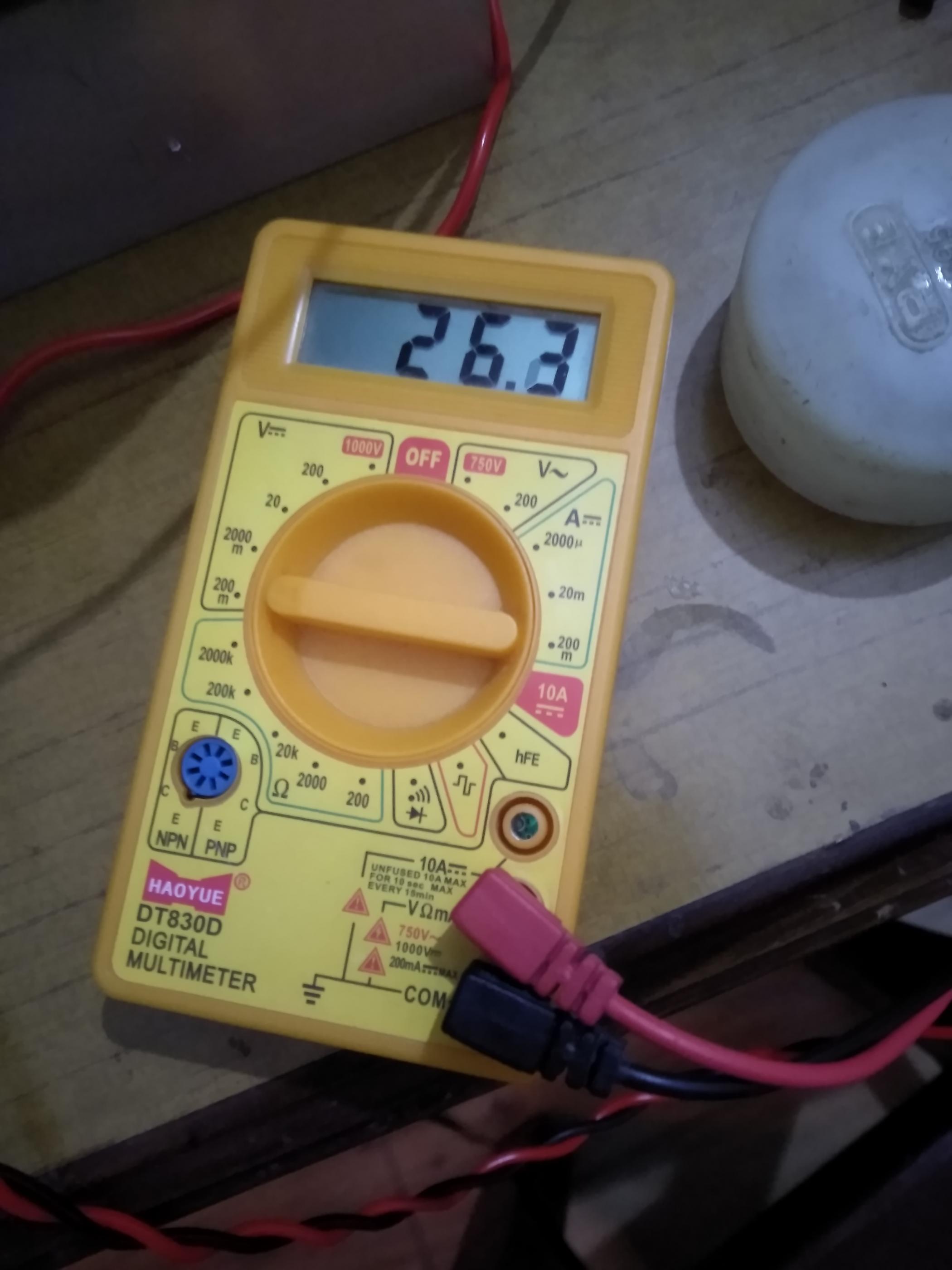

voltage of your PSU is OK,you did not say what power of transformer is?

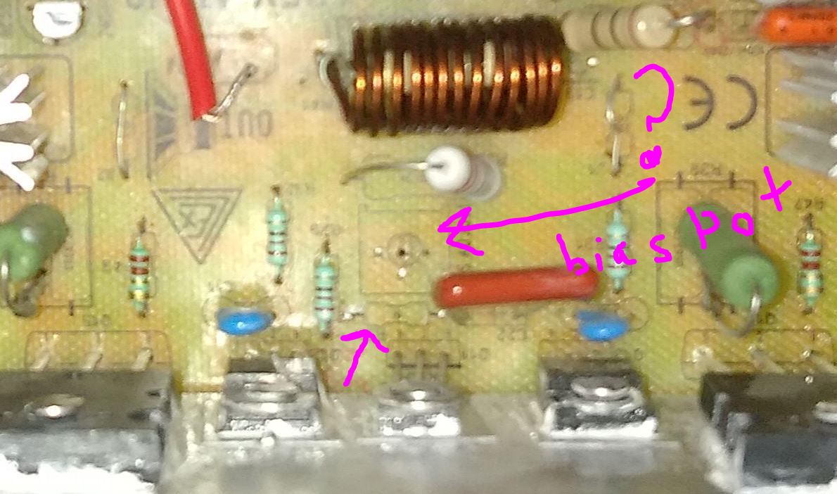

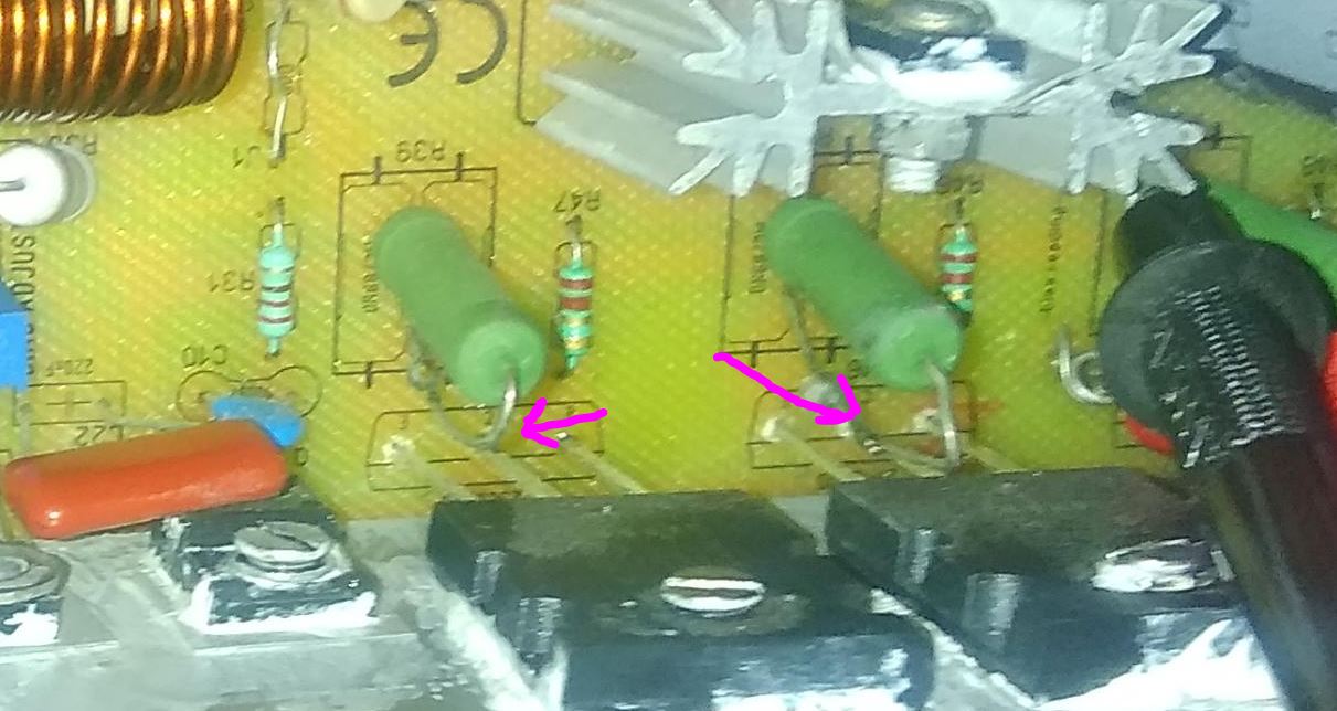

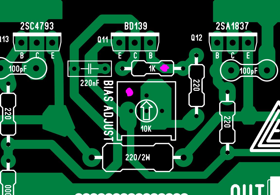

Mr. Sunny how did you make it work without bias pot "trimpot" and a missing resistor?

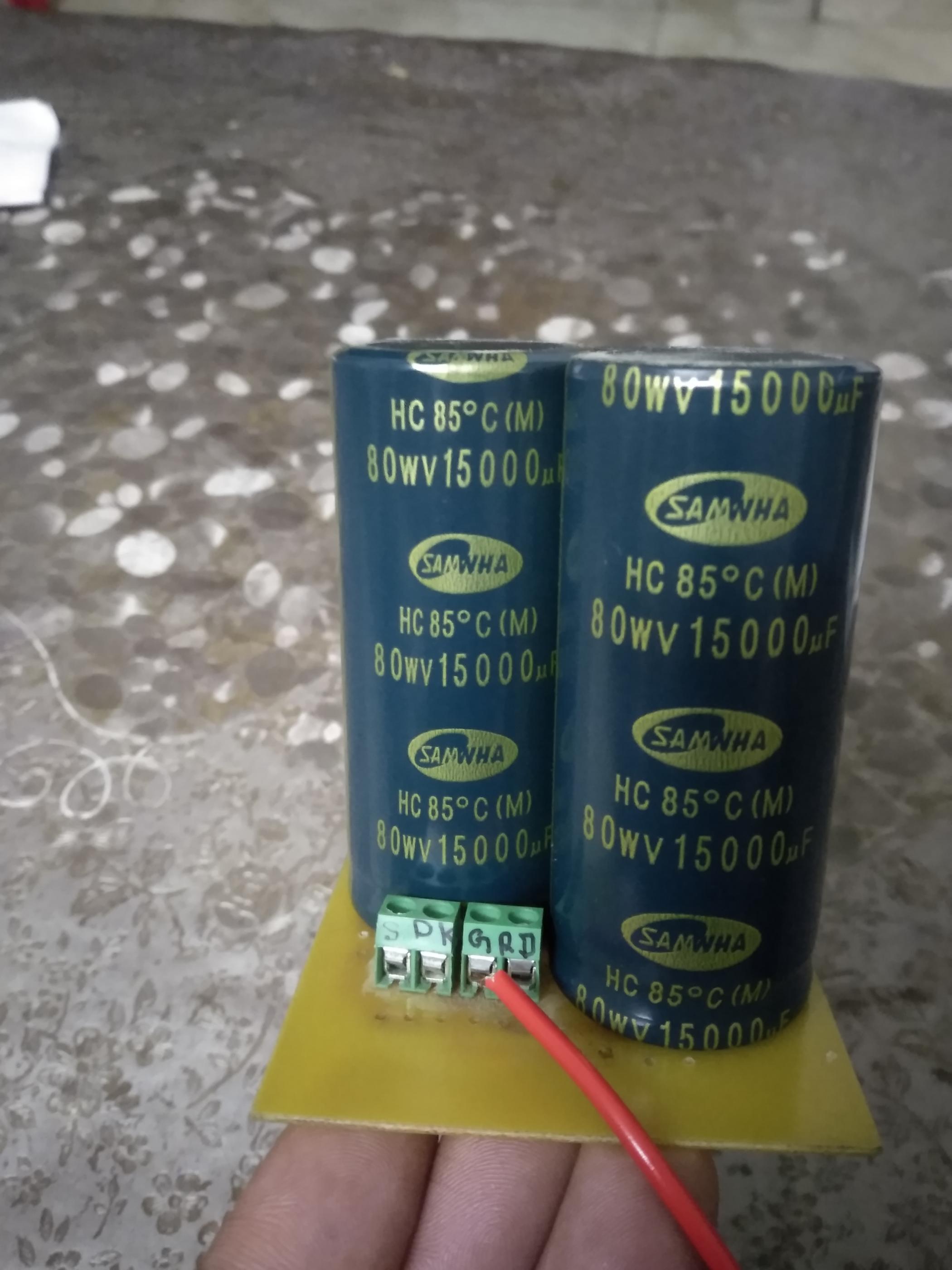

Here two problems in my work

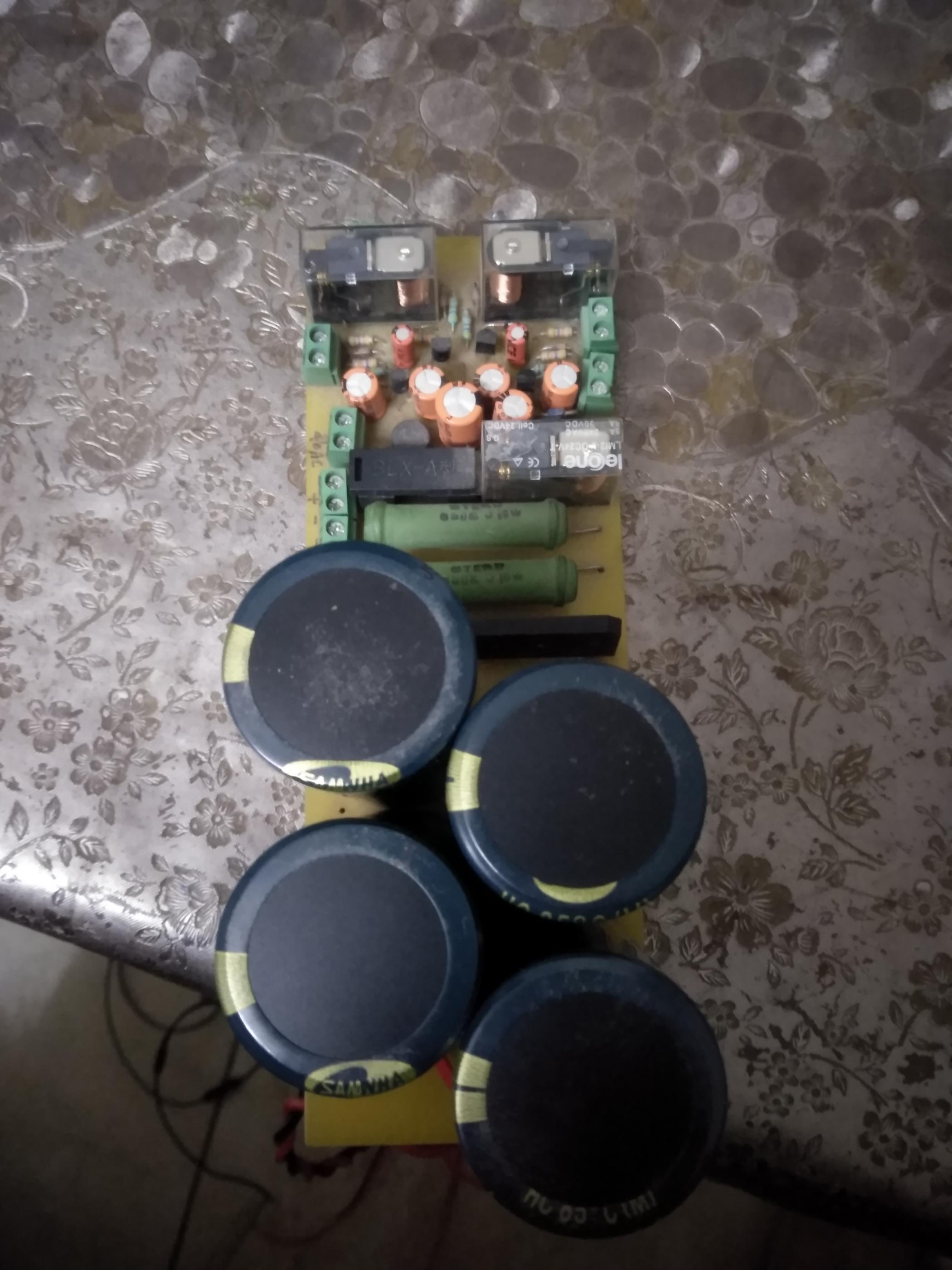

1, Sir u right my psu capacitor bad some time they produce hum or little sound. Now I change them with 15000uf/80v best brands.
2, As I say in last post I m rookies, I use wrong resistances because value on resistance r blur. Likely A Diy member
(Who come in my city for business reason) he contact me and check the board then we noticed we use wrong resistance. I replaced all these resistance, now amplifier working superb. I feel very sorry with my little mistake we disturb u so many times. But with ur experience amplifier working fine.
3, one more thing we just play the amp with 100w series load in main supply, any suggestions before removing that load. Sorry for my mistake and Big thanks you and Mr Miles depth from my Heart.
Regards
Sunny
Mr. Sunny next time always check values of each individual resistor even if you know the color code well it does not hurt to measure it before is place on the PCB and solder a 10 ohm and a 100 ohm in a quick glance look the same if you are into too much hurry do things like art take your time a master piece takes time :)
