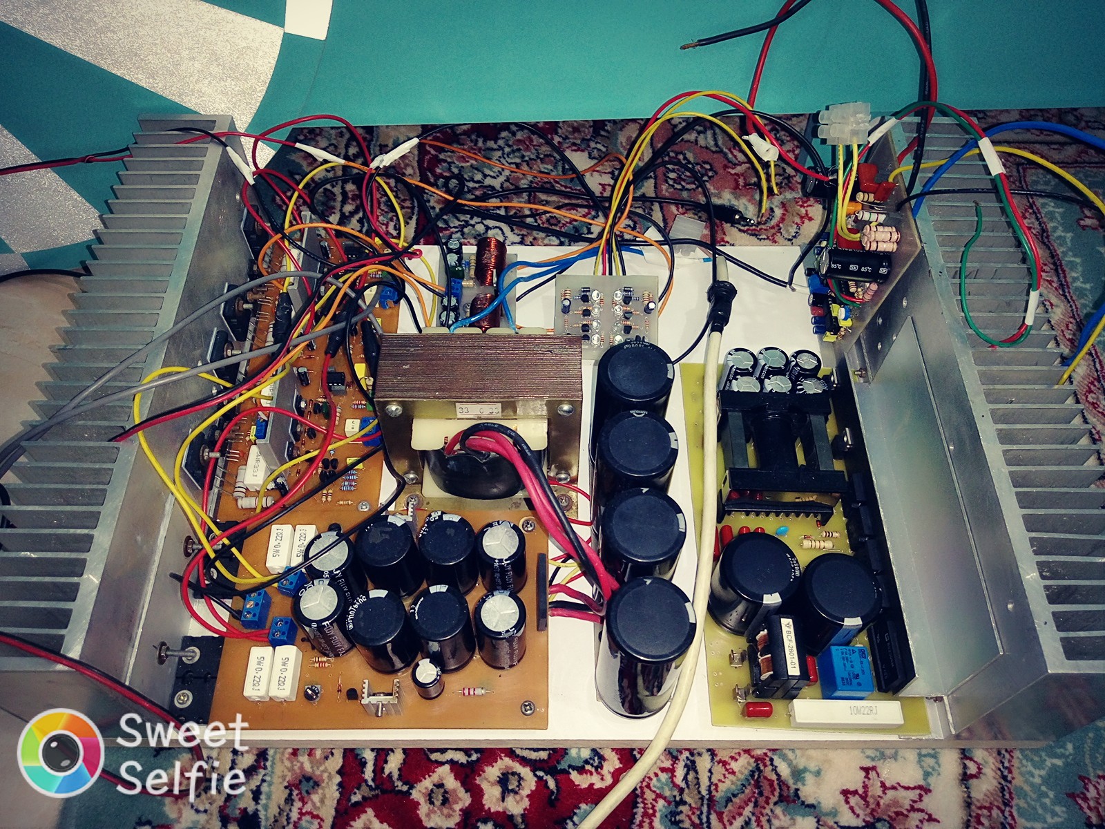

i built a 2.1ch system for my com A few months ago:
2*sr100 amplis
psu-10
zobel network
+33/-33 2a traffo
1.2 kva detex smps(Under Construction)
1500w class d ampli from detex(for subwoofer)
and apex vu meter
the sound quality is very good and detailed
i have a problem
when signal source is connected and audio volume is 30% and upper sound is good and not problem but when audio volume is 0% my traffo gets hot after one hour!
why?

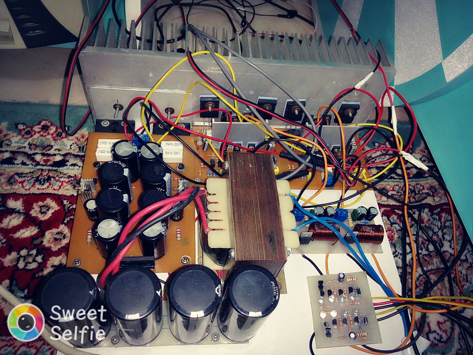

Hi behrad. Your pics show a lot of loose, unshielded or untwisted wiring and I suggest that you may have some instability or oscillation when the volume pot. is set low or at zero volume. Oscillation can and will cause the power amplifier to overheat, even though the speakers cannot respond to the output, which may be in the region of 300kHz - several Mhz. The proper way to identify such problems is with an oscilloscope but assuming you don't have or have access to one, you will have to work by trial and temperature - even though the result may still be uncertain.
First though, experiment with grounding (shorting) the input to the offending power amplifier, which should stop any problem with the effect of the volume control, wherever that is located in the overall scheme. Then if that proves effective, it is a matter of reducing the length of all the wiring to make a tidy arrangement where signal and power leads do not radiate signals and noise between them and other sensitive circuits. Take the time to tightly twist the +/- or feed and return pairs of power supplies, output and input signal leads to ensure the cancellation of excess noise and signal that they radiate and receive.

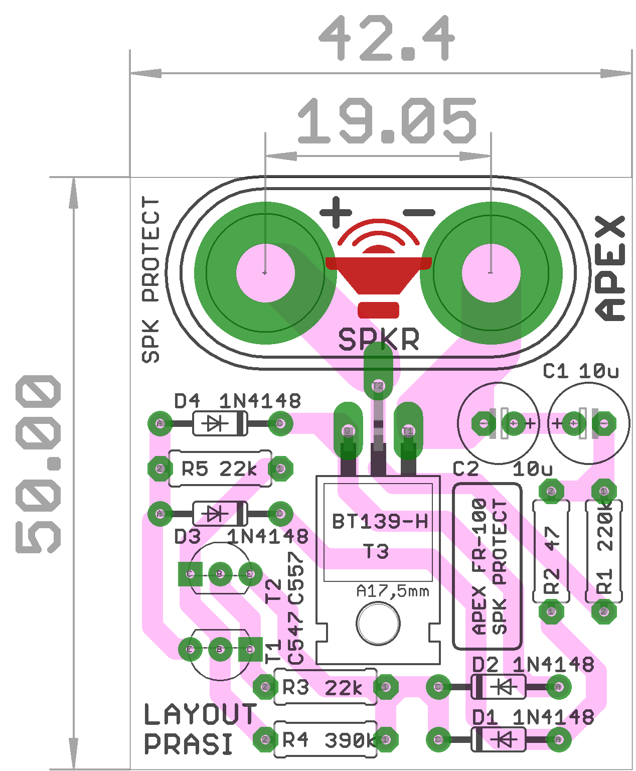

Thanks Mr. Mile, I made a layout for your SR speaker protect. Is it ok?

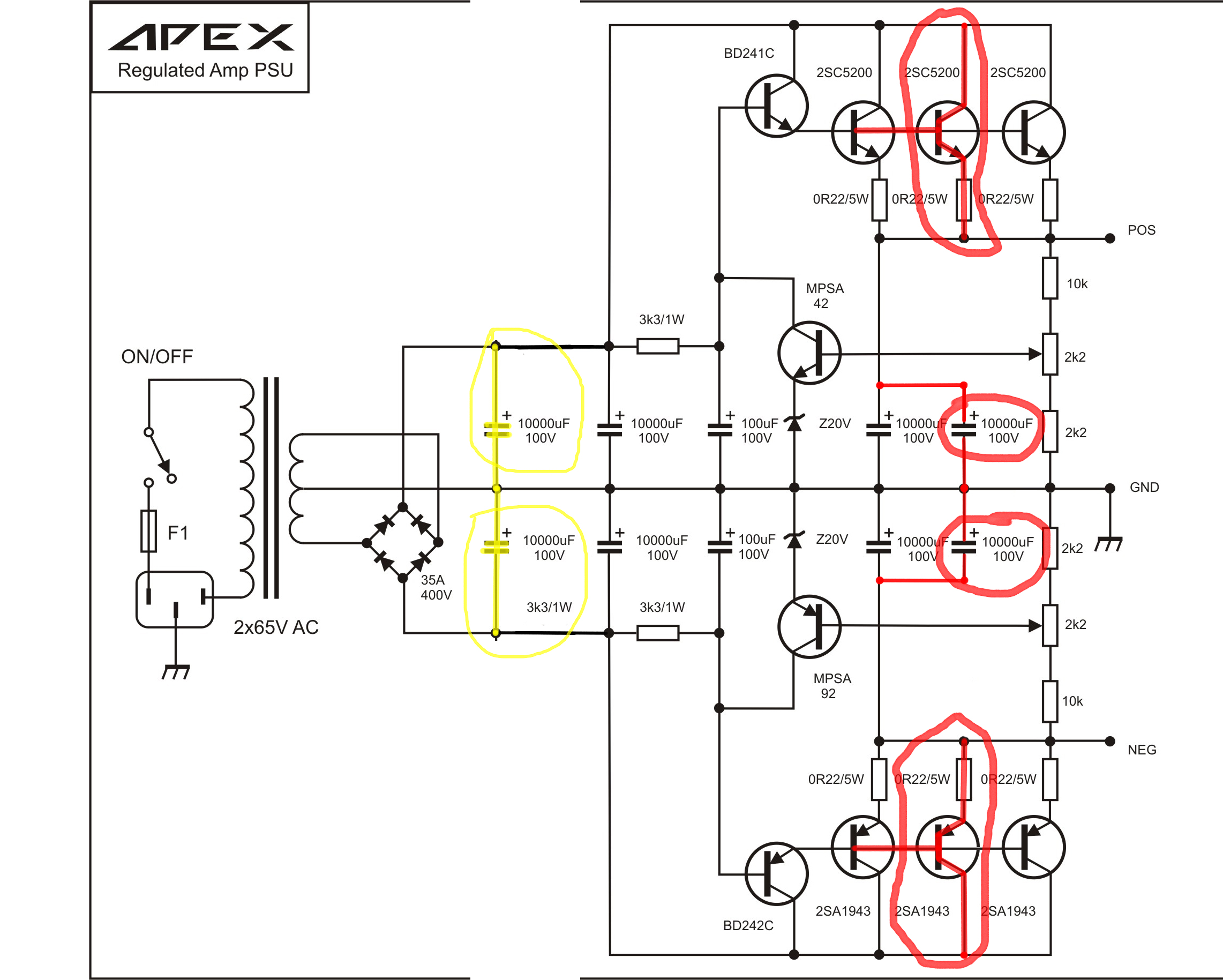

sir mile i have attached here the PSU-10 idea i do not know if it is right or what is the right PSU upgrade because i am planning to have sr200 with 5pairs on my next project since SR800 is not posible DIY . i do not know if this 2-pair PSU is enough for 10pcs MJL21193/4 O/Ps. and 2xPSU-10 in parallel for a single channel might not good as well.
that red marks indicate the additional output pair and 2x10,000uf, further is it necessary to place another 2x10,000uf marked yellow. and what changes do i need to do then.
And/Or simply what regulated PSU will be enough to handle 5 output pairs of MJL21193/4 moreover should MJE15032/3 instead of c4973/a1837 drivers?
i'm sorry for being delighted on your designs i love doing it before summer vacation ends.
thank you
regards
For 5 output pairs just add another output pair in PSU10.

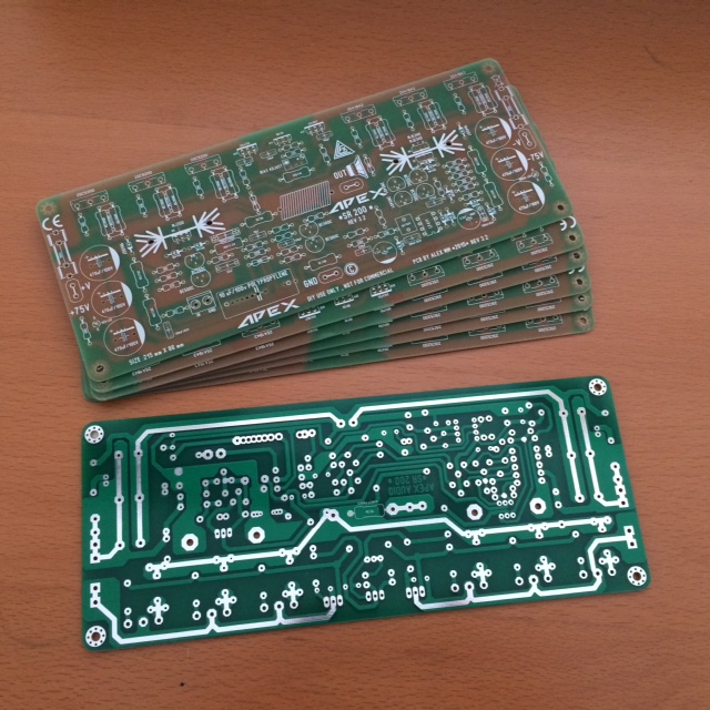

I just received the PCB's for my SR-200 build. I had to order 10 pieces but want keep only 4 of them. So if anyone is interested I'm selling 6 PCB's. They are designed by Alexmm and are version 3.2.
Price is 8 Euro each plus shipping.
PM me if you are interested.
