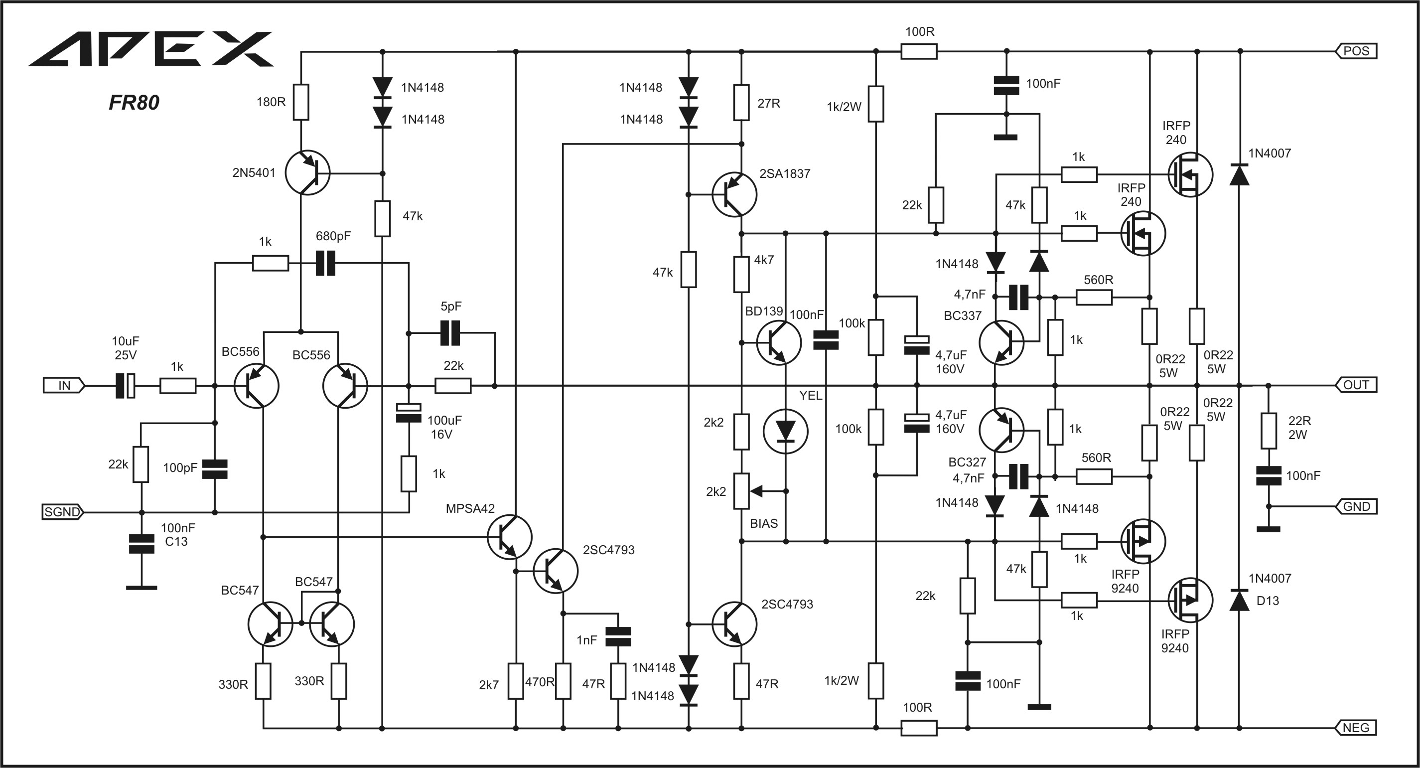

Hi, thanks.olafk you are good man thank you so much for the file ^_^
question, this does not need the output coil right ?

I couldt not see any oscillations while testing. Also the Zobel was always cold.
regards Olaf

thanks, I might add a small coil there "I just like to see a nice coil there" you know me thanks a lot olafk

SR60 a nice board and Test- is a Amp "must build" i have 25 of 1837/4793 to
build in, in a good one.

Can you, give us ,the limits of voltage rails ?
Thanks,Alex
SR60 rail voltage is +/-45VDC.
