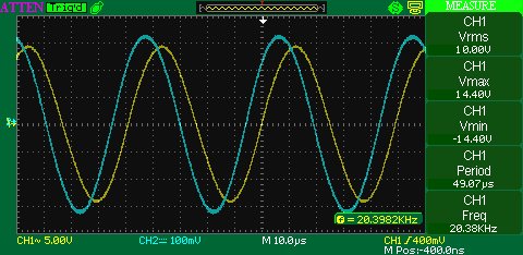

Input (w/o GNFB) = 200mV, output 10V. Gain: 20*LOG(10/0.2) = 33.9 dB
I'm certainly need to refresh my math skills back to my student days.

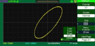

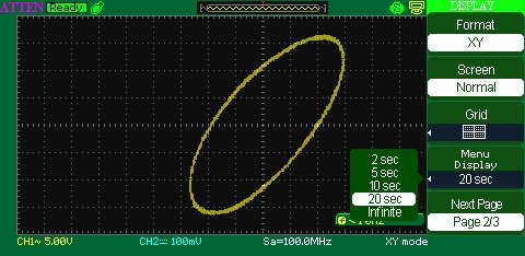

Here are oscillograms of 20 KHz input/output. Can you please point to the reference how to calculate these RC values?
One point measurement won't help. You need to cover all frequency range from 20 Hz to 500 kHz. An example: one amplifier I measured recently had problem with stability at 280 kHz.
What frequency point are required (e.g. 20 KHz, 50 KHz, 100 KHz)?
At 207 KHz input and output signals are completely out of phase.
