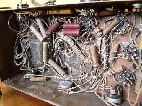

Ok- I'll ask again, but this time I have pictures:
I plan to use this amp with a 1x12, 8 ohm speaker cabinet.
My guess is, I will have a speaker cable with a 1/4" jack at one end (to plug into my 8 ohm cab) and the other end of the cable wired somehow to the output section of the amp. This is where I need guidance- how to prepare the speaker cable and where to hook it up.
I have attached a schematic of the speaker plugs and their connection to the transformer and power tubes.
In my next post, I will have a picture of the inside of the the speaker outputs (J2 & J4) as seen from my amp. I have labeled the pins on the speaker sockets since the amp was turned upside.

Wow! What a mess! I suggest that you throw away everything and tape off the unused impedance ratings. Then take the 8ohm wire and the ground wire and solder them to a 1/4" jack, in which you will put the speaker plug. Easy
But pay attention to those resistors coming off some secondaries and returning to the amp... those are NFB resistors... you want to keep them (but try to disconnect them and you'll get much bluesier sound... maybe you want to tweak their value...)

Hello! Great looking amp btw. I've seen the photos... It won't be easy to figure the speakers out, but I'm sure you can... just do as I told you: desolder all the wires, solder the 8ohm one to the output jack and tape all the others.
