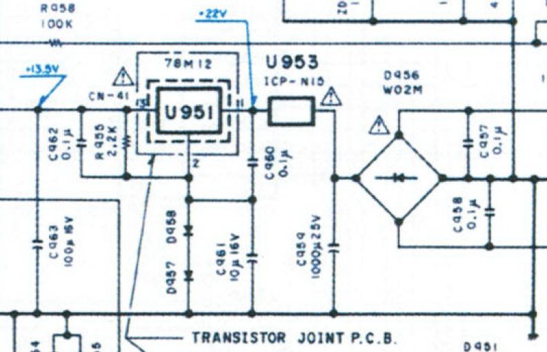

The regulator that failed with no output was U951, a 78m12 device. After replacing, the output was 13.3v, measured with a recently calibrated Fluke 87.
That voltage is correct.
It is 1.3v volts because the two diodes raise the ground reference of the LM7812 regulator by the total voltage drop across the diodes ( 2 X .65v).
For an example if you added another diode the output would be 13.95v and if you took one diode out (or just shorted one) the voltage output would be 12.65v. jer
