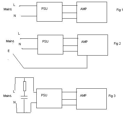

I have a hum issue. The attached image shows AMP-PSU Fig1 and fig2.
With fig1 hum is present with the amp input terminals umterminated. Short circuiting the input still produces hum. BUT!!! when the amp is connected to a source (pc/ cd player/ protable cd player powred with only batteries) the hum dissapears completely.
Trying fig2 does not remove hum but produces noise and instabilities.
The amps and PSU have been insterchanged for several other models but the problem persists. This issue is also happening with some commercial apparatus i purchased.
Would fig3 solve the problem or do i need to check all my mains wiring at home?
P:S:- i was living in another place before no issues were met am getting theses since i moved to a new place.
Thanks for the support

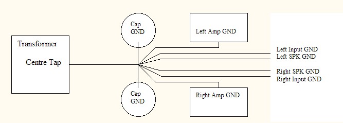

Hi zeus_threat,
you have a serious internal ground loop. See below for grounding suggestion.

Thanks for the reply
thanks for the reply guys. Well the PSU is already using star grounding, but like i mentionned its occuring with many amps and PSUs. Well actually mike the same appartus are being used in the new house, no new equipment has been added. I even unplugged all apparatus at home to test the amps but still the hum is present. The mains wiring have been made by a "qualified electrician" . Need to have a check at it. Is there anything you could suggest to investigate.

I don't see an earth ground in the first drawing and one included in the second, which I guess didn't help. The third adds a noise filter which might help if it was RF noise.
What I think might be happening is the supply voltage might be lower (I have seen this). What kind of amp are we talking about here, DIY? Are there any regulators for the input stages? If the input voltage to the regulators was lower because the line voltage to the house is lower (country location, old house and wiring, tired transformer on the pole outside) the regulator performance can get marginal and hum is a side effect. If this is the case listening late at night should possibly have less hum.
Other then that there's not enough info for me to troubleshoot this further.
Regards, Mike

Thanks for the replies. Well as you see in fig1 i was not using the mains earth at all but still the hum is present.
Well regarding the amps it happends with diy and commercial amps(not all though i got a pioneer and yamaha map which do not have any issue at all, these are double isolated and do not use mains earth at all).
The amps (diy and commercial) that have this issue are class AB some are discrete others are ic based but none use regulators for the input stages.
I will try to test it at night to check if the hum still remains.
I measured the mains and its at 240V. I have also measured transformer secondaries (for the amps getting problems) against their rated output voltage and the rated value is being output
But the thing that buzz me in all that is how the hum suddenly dissapears when the amps are connected to a source(pc, cd player powered only by batteries) but when the amps inputs are unterminated the hum is there.
Any clue on what could be causing this?
