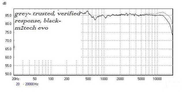

anyone has done any measurements of m2tech evo usb/spdif converter? I am somewhat confused with it objective performance numbers(I am quite satisfacted with it sonic , even if quite diferent form other product)
when first tried m2tech evo sonicaly I noticed some lack of airiness in sound(less expansive soundstage) but the soundstage focus was superb as bass tightness. one day I decided to use m2tech evo for speaker measurements(it gets digital MLS signal from laptop, and feed DAC) to my surpsise i saw some top octave roll off. on white nois eI can even tell from the ears(I have designing speakers form many years) i imedialty returned to chineese made thera-linx usb/spdif converter (which measures EXACTLY like internal pc measuring equipment),
thinking my unit is defective i ordered another m2tech evo unit with more late serial number, hoping its a problem of actual unit rather then design fault. but it measured the same. later i acquired weiss int202 which also confirmd to be flat ( weiss int 202 measured exactly the same as thera-linx or internal pc measuring hardware)

could m2tech evo designer answer here. I do not want to shock customers, but I want an answer why this interface have rolled off top octave. it evenmeasures from 1.5meter on speaker axis!!

Actually, my guess is the two tested spdif transmitters differ in pre-emphasis bit in SPDIF preamble and the DAC respects this information. That would produce this behaviour.
Status of the pre-emphasis bit in SPDIF stream can be checked with any card with SPDIF input e.g. in linux, perhaps there is a way in other OSes too.
If you have a DAC with pre/de-emphasis indicator (no idea if any exists :) ), you can check.

I do not see how drivers could change frequency characteristics of bit-perfect digital transmission, and consistently too. Provided the transmission is really bit-perfect which should be verified first.
No, none of my DACs have an indicator. However, I think if either M2Tech driver was not bit perfect it would have been reported by now.

I do not think there could be a bit-perfection indicator. The check requires recording the stream with another device equipped with SPDIF input, and comparing with the original.
I don't know, very few people do this check.
Hey, this just what I have heard, and many here will rubbish that because I don't have measurements to back it up....
Come on, this is not rubbishing, but the first question which comes to mind when a different sound is reported. The most likely explanation is the actual stream is different. Every analysis always starts with the most likely cause.
