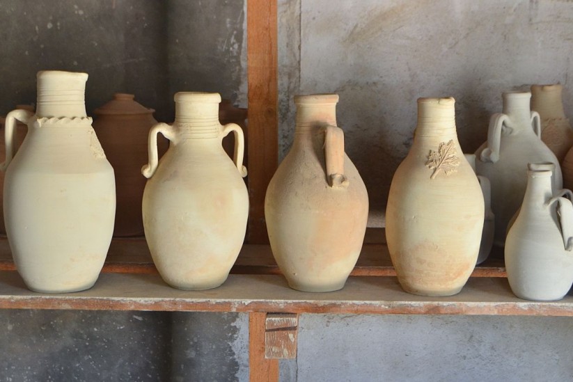

This is αιγινήτικο κανάτι (Aegina's jug). It keeps the water inside it cool by vaporizing some through the ceramic body. Simple physics! Once, I thought how to use this as a heatsink but the drawbacks are humidity and necessity to fill water all the time...

αιγινήτικο κανάτι ...
Yes, evaporation is effective *after* you spread the heat over a large area to get a lot of evaporation. A jug of water is naturally large. Power chips, with present production economics, are invariably "small".
Small engines used to be evaporative cooling. Just an open water jacket. For a short run, the specific heat of water would absorb some HP-Hrs. Longer run, water gets hot and there was some evaporative cooling. Keep running, water boils away, you get a LOT of cooling but the water consumption may be high.
