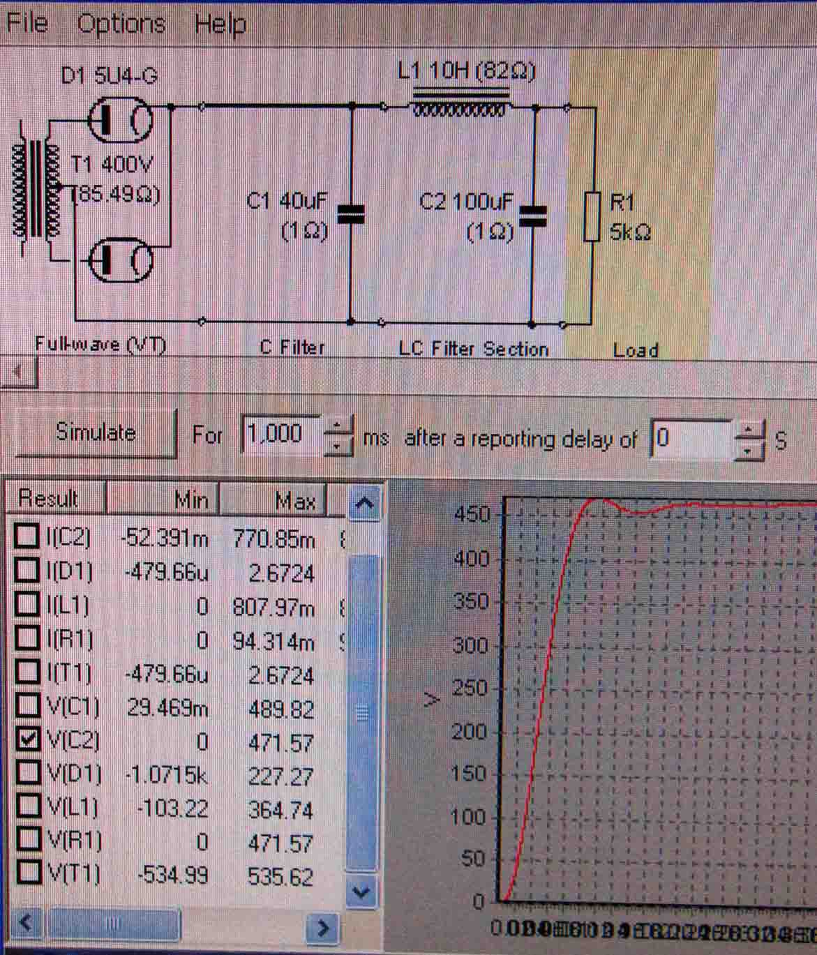

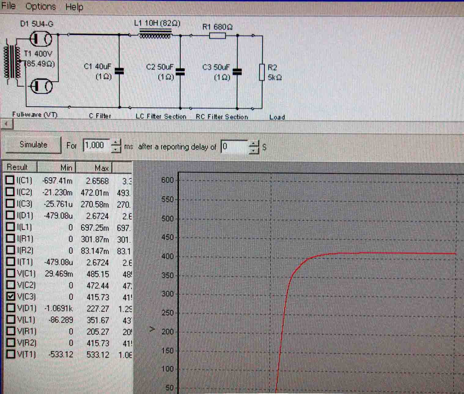

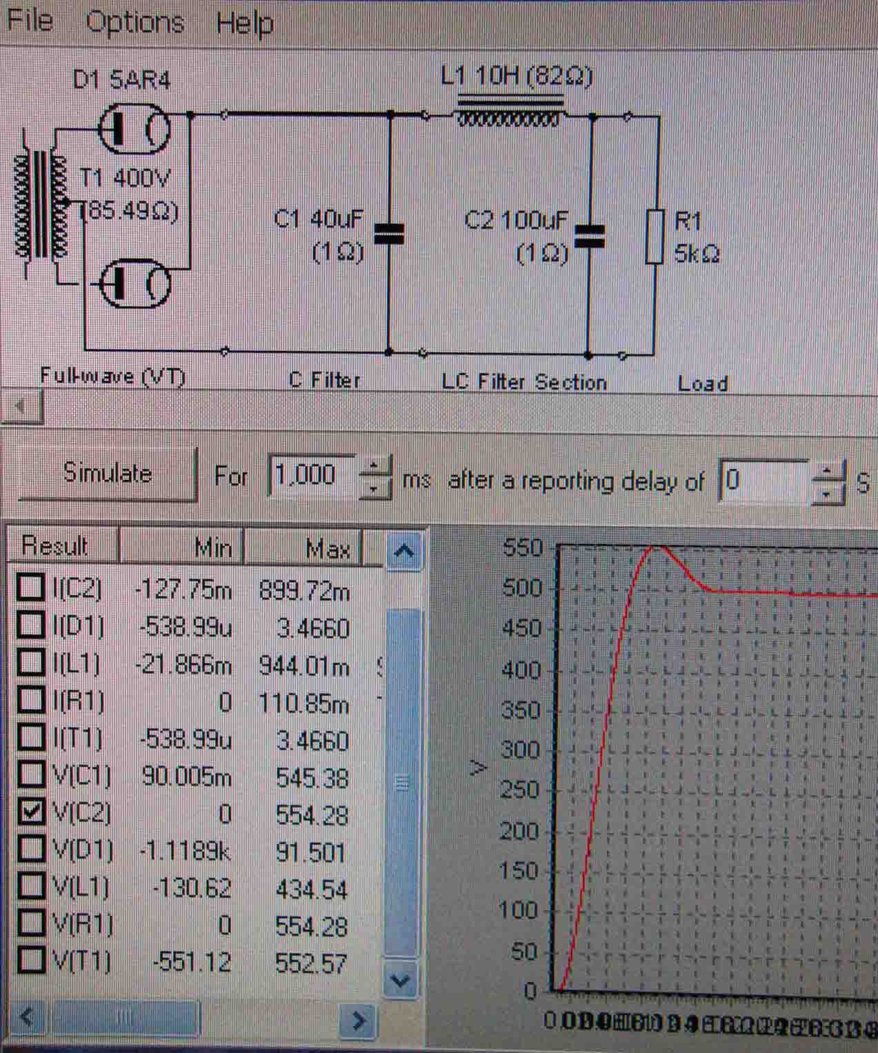

I've tried to figure out PSUD2 for the first time for a 400V transformer @ 200ma. Here are my graphs for the 5U4-G and 5AR4:
Power Supply:
-Transf: Hammond 278X. Prim: 115VAC; Sec: 400-0-400 @200ma
-Caps: ASC Motor Run, 440VAC (600VDC)
-Choke: Hammond 193J 10H, @200ma, 82 ohm
Circuit:
#1: 400V - 5U4G - 40uF - 10H - 50uF - 680R/25W - 50uF in CLCRC: Vmax = 415VDC
#2: 400V - 5AR4 - 40uF - 10H - (2)50uF in CLC: Vmax = 554VDC
#3: 400V - 5U4G - 40uF - 10H - (2)50uF in CLC: Vmax = 471VDC
Questions:
1. I am getting a higher voltage with the 5AR4 (554VDC) than with the 5U4-G (471VDC). Did I do things correctly?...
2. Did I design circuit #3 correctly with a 680R/25W resistor between 50uF(C2) and 50uF(C3) caps?... How will this alteration affect the sound or electrical characteristics of the amp?...

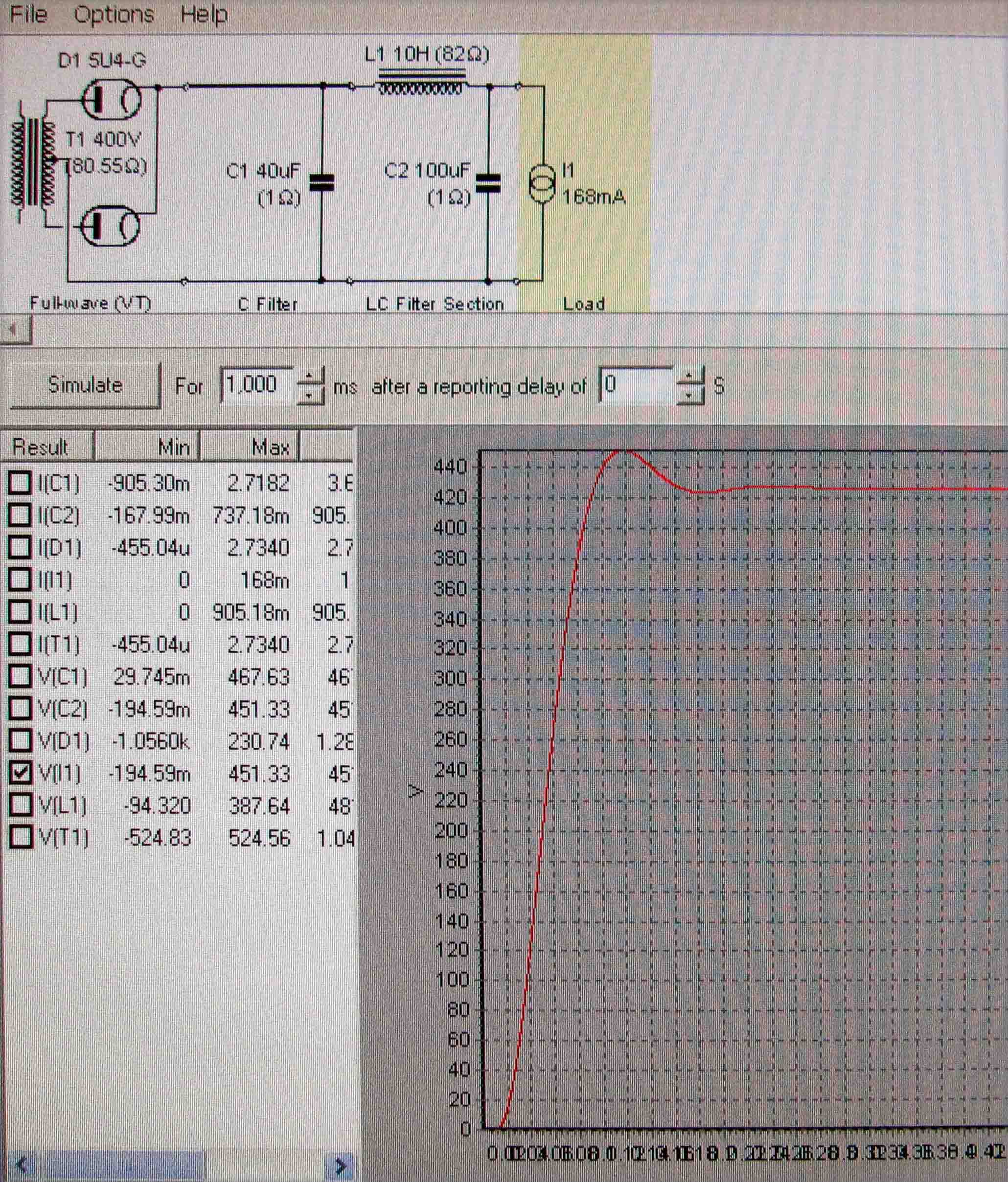

You need to change the load in PSUD2 from the resistor into actual current load that you will be loading the PSU.
For the Abdellah KT88 SE, 160ma for the two KT88 and 8ma for the 6n1p. HTH.

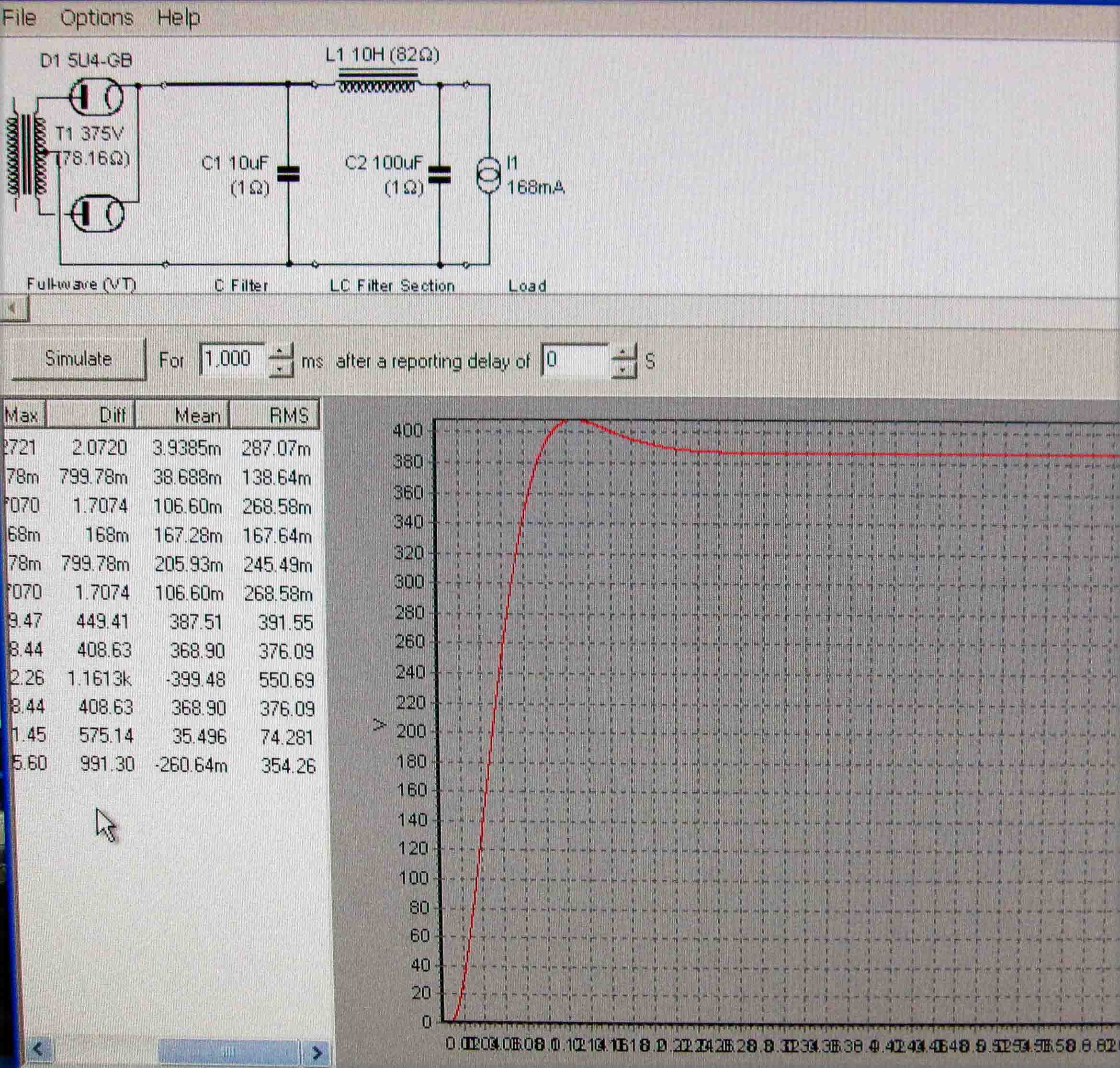

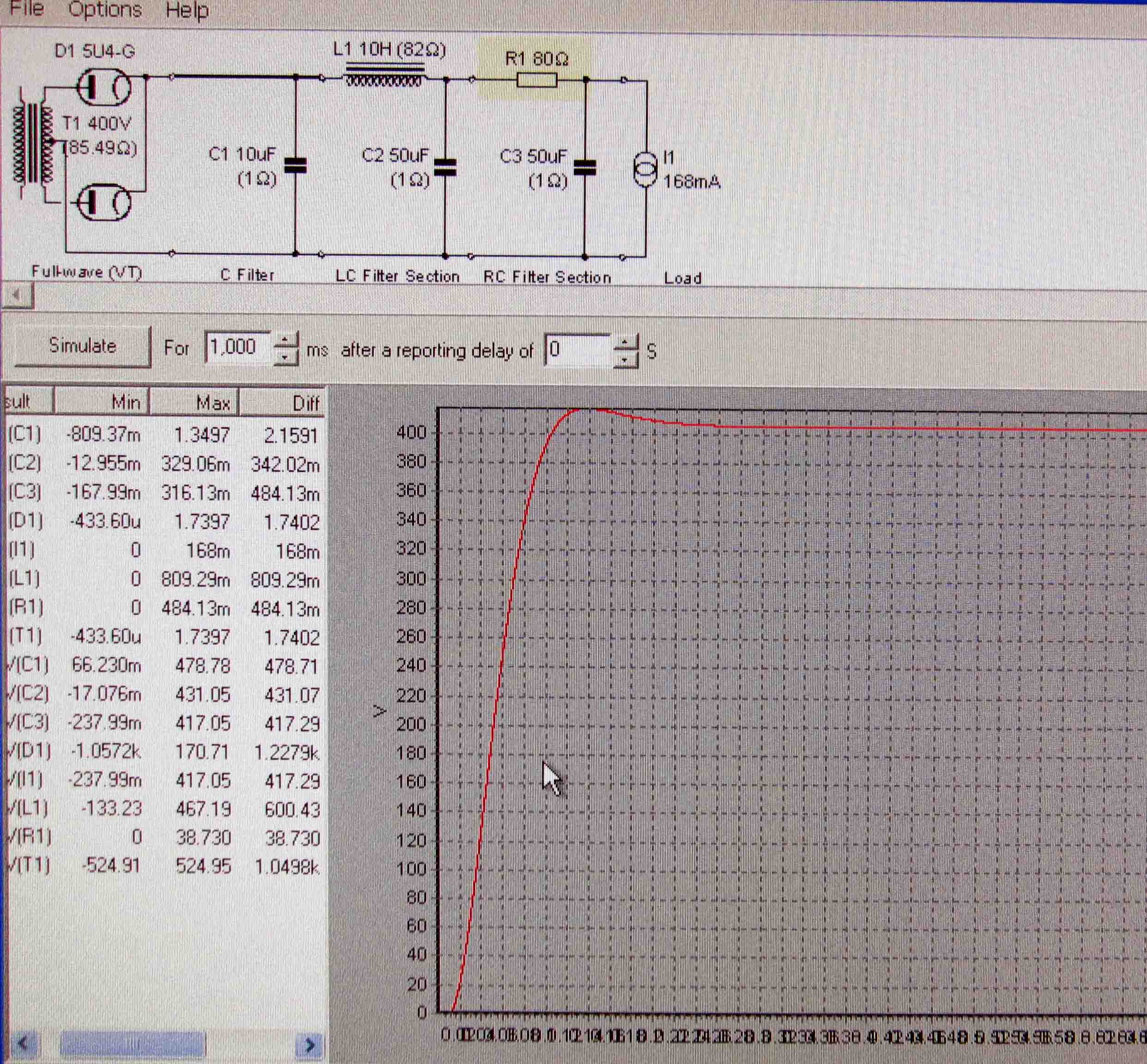

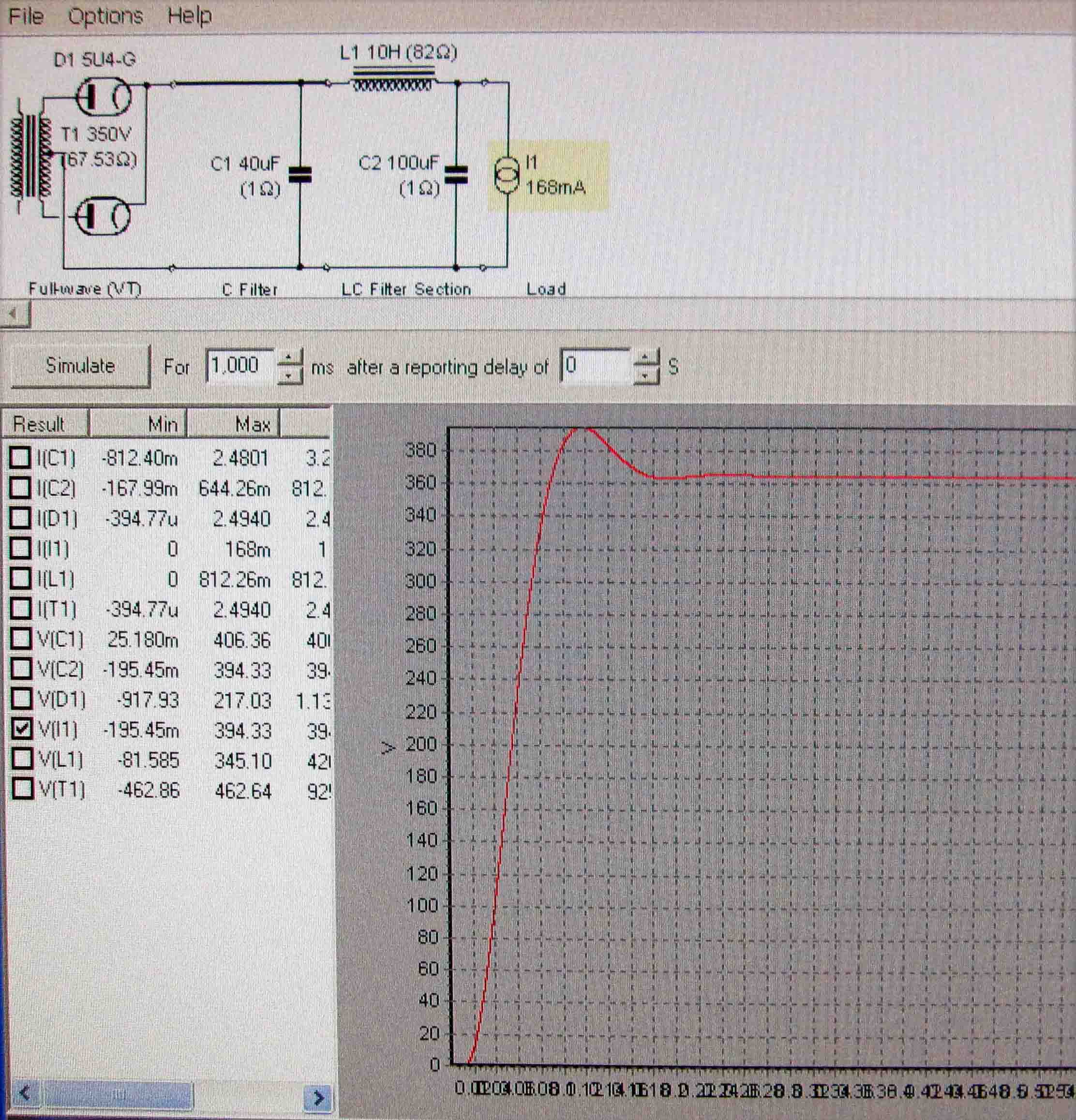

Alex, Glenn, and Jeff - You guys have been awesome! Here is my second simulation ever on PSUD2. I used the sum of 168ma as the total load current, where the KT88 pair bias is 180ma + the 6N1P bias is 8ma (Hope that's the way). I assumed the internal resistances on the ASC caps to be 1 ohm each.
1. 400V - 5U4G - 40uF - 10H - 50uF - 80R - 50uF (mine): V(I1)= 405V
2. 400V - 5U4G - 40uF - 10H - 100uF: VI1)= 426V
3. 375V - 5U4G - 10uF - 10H - 100uF (Alexg circuit): V(I1)=386V
4. 350V - 5u4G - 40uF - 10H - 100uF (Porkchop circuit): V(I1)= 363V
I realized that I didn't use 5U4GB for #3, but the difference between 5U4G and 5U4GB was only 5-6V in the simulation.
Questions:
1. #3 and #4 voltages seem lower and not sure why it's below 400V?...
2. Alexg, I've read that you advocate a LM317 regulator for the 6N1P cathode bias. Is my calculation correct: 1.25/0.008A = 156ohm or 150ohm resistor placed between the A & O pins with the I pin to cathode and O pin to Gnd?...
3. Jeff, can you use a 6DJ8 in the existing circuit by just reducing the cathode resistor to 470 ohms.
Glenn, I've remember reading that Hammonds are conservatively rated. If so, then I might go with either the 350V or 375V and stop losing sleep over my first project. But, this little snag made me more familiar with PSUD2.
Thanks guys!

Per the Sylvania manual it's 40uf max.

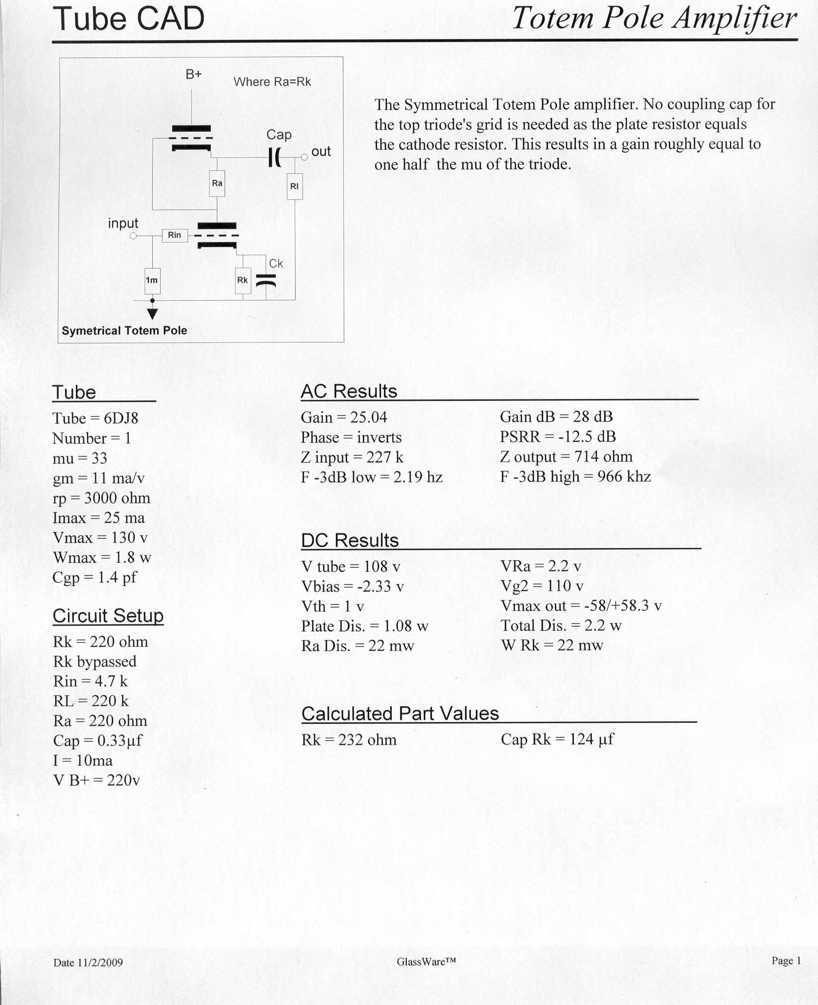

Puzzled ..
Pardon me for chipping in .. I'm a newbie .. but am puzzled by all this talks about Tubecad, SRPP & PSUD2 which I'm totally ignorant.
Built mine according to porkchop's drawing, and everything is within spec and above all, sounds so sweet , no humming (using 604E of 101db).
This is my first built an it's exhilarating
Thanks guy, for all the great info posted.
