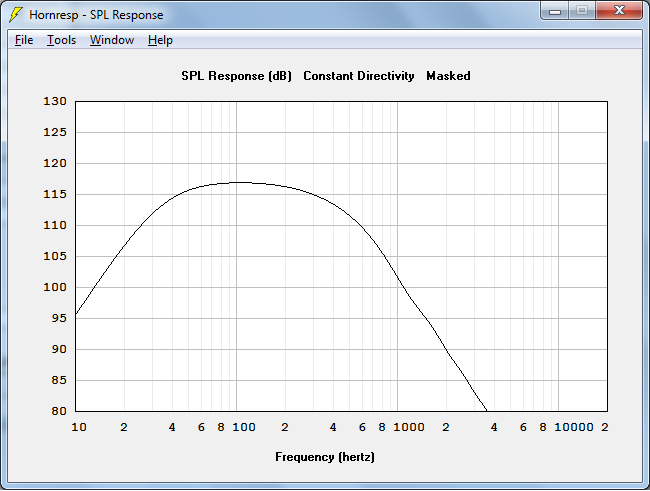

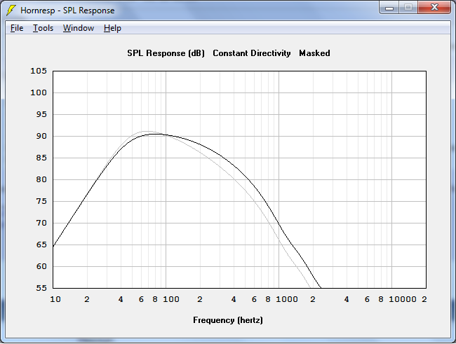

I'm going to stick with my statement. Attached is a pic of both drivers simulated in 3 cubic feet with published specs with 1w input. Which is which? The one with the flatter top end is the one with less inductance. The SI has a vague advantage between ~30 - 90 hz but since the Dayton has 1/3 more power handling it ultimately wins when push comes to shove.

We have a difference of opinion then. My opinion is: 1500W is a lot of energy, most of it will be converted to heat, not sound.
Would rather have a more efficient woofer with higher resistance to make an easier load at low frequencies. But that would also demand more enclosure volume. All a compromise I guess.
That said, at 2,83V your 18 HT simulates silly good here. Makes me actually believe your specs are indeed 1w/1m. This is at ~600L. I think 112dB within xmax, simulated at 13Hz with 40V is very good in halfspace (2/pi). The goal was predictable phase. Can anyone do better? Out of time.

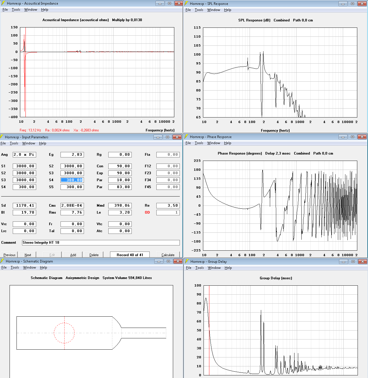

As far as a pure simulation goes it doesn't look bad but in real life it would be terrible with a boomy bottom end and no top end. Here's another simulation to compare attached below.

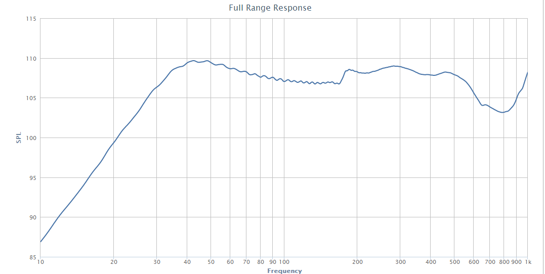

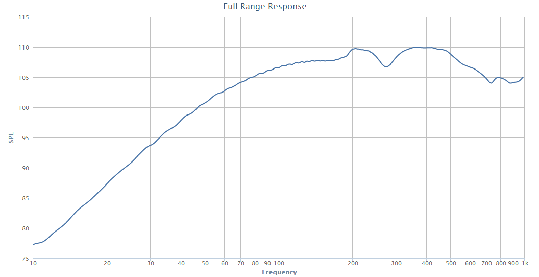

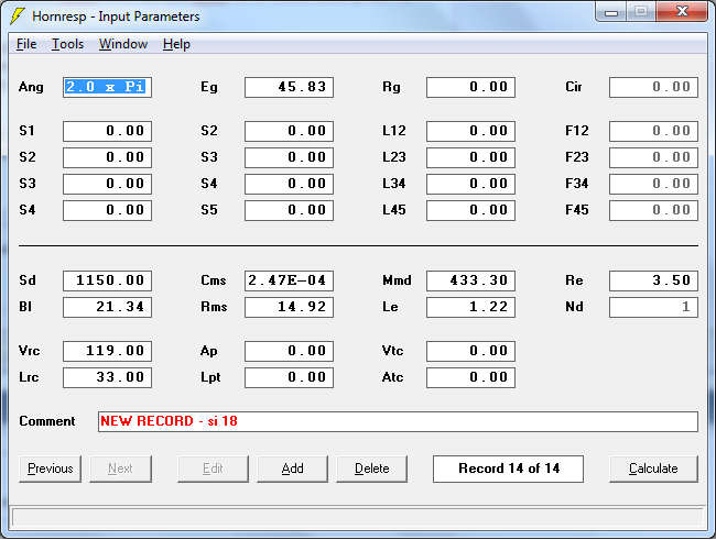

Pic 1 - you can see I used the parameters as measured by data-bass.com (prototype) in a 4.2 cubic foot sealed box, since that's the size and alignment he used to measure.
Pic 2 - simulated response.
Pic 3 - measured response.
Pic 4 - measure response of a pro driver (b&c 21) for comparison.
As you can see the simulated response looks nothing like the measured response. That's what happens when large xmax values are a primary goal. There's nothing wrong with that but you have to know what you are getting into and that simulations don't tell the whole story.
Check all the drivers at data-bass.com. ALL the large displacement drivers have a measured rolled off top end that does not agree with simulations. ALL the pro drivers have a nice full top end that reflects the simulations fairly accurately.
The SI HT 18 isn't as bad as some of the other high displacement drivers, some are substantially worse. But remember, data-bass.com measured the prototype SI HT 18 with only 1.22 mH inductance, the production model has 3.2 mH so the results with a production driver would probably look much worse.

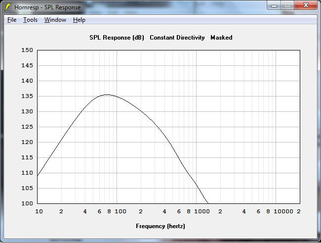

Out of curiosity I did a quick sim. In the manufacturer recommended sealed box the Jackhammer takes about 15000 wrms to hit xmax. You get response as pictured below.
Or you can go IB (5200 liters) and get by with less than 2000 watts. So you don't need a slew of amps, but you do need one that's 1 ohm stable into a single channel (or one that's 2 ohm stable into 2 channels).
