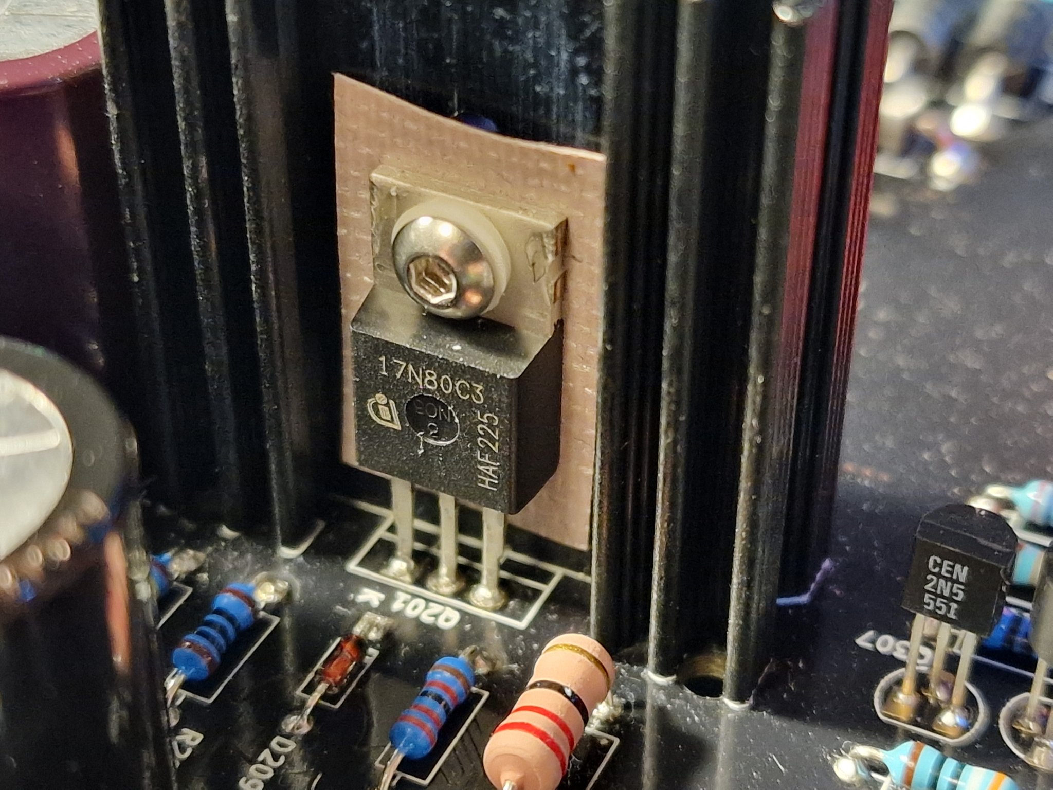

Success! SPP17N80C3 installed with a slightly larger heat sink that I found in my pile of parts. The larger heat sink is possibly not necessary, but why not? The tubes are now biased to about 45 mA, and the amplifier works as it should. I can't hear any hum at all with my ear to the speaker. Significantly more silent now compared to when the choke was connected.

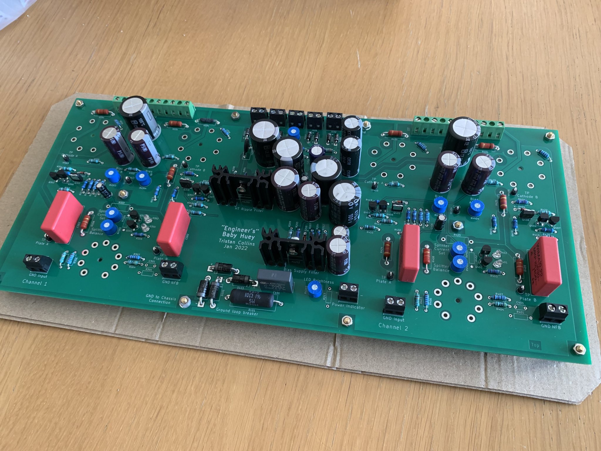

I starting soldering components on the PCB. I noticed in the BOM there are 3 values for resistors R323 and R423. I installed the middle value 33K but I am not sure if this is correct.
Great to hear another build on the way. Make sure you use a 2W resistor for R208 in the ripple filter as detailed in the above posts.
@gingertube gave a recommendation for the value of R323/423 somewhere (either this thread or the main thread, can’t remember). 22k was what I went with based on that - I didn’t experiment, however. If you stick with 33k let me know what you think.

I also installed SPP17N80C3 as a replacement for the obsolete MOSFET.

Replace R206 and R207 with 1K resistors
I actually put the 100R (R206 and R207) resistors back, just to see if it caused problems with the replacement transistor. The amplifier has been in use every day for a week now with SPP17N80C3 installed. I'm a bit anxious every time I turn it on though, half expecting either no sound at all or a load hum ... But that will pass. I'm very happy with the amplifier.

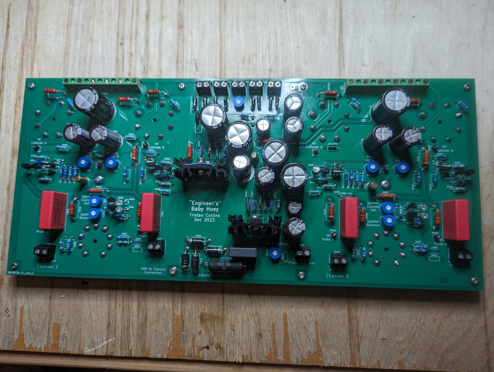

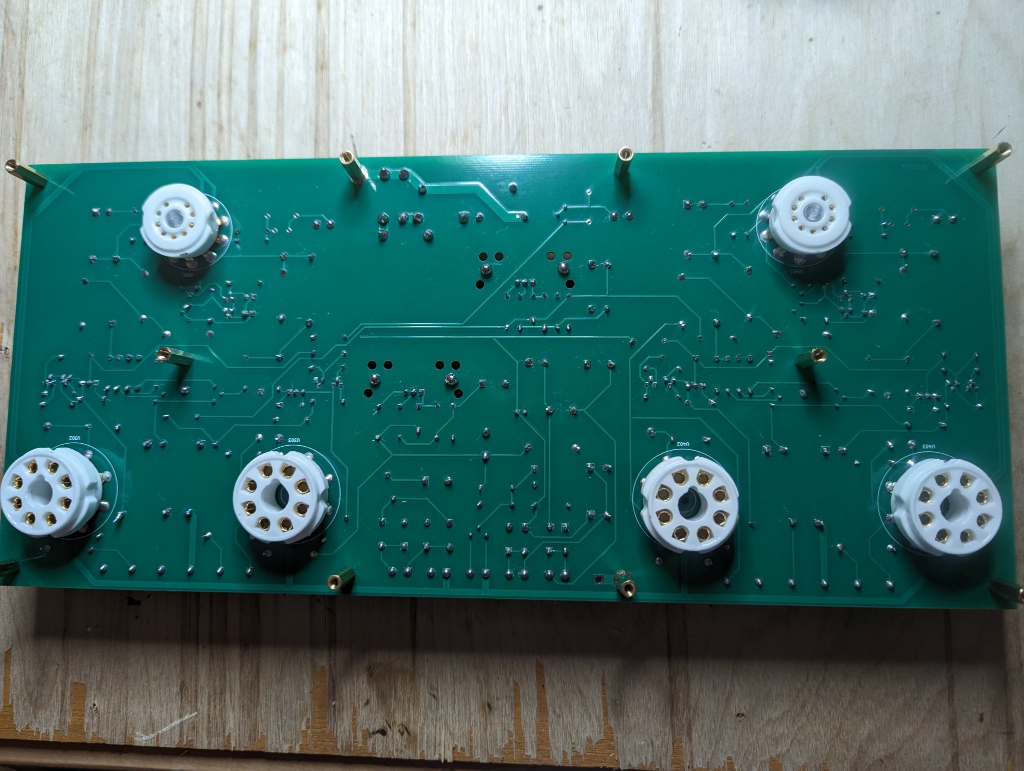

I got my PCB and components, I upgraded the PCB to 2mm thickness since the board is so large. Got the the same chassis as @tbaashus, waiting for the transformers from Toroidy, again same as @tbaashus. I replaced the obsolete MOSFET with the last recommendation and also changed the resistors to the last recommendations. Thank you for sharing the information of those components, it saved me quite some time and agony.
The components are all installed on the board, I think I installed everything correctly, not absolutely sure about Q305, Q308 and Q405, Q408. I attached the pictures of my board, if anybody sees a mistake please let me know
@tristanc thank you for your awesome support for this project.
