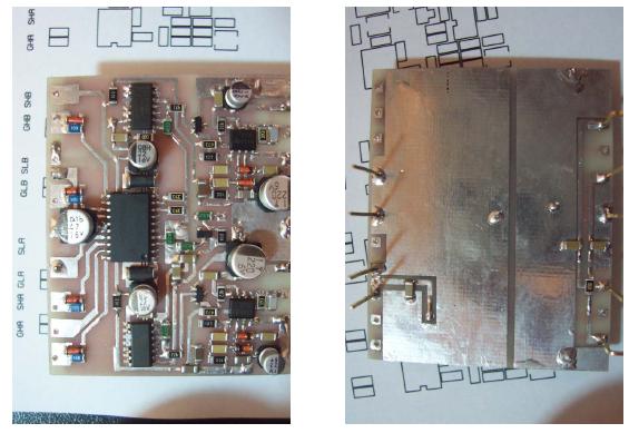

Here is the un finished PCB component Locations
Hi to every body, Now both channels of my HIP4081 stereo class-D amp works. I am desining the smd daughter borads with different ICs. One with smd HIP4081, other one with smd HIP2100 or ISL2111(3/4A drive capability) and the last one reðresented on the below in the enclosed file with IR2113(DIP). Main board will be flexible for application of all the daughter boards.

I am now desining the main board. Then I will do the second daughter board for 3rd and 4th channells. At the end I will desing the sub channel with HIP4080. I saw somewhere, HIP4080 can give 400W RMS in fullbridge topology.
Hýým, I do not know if you realised or not, the DIS pin of 4081 on daughter board. It is unused for now but at the end I'll put a protection circuit for all amplifiers. Similarly, it is possible to add protection and soft start circuit to IR2110 via the SD input.

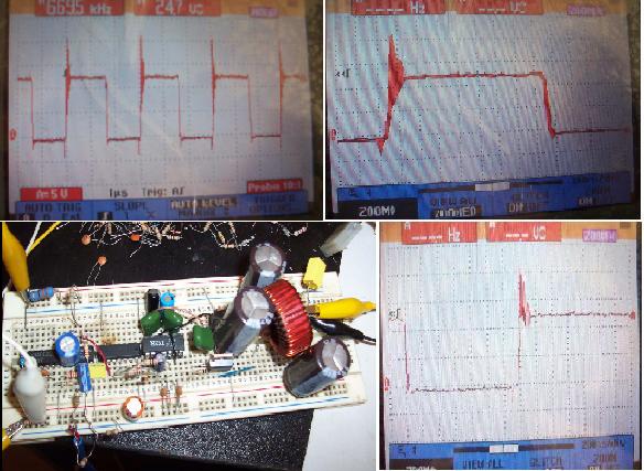

Scop results
Hi Luka et all.
For a long time break now I returned to my class-d amp. It is very bad to say one channel of my HIP4081 chip smoked . I got some scop results with the working CH but, i think the smoked ch burnt something inside the chip and the IC does not work properly. So the output sq wave is not in 50% . Any way my friend brought the mobile Fluke for an hour and I got these photos. More masurements will be done next weekend by changing the IC with new one.
I also tested 2113 ( 4069 for triwave+ LM311+4070+2113 and IRF640 for output) and got the scop results. The test was made on a board and all the circuit on board with single 12V supply. There are some spikes but, the circuit built on a bread board and no snubbers on output mosfet. So, it is normal I think.

Great, it works, well at least one does fully. What you must remember is to put alot of C for IR output drive, not that important for vcc/vdd. So 100uF for vcc/vdd is ok, but just to be save try to have 100uF normal(elko) + 22uF tantal for low an high side drive. I have that much, and what way I can't destroy my IR or fet if the amp would clip at output.
You use 4069 for what? Also I don't know if LM311 is what fast for use in D amps, well you know by now, so I guess it is.

Yes I'll start but to make boards.But i gave up daughter boards. Why? Because when one uses daughter boards it is difficult to ensure short tracks between the mosfets and driver IC. But, it is usefull to make a daughter board for tests.

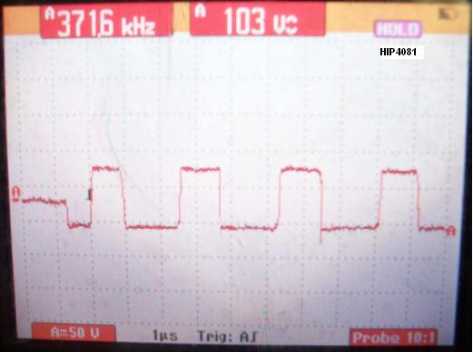

Did you see the output wave form of HIP4081? It is disappointing that the output has 103V pk to pk before LC filter. And 4081 only can work up to 80V . Although my power supply is +/-35V ,I saw this 103V on the output. My bench SMPS converts 12V to +/-35V and can handle up to 400W. But now it has a 10A projection car fuse on input. Therefore, it can not give much more than 120W or so.
Hýýým my pcb component lay out enclosed. Not final, it is the last version before the final one. Final one on my home PC .

4069 for triwave osc ( third of inverters for triwave, see AN9405 on the link below). Plus something, I am planning to use the left 3 inverters inside the 4069 to ensure dead time instead of RDC network. What do you think?

HI
Use RDC network. Why? instead of R put trimer = pot, so you can adjust dead time for both sides. How did that 103V get there? Do you have any decoupling cap cross supply? like 470nF one? I would also use 4060 for generating triangle, I can already here you say why, well fixed freq., able to synchronize it with smps or other amp,... it is constant so you don't need to worrie that it will change during music playing....
