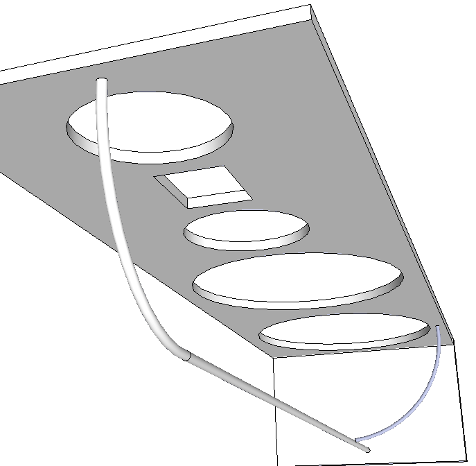

I hear the endorsement for ply, butcher block, and mdf. I've built numerous boxes out of MDF and never been dissatisfied with the stiffness/rigidity, especially after putting in dowels or braces between parallel panels.
My concern with this project is that minimizing the width of the OB will leave just an inch or two of reveal at the horizontal axis of the woofers. I'm thinking that steel will provide much more support at this vulnerable spot. I am considering using 1/4 horizontal rods at these points creating a truss back to a rear vertical pole centered behind the drivers. Sort of like ribs. Here is one:

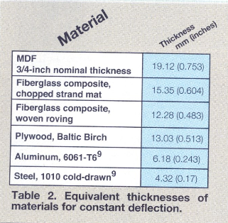

Why would you think that plywood is stiffer than steel?
Looks like Charlie was talking about stiffness compared to weight, good plywood beats aluminum or steel in that regard.
A cubic foot of Baltic Birch plywood weighs about 41 pounds, aluminum 168 pounds, steel 490 pounds.
13 mm Baltic Birch is as stiff as 6.2 mm aluminum or 4.3mm steel, but aluminum is about 4 times the weight, steel 12 times the weight.
