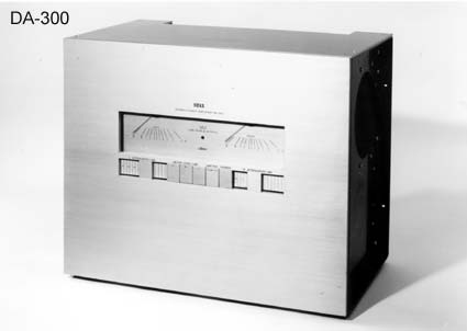

I have one of these amps
A Stax DA-300. It's a nice amp, well built. Undoubtedly it does get the 150w from all class-A. It runs hot, and has two silent fans to dissipate the heat. It's heavy, and pretty rugged overall. I havent' used it in a couple years but it had more than enough power to run the ML CLS I have to plenty high levels of volume. It has switchable AC and DC coupling and a few other interesting things on it. Let me know if you end up cloning it and need pictures or something from the insides. I don't have a schematic or manual, unfortunately.

I for one would be very interested to know how the cooling setup of your Stax is, if it does deliver the goods in full class A as you say.
From the size of the amplifier, mentioned in a Stax story or brochure in the past millenium, i found it hard to calculate how it can cope with the heat if it runs full class A. (believe it was the brochure of one of the later models)
The output devices may be TO3's, but the number and their power rating confirms that it would be very difficult. Supposing mica was used at the time for insulators.
Especially in the climate you are enjoying.
If the fans are silent running the heatsinks of the DA-300 must be out of this world.

well, I guess it depends on what you mean by best. the da-300 was the most powerful and most expensive save for the DMA-x series. Does that make it 2nd to top of the line? IMHO yes (among other reasons).
Anyway, I will try to take some pics if anyone is interested. it has big heatsinks which are within the fan area, in a circle-type configuration. It sheds a lot of heat when running, I am pretty sure it is supposed to be 150w full class A. There are other (more modern) SS amps that run that much class A power without fans, so it should be doable.
