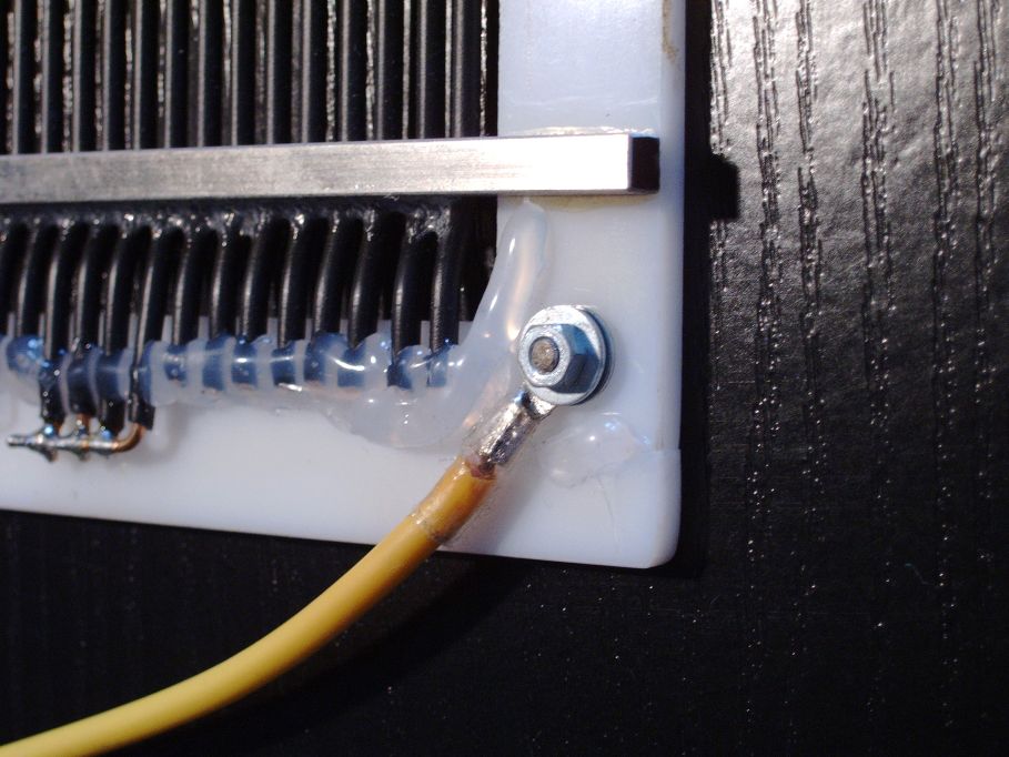

have a look at the Audiostatic panels. They use a quite fragile but thick frame of insulating material. Square metal rods are glued horizontally onto this frame and to these metal rods the insulated wires are connected to. Thats imo one of the easiest ways to get a good safe stator with little stray capacitance and tight tolerances. But as You might see on the pics You have to use relatively thick single stranded wire that has to be straigthened. Such a design is very low in material-cost, but high in working hours :xeye:
jauu
Calvin
