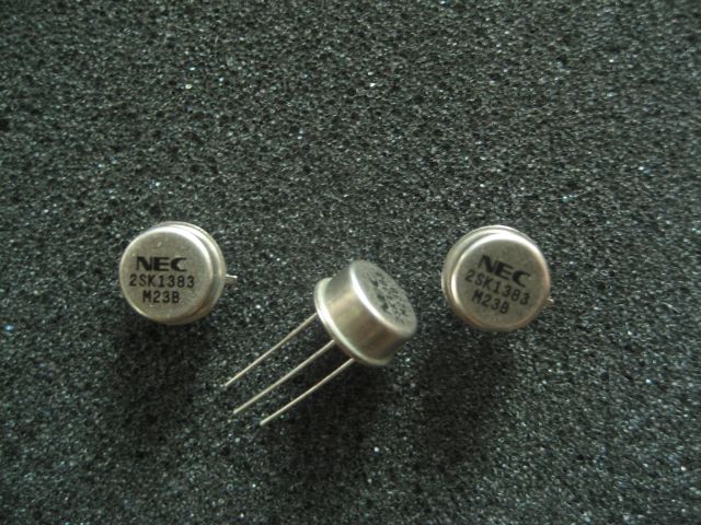

I have bought some 2SK1383 Transistors and then i will test its.
This device is a SIT transistor one sort of V-fets or vertical Jfet.
I not found the datasheet for its and i have thought to test its with digital multimeter.
Against in my mind its behaviour are different from common jfets.
N jfet for example present a PN junction of 0,5 V between Gate- source and gate-drain (positive tester on gate) and a resistance from 20 to 100 Ohms between source and drain about in both direction.
Indeed testing 2SK1383 i have found one junction voltage of 0,517 V between two terminal (I not know for sure the pins of 2sk1383). So I think that the pin on the + terminal tester is the gate and the other two terminals are the drain and the source.
But when i test among these last, i not read low resistance as jfet but high resistance or open circuit. All other configuration results as open circuit, so i have doubt on the effettive pins assignaments or at the end if this devices is a real SIT.
There are anybody that can help me?
Thanks, Francesco :whazzat:

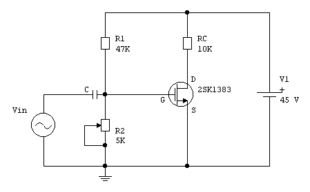

Hi, today i have try to work with this device. See the attached image
After any tentative this is my result:
1) the PIN assignament in figure 305 (above) is correct
2)VGS must be positive as MOS or NPN BJT
3)There is not current to flow trought the gate (like Mos)
4) with VGS=0 flow little current in the Drain circuit, so, i think, it go off for negative Vgs
5) the Drain current begin to rise for Vgs > 6 mV
Then i have applied a sine signal generator to view the outuput waveform. The upper side is squeezed the down side is prolonged. Remember the Mos type.
With high Drain current and low RC the form is a little better.
Francesco

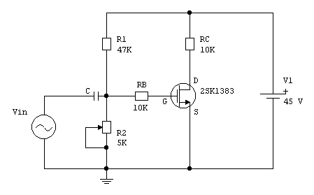

I will post image of schematic for measure gate current.
I have biased the gate for a voltage drop on Rc=20 V.
When i have put in circuit RB (10k) the voltage drop on RC stay the same. Then, for great surely, i have measured in Volt the drop voltage on RB and it was zero. So there is not current absorbition by the gate.
Francesco

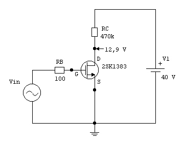

Today i would investigate better the point number 4 (little drain current with Vgs=0) to view if it working also a normal JFet.
To make that i have realized the little circuit as attached
Yes it work, also with negative Vgs (autobias), but the better performance in linearity is around 14V of Vds, so on RC must be drop 26 V.
If I want that it work as JFet the major Drain current is for Vgs=0.
Very interesting this point, i can eliminate the RK and CK other the input capacitor. I think that the input network for a signal is very very important: this is a big advantage to put off capacitors and resistors.
However the RC is very high:470k, and the bandwith is narrow.
Distortion in very low, up to output voltage=5,7 Vrms for a relative input signal=304 mV (Gain good a this low current).
Thanks, Francesco.

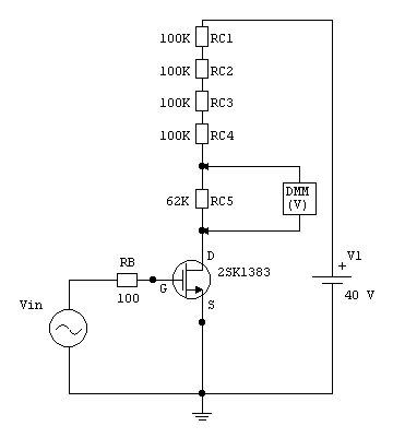

Hi, next step a will understand if this device work as a regular SIT or no. To make that i have splitted the RC (470K) in 4 resistors of 100K plus one of 62K as the schematic below. i Have put in fixed mode the DMM among RC5 to view the voltage drop so at the end the drain current and have shunted each times the other RC resistors. This is the result:
Resistor shunted V on R5
nothing 3,79 V
RC1 3,82 V
RC1+RC2 3,85 V
RC1+RC2+RC3 3,87 V
RC1+RC2+RC3+RC4 3,90 V
The result show the drain current substantially fixed enough as a mos or jfet not as SIT in my idea.
Let me know yours.
Thanks Francesco

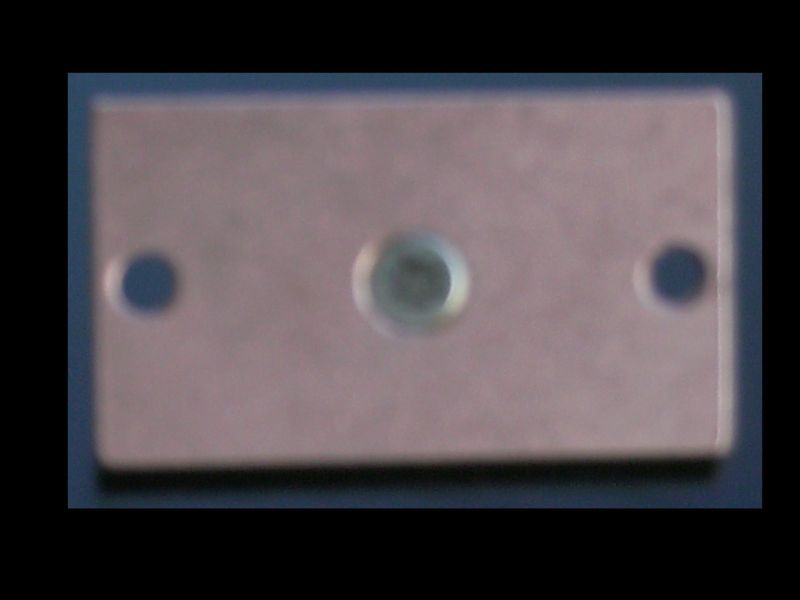

Because it product hot temperature, then it was necessary to couple it with great heatsink in unconventional mode. Before in a copper bar 20x50x4 mm ca was realized one hole (d=8 mm), then this bar was fixed to heatsink with two screws. Between bar and heatsink there is a mica foil and silicon grease. In the following the images for this work (excuse me for poor quality).
Francesco

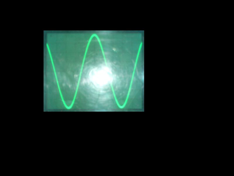

Last image is for sine signal image obtained in my scope.
F=1 KHz
V/div=2 Volt
T/div=2mS.
As you can see it's a beautiful sinewave
The amp work with no feedback overall, but only 0,22 Ohm source resistor for least control against temperature runway.
Francesco :wave:
