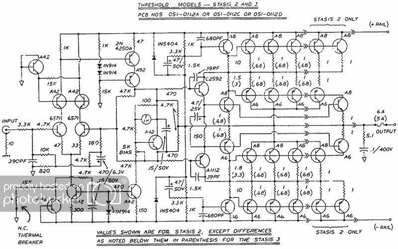

Here is the schematic for the Threshold Stasis 2
and 3. This was a very old photocopy, and I had
to spend some time trying to clean it up, but it
is now readable enough.

https://web.archive.org/web/20030509022952/www.passlabs.com/temp/stasis2-3schem.tif

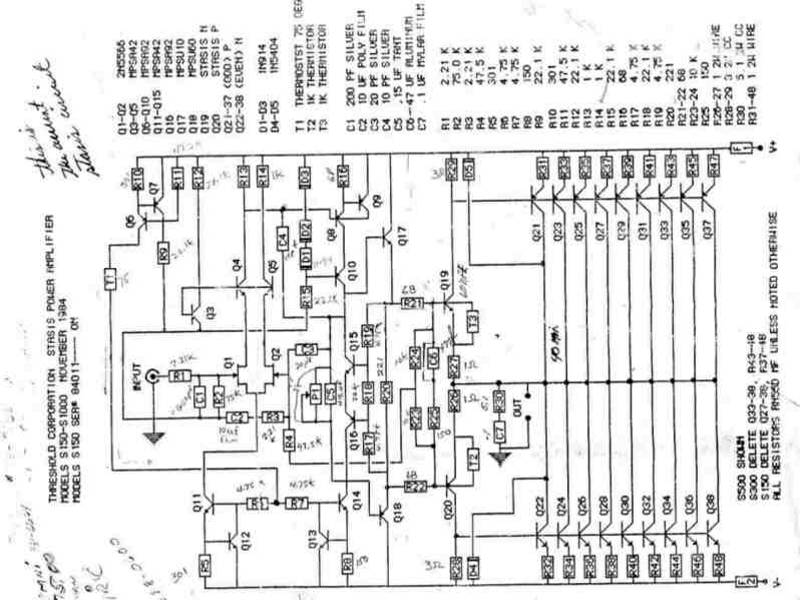

In the attachment this schematic from Stasis 2 and Stasis 3 - have a look also to
Threshold Stasis 3 Amplifier Capacitor Replacement
and that one from Stasis S150-S1000
One of both circuits could be a good circuit for starting to develop a replacement for Rowland's "7" front end potted module - go to
https://www.diyaudio.com/forums/solid-state/195051-deconstructing-rowland-7-a.html#post5809665
