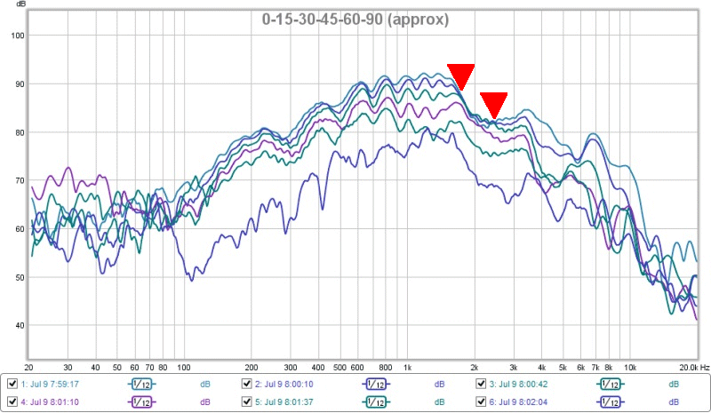

Anyone have any comments about this measuring setup?

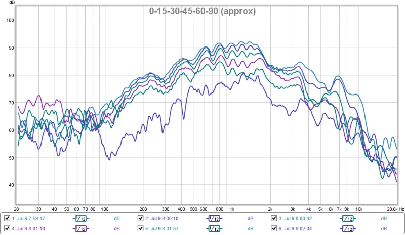

To start: Midrange, no filters, checking dipole behaviour. Looks good to 3k? Or am I reading this wrong?

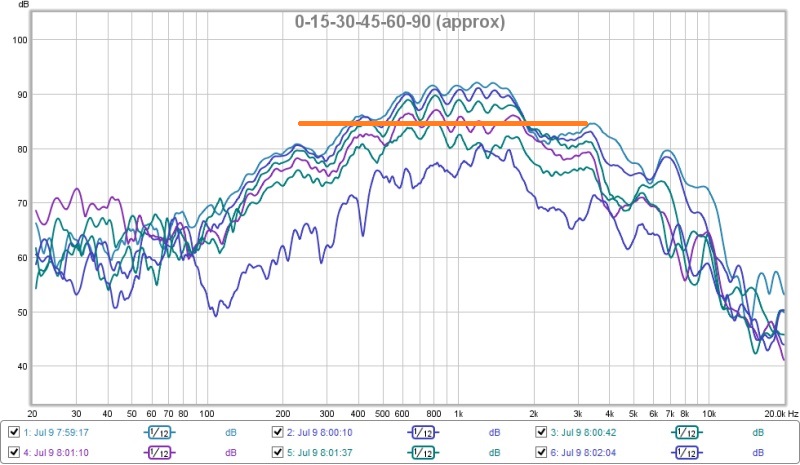

Edit2: This is really my question...If I set this as the target, I don't really have to deal with 6db rolloff...or will that result in terrible things happening?

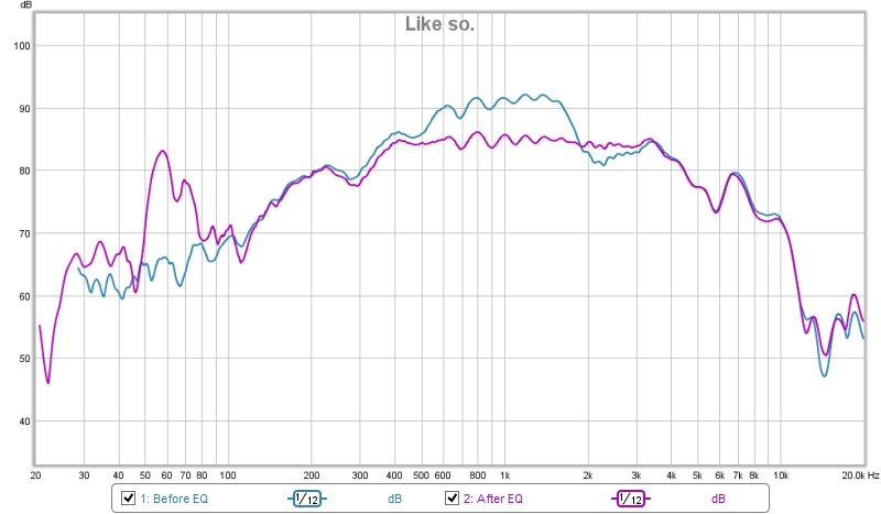

On the right track?
Edit: Playing with EQ.

It is tempting to do so. But it would be less than ideal:Edit2: This is really my question...If I set this as the target, I don't really have to deal with 6db rolloff...or will that result in terrible things happening?
Look at 1 kHz. You see the 45° SPL about 6.5 dB below the 0° level. Now move to 2 kHz. The difference between 0° and 45° is reduced to 2 dB. Go to 3 kHz and the relationship is the same again as at 1 kHz.
If you would translate that into a polar diagram, you would see how the off axis response around 45° gets increasingly wider/louder from 1-2 kHz and gets muted to the original level from 2-3 kHz. It is as if you had some additional drivers directed 45° outside, blasting away only from 1-3 kHz.
It is the classic example why you don't want to use dipoles above the dipole peak.

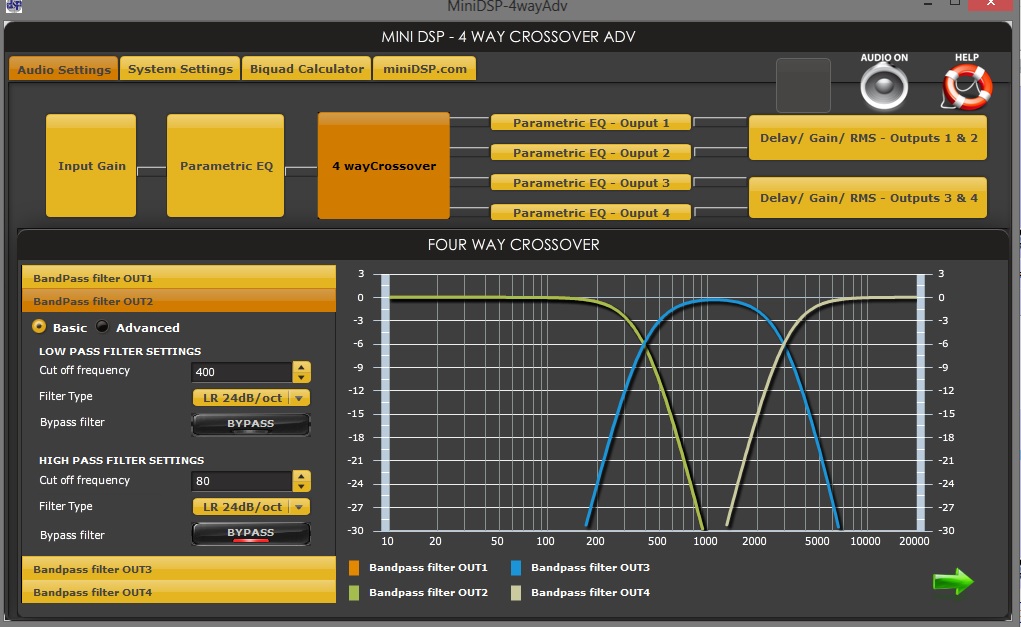

Would be interesting to see your minDSP crossover window for this.
Here you are sir!

If you have a large driver on a rather narrow baffle (less than twice the cone diameter), the dipole dip doesn't show prominently. But we can see, where it would start and stop:Is the dipole peak on the midrange what's happening around 1.8k?
The red triangles show where the 0-30° lines merge and diverge again. These are the lower and upper border of the dipole dip. It is centered at 2 kHz. The official dipole peak is one octave below that: 1 kHz. That's were your response should take a dive - at the latest.
On this particular baffle though, right? A more narrow baffle would be able to have the mid-tweeter XO higher because the peak is moved up (or almost gone if the drivers are operated nude?)
