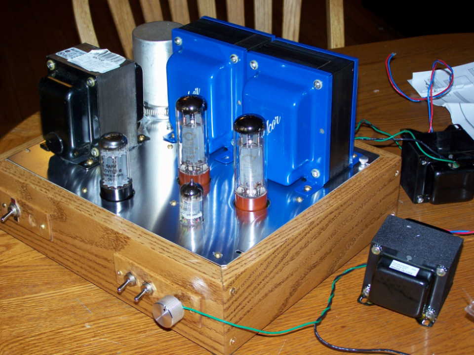

The monster Edcors arrived!
The damn thing is a workout to move...
Powered it up, and the first song I listened to, Eric Clapton inhales before he starts to sing... I thought he was standing next to me...
Couple of things left to do, but it's just about there!

some observations:
First, always - always follow directions! I have my EL34's wired in ultralinear mode once I got the big Edcor OPTs. First thing I noticed was that I now developed a 60hz hum. Small but noticeable. Last night It was worse than usual... doing the usual debug - with a meter at first - probing around looking for AC on ground points or anything exposed. Nothing. Now that I was sure I hadn't done something really dumb like put AC onto the chassis, I touched various ground points on the chassis to see if I could make it worse (feet off the floor sitting on a cloth chair - yeah, it was a sight). Turns out the volume pot made things hum the worst.
It's an oak chassis, and the Radio Shack pot doesn't have a ground lug... made a piece of bare wire to stretch from the pot shaft to the input jack... poof. Nice and quiet. It's a temporary hack, and I'll fix it right this weekend (along with the other fixes - see below)
Another thing: my winged C EL34's glow blue! I researched this pretty well following rk's adventures and even though it's really only one tube - I don't think there is much of a problem here.
Lastly, today I received some EH Kt88's. I was really looking forward to listening to them all evening - I used 3/4" spacers on the PCB to top plate. The base of the Kt88's are a LOT bigger than the holes I've cut, so they barely made contact. Powered them up anyway. Everything worked, but one channel was definitely quieter than the other. Powered down and put the El34's back in.
Back to the volume pot. When I was assembling the box I measured the resistance of each leg of the volume pot and surprisingly one channel was different then the other by 6-7K ohms. Must be a 10% pot... but I swear I can hear the difference between the two channels.
So I'll need a new pot. And new standoff's. Might as well put in the nice AC light in while I'm at it...
The bright side is that the BIG BLUE Edcor's ROCK! I can't detect any loss of high end with these, and the bass response has definitely improved.
George - I owe you a beer. Make that a six pack!

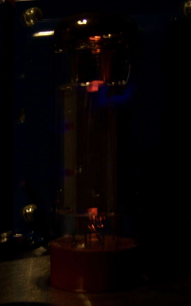

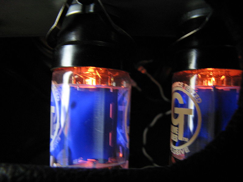

oldmanStrat said:Another thing: my winged C EL34's glow blue! I researched this pretty well following rk's adventures and even though it's really only one tube - I don't think there is much of a problem here.
Mine also glow, but it is confined to inside the cage. It looks like the glow surrounds the screen wires. Based on what i have read about carbon-coated screen wires, this seems plausible.

Beautiful photo, Russ.
I've got some of that lighter shade of blue on the insides of my plates too. I've also got some blue on the inside of the glass where a few electrons manage to sneak past the plate.
Thanks. Nice pic too. It's cool how every type of tube is a little different. The Sylvania 6V6GTs in my first amp glowed strongly and I always assumed this was typical. The JAN Sylvania 6L6GCs I have no glass glow, but the micas glow brightly. Weird.
Back to the SED EL34s...they are great tubes. That pic was taken of the Dynaco. As far as modern production tubes go, I have to tip my hat to SED. I have some of their KT88s too and they are also great sounding tubes.
I believe I may get a bit of that as well. If it is only on one tube (even after swapping them) and especially if it is only in one large spot, the usually means there is a slight misalignment in the mica that is allowing electrons to escape the cage and hit the glass right there. Many tubes, like Ty's, always do it and they will generally all look the same.
It's nothing to worry about unless the difference in the one tube is quite pronounced. Your's looks typical. My SEDs probably have had a bit of what you have, I can't remember. I've had some tubes, JJ's in particular, that have assembly issues and one of the symptoms other than internal shorts is a very large, bright blue glow in one spot that none of the other tubes have. Looking carefully at the micas, I could usually spot the problem.
