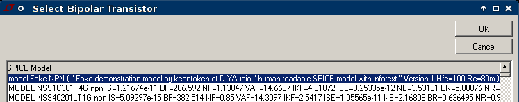

.model Fake NPN(params) * demonstration model by keantoken
Where the * tells the simulator everything after that is a comment. So here we go: let's make a standard format for models that again, suits our needs. Taking advantage of SPICE syntax, we can format models in a human-readable way that allows us to put comments inline with the model:
.model Fake NPN (
+ * Fake demonstration model by keantoken of DIYAudio
+ * human-readable SPICE model with infotext
+ * Version 1
+ Hfe=100 Re=80m )
This way, the comments are inside the model and are unlikely to be separated from it. We can add all the info we need and leave the SPICE parameters alone so they can do the job they were intended for.
.model Fake NPN (
+ * Version 1
+ Hfe=100 Re=80m )

My idea was to replace standard.bjt with our library so it would be working with the simulator. This is what my model shows when I add it to the standard.bjt.
As far as adding this to the schematic of a simulation, yeah, it will get in the way. If you add it to the netlist manually however, I don't think it will show up on the schematic. Still, it won't be selectable from the GUI. You'll have to change the BJT name manually in order to use it.
The best way would be to do that then, change that standard.bjt, so all and only the model we want show up and are usable by the gui and when those who share the simulations are also using the same bjt file, then all should be well.
