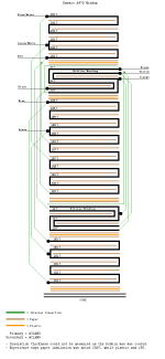

Here is an A470 OT windup diagram provided by Bob Latino here:
The Old A-470's cloth lead vs. new production outputs ...
and a later Dynaco (Panor) ST160 schematic provided by Bob Latino here:
The Dynaco (Panor) ST-80 and ST-160 tube amps of the mid '90's
The A470 looks like it has the same low number of interleaves as a Hammond or Edcor OT, but has two sections with bifilar winding, presumably the part of the UL sections with matched AC to the secondary. If one were going to make an improved A470 OT today, I would put additional parallel secondary interleave sections into the design (with inter-layer insulation). The old A470 may have the same poor leakage L for the outer primary side winding as I found in an Edcor. So moving the HF Fdbk cap (lowered to 0.4 x 390 pf) out to a plate winding may not be an option, if that is the outer winding on the core.
