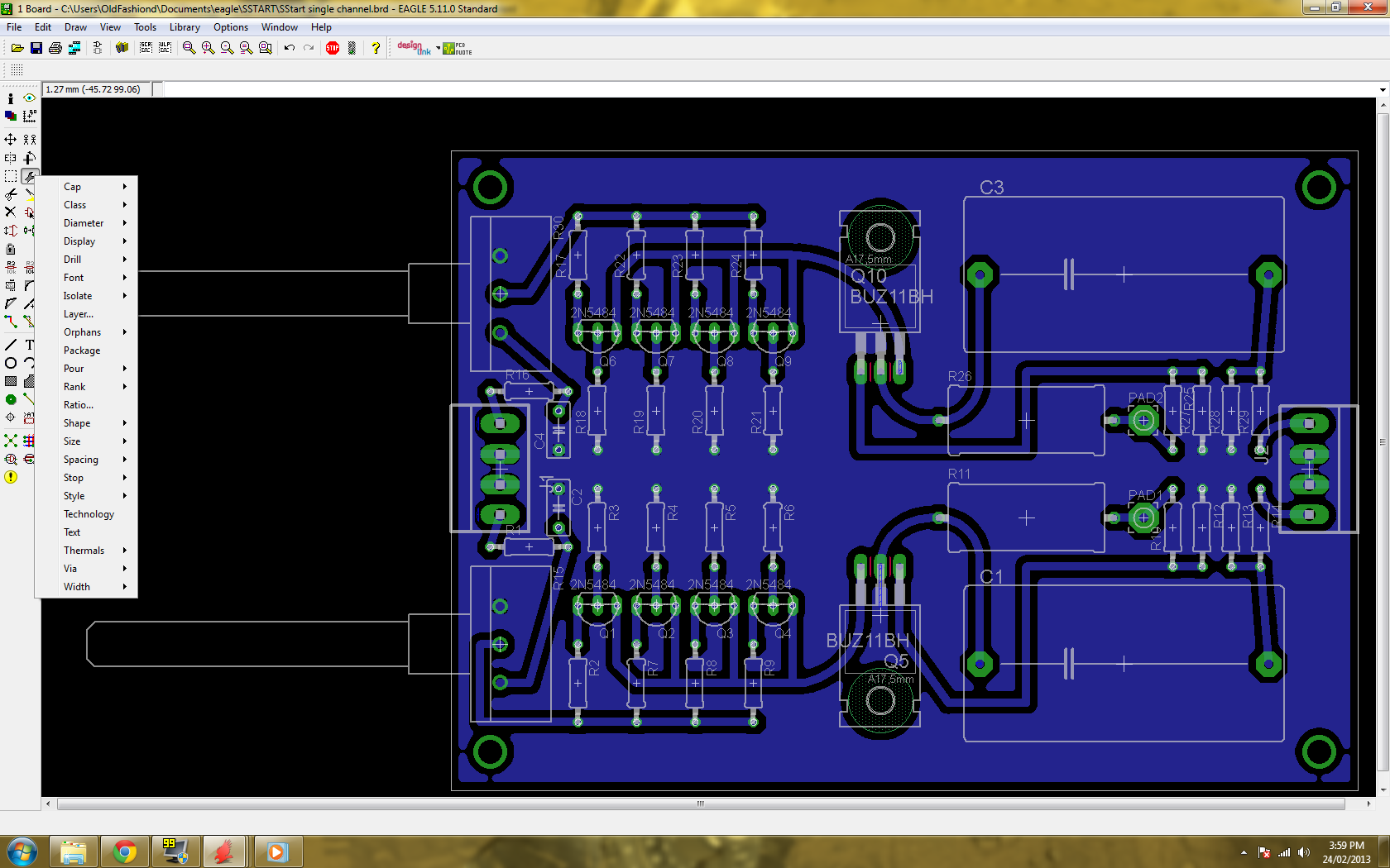

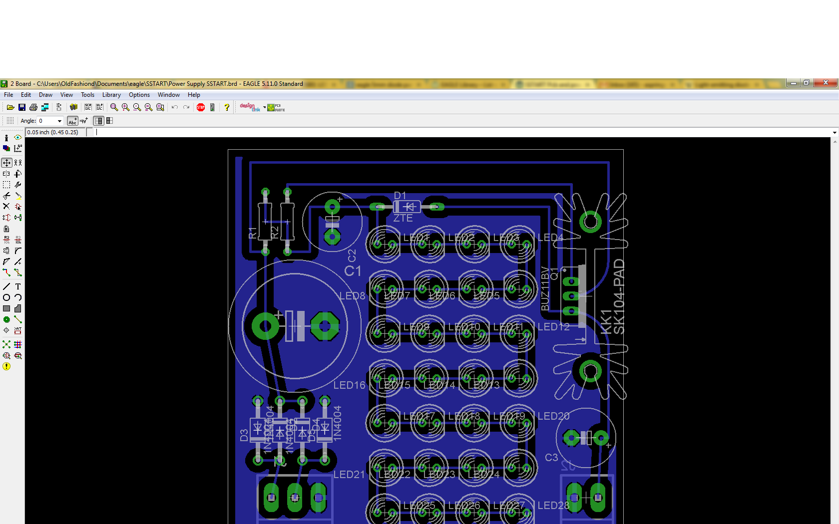

Done, made a few other improvements, like the option to use multiple power supplies, popped a few caps in around the place for psu decoupling, and included in pads for the surface mount fets if used.
Those bf862's aren't overly expensive either...
As before the part names are incorrect as I haven't bothered to create the appropriate parts in eagle - I've just used equivalent pinout/profile parts already there.
Belated Progress

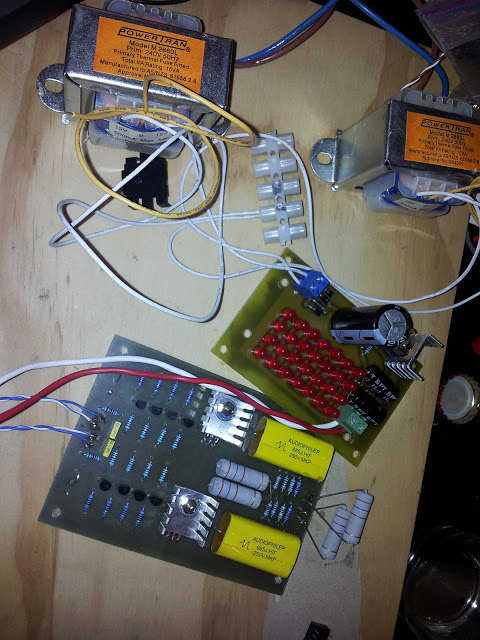

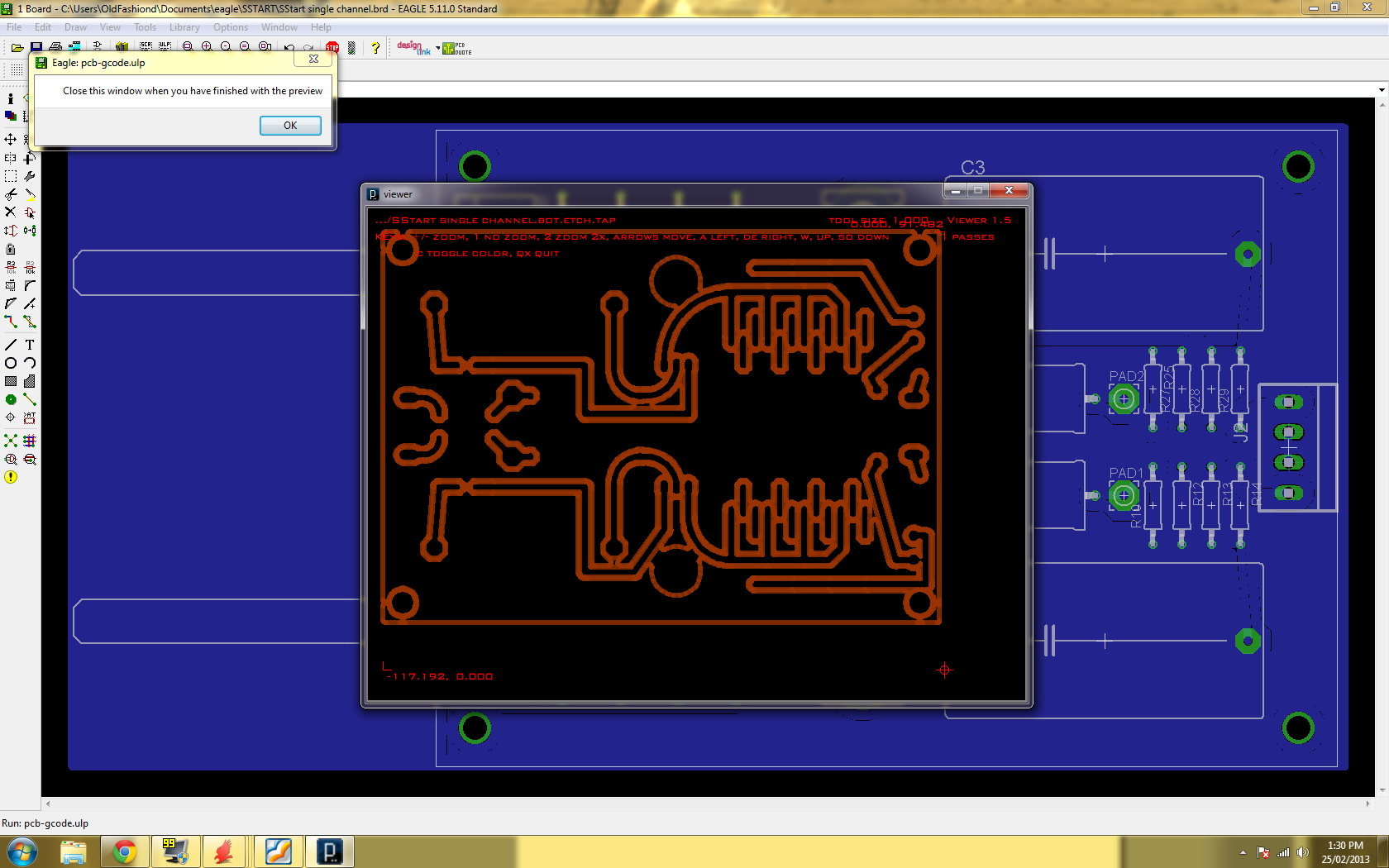

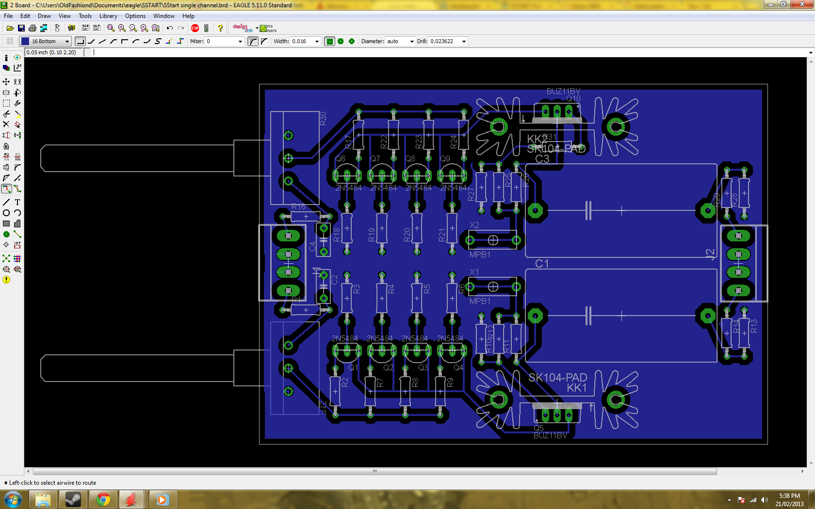

And here's where I'm at with it now. I've put a slow start on the board, so the turn on thump should be mitigated. Otherwise I hope I've designed a sensible layout...
I bought a bunch of bf862's, J109's and J111's and I've a stash of J310's so perhaps I'll build a few of these to see what the differing jfets sound like (if indeed there's a difference I can pick). So that's an idea to pursue if I fancy it.

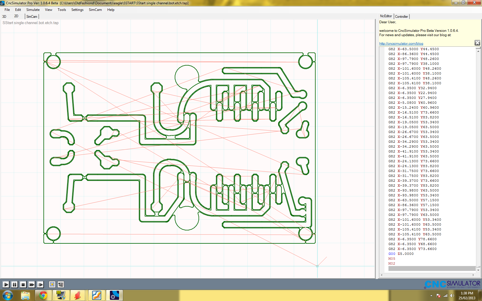

Anywho I'll etch I few of these soonish (or seeed them) and see how I go.

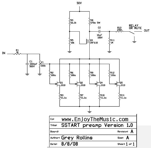

replaced IRF610 with IRF510 (possible model issue) and changed 22.1K resistor to 40 Ohm.
Now, thd is below .1 percent for unity gain with 2V input at frequency of 1K.
Sim results
Here you go - input is 10kHz @0.5V (1V P to P), out1 is without feedback and out2 is with minor NFB. The log file has the FFT output numerically, and the THD numbers.
I've BJT's in as the cascode element for no real reason other that I read Pass saying he prefers to use a BJT there.
Hope thats of interest!
THANK YOU! This is of excellent interest!
FYI: The version I posted gives under 0.2% thd at 10K, with 2V input and near unity gain, using that analyzer tool.

@BigE I reckon your R1 value needs to be about 30k; the dissipation in your J310's will be quite high at the moment I'd say (magic smoke levels!). Hold <alt> and mouse over the part.
I'm also just learning LTSpice (yes it is awesome!) I'll have a play with your model also and see where I get to - great to have someone to bounce ideas off!
Excellent!!!
I was looking for the blue smoke button somewhere.... Turns out that it is within the range for the fairchild to-92 style, but they still need heatsinking. The smd stuff and te ON-semi will just blow up. It's SO good to know about that trick thank you!
The inclusion of the feedback is great! I just don't know how much is ok.
I'll take a look at your model at some point.
Cheers!

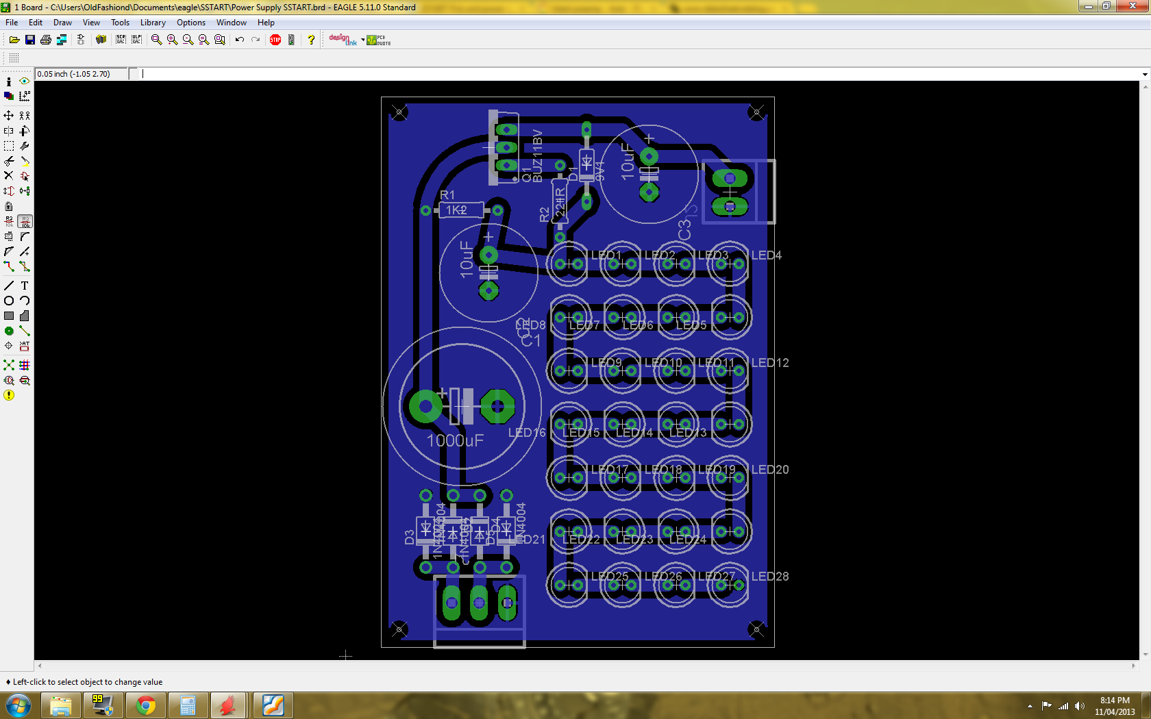

I realize this is an old project but any chance you have any files that you wouldn't mind sharing? I have a cnc sitting yet-unassembled in the box but something that can be etched would be great too! I've got a roll of BF862 as well as a bag of J310 collecting dust. Anyone built the SSTART with some impressions on sound?
Heya - I was looking over that PCB and I can do a bit better these day's, and given jlcpcb costs what it does, I could make a pretty compact 2 sided smd version of the board if you're keen...

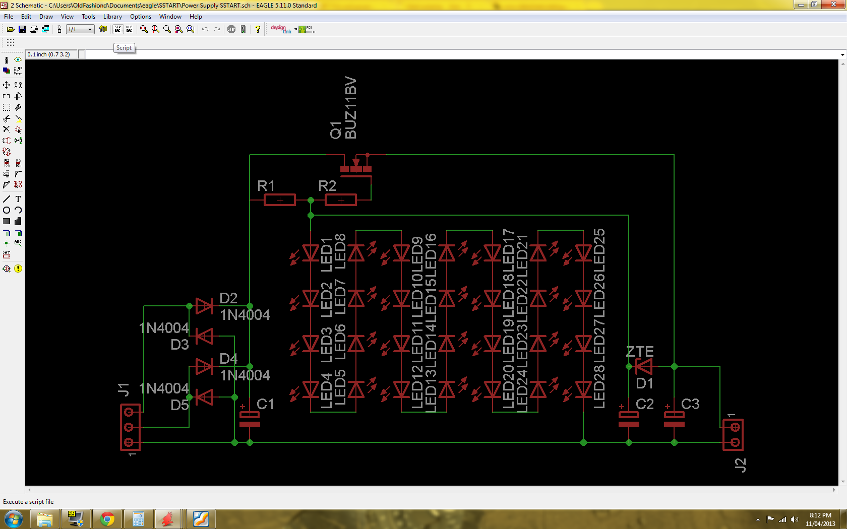

I also realised that the designs I gave you have a regulator pcb (led reference for funsies), feeding into a slowstart on the preamp board. Not really a problem, but not particularly elegant. Again, happy to knock out another board if you're interested.
Whats your goal here? I'm even wondering if I go ahead and do a design, and if you're keen we could share a pcb order.
