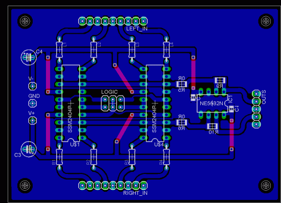

I want to build a channel selector/mixer, followed by PGA2310. Most natural choice is virtual ground with some sort of switches. Now I have a couple of SSM2404 laying around. These switches are supposed to be absolutely transparent in current switching (as any other solid state switch, see SSM2404 datasheet for demonstration) and allow much more compact layout than say relays (example pcb attached).
A handful of relays is also an option but good ones are not cheap, take a lot of space, draw more current etc but supposedly give better performance.
Now, given that SSM2404 has already vanishingly low THD levels, would it make any sense to use relays instead (audiophile superstition exluded)

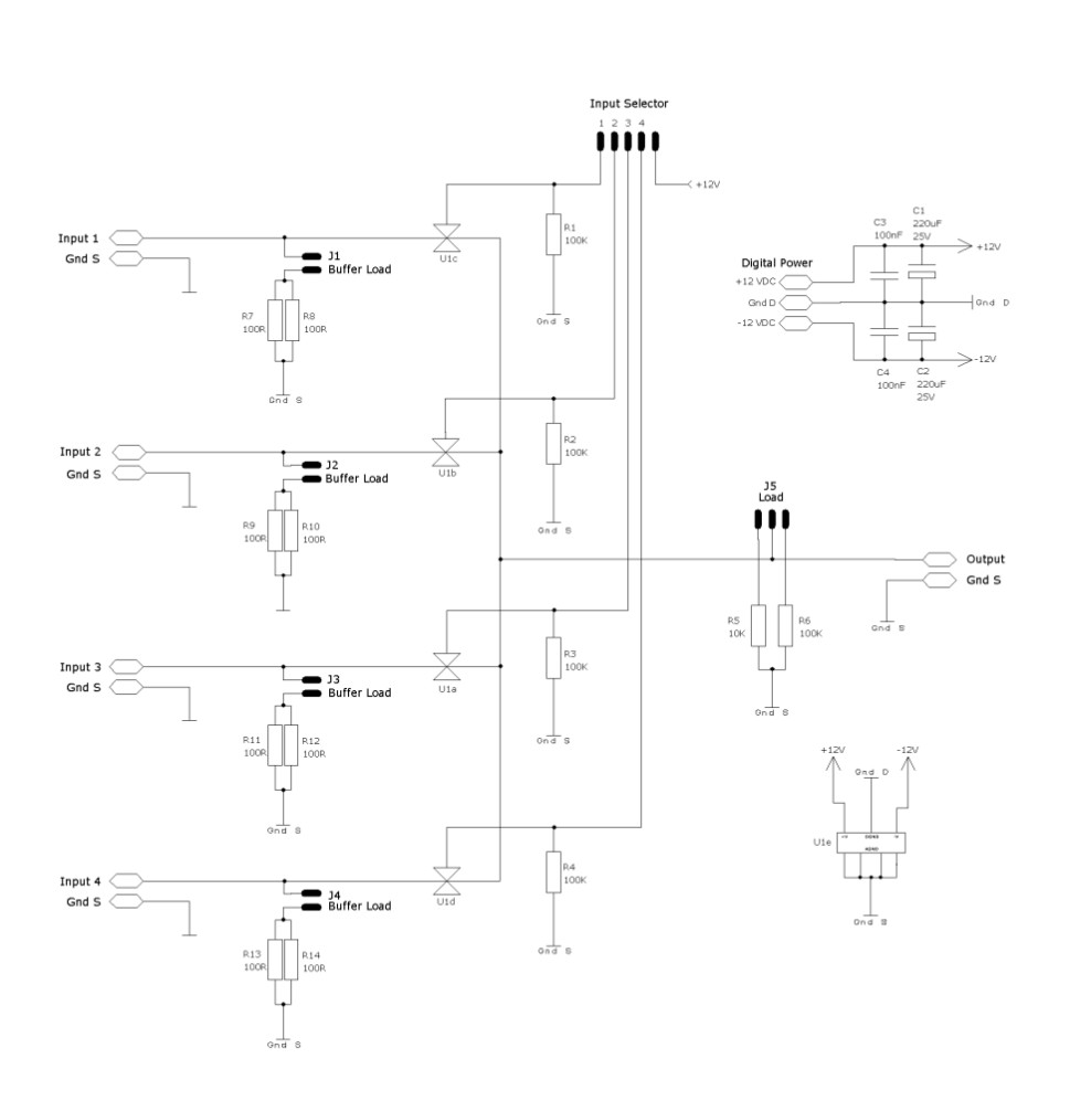

Is there a schematic published anywhere? If not, could you share the SSM2404 section?

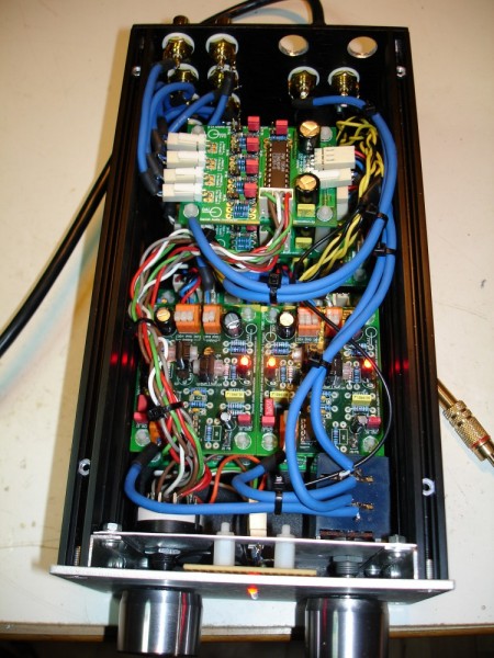

And here is the test rig that have been running for the last year.
Two SSM2404 mono Input circuits (at the far back), each with it's own regulated power supply. In the front you see two mono Output Buffers (also each with their own regulated supply) to connect to the Power Amp.
What a difference compared to normal interconnections ;)
