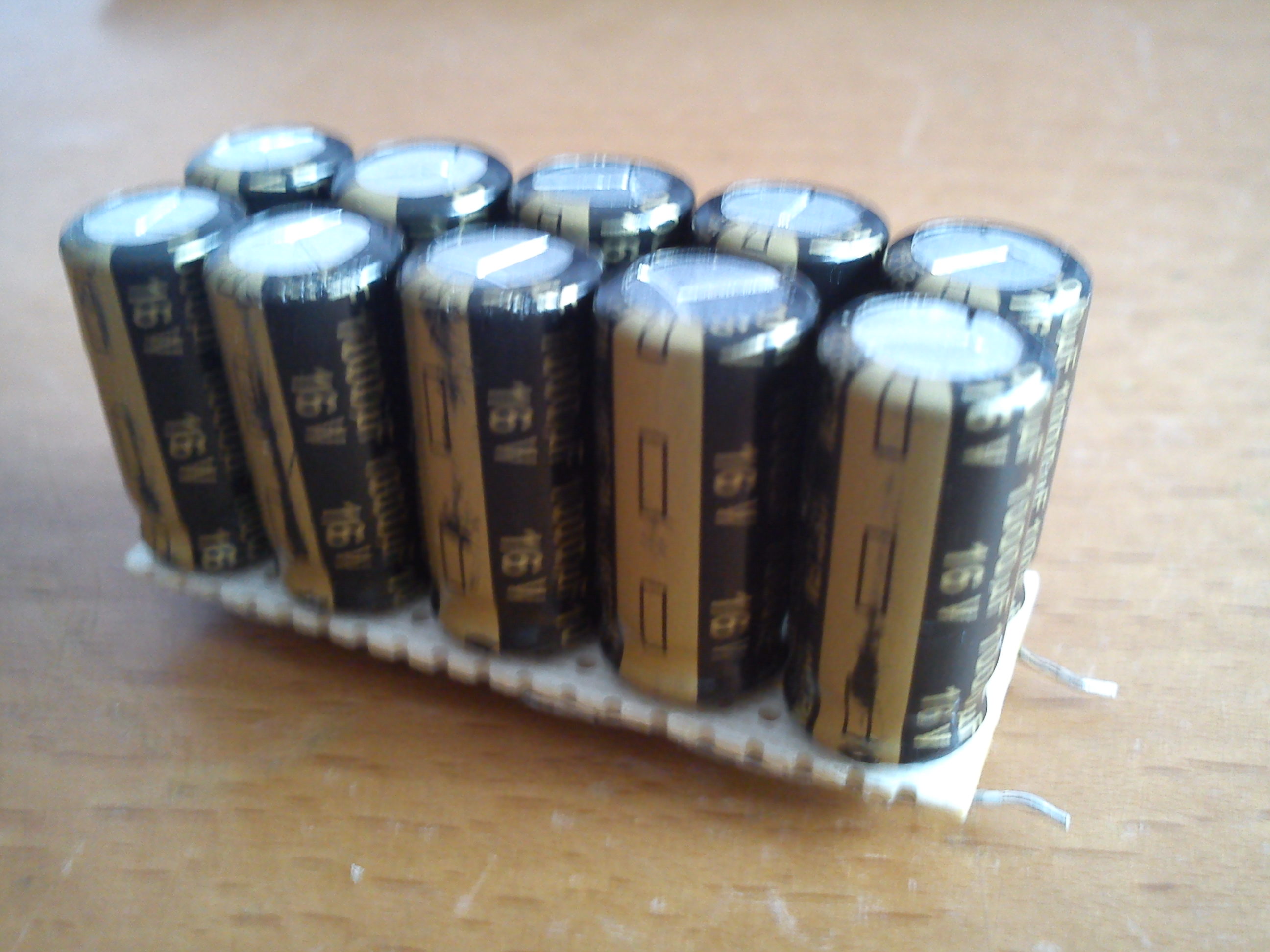

Better put 10 caps in paralel 470uF Pana FM
Real scary :eek:
