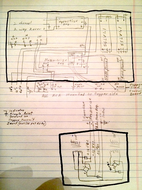

I have complicated my life with a pre-amp with 3 different regulated power supplies coming from two different transformers.
I have been drilling and fitting and reading and drawing and building and now I come to the fun part (it is all fun) trying to figure out the grounding.
I have attached my hand drawn block diagram showing how I thought this would work right up until I got to the SSLV1.1 regulators driving my Salas phono boards (thank you Salas!).
Now it gets complicated. These regulators have a plus and minus sense wire and how does that effect the grounding for the phono boards?
My original thought was to run every ground to a central point on the copper clad circuit board I am using to hold the RCA input/output jacks. If this looks like it will work please chime in and let me know where the minus sense wire is connected.
The other way to do this is to not ground the ground wire coming into the pre amp, but to run individual ground wires to the regulators, daisy chain the audio board grounds from the regulators and bring the audio board grounds to the RCA copper board central ground.
I haven't committed yet, so I can do it either way. Which way is the least likely to hum?

Hello Rush, your PDF presents just a blank page to me at least. Anyway, in general the sense mean to be near where the consumption nodes are. So you should attach your (+) force and sense centrally to where the JFETS nodes draw mA since they all draw about the same in the phono. You should attach the (0) force and sense on the phono board near its last stage's ground node where the signal level is at its strongest. Another thing is its no good widening the loop area between (+) & (0) cables to general GND nodes, it makes them more efficient an antenna. If there will be trafos in same box with the phono, its a hum no-no BTW.
Those were the consumption nodes. Now referencing to general ground is another thing, you may attach GND wires from those same (0) nodes to whatever central point of the whole preamp that does not hum back at you.

Salas,
I have built your phono and am using your regulators. I haven't fired it up yet. It has been a long project. The transformers are in a separate box.
I took a new jpg photo and enhanced the drawing so you can see my layout.
The crossover is a 4th order using B1 buffers between stages.
I hope the attachment is clearer.

Rush, this system is too complex to predict for best GND scheme. Just remember about the regs that their sense/force scheme targets load consumption close nodes only, as I detailed above. Will be happy to throw some ideas when you will try a likely plan first and can feedback results.
