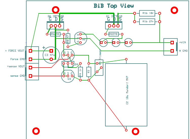

While waiting for BiB round 2, I decided to try it in p2p style.
I am posting the layout hoping all connections are ok.
diyAudio Chief Moderator
Joined 2002
Its all in the guides, but a quick answer would be about 5K total series variable resistance in the Vref. Check for ~3mA IDSS Q3. That one you show has those resistors in parallel than in series and misses one or two LEDS VS the PCB one. Will work also, if maybe a bit driftier.
