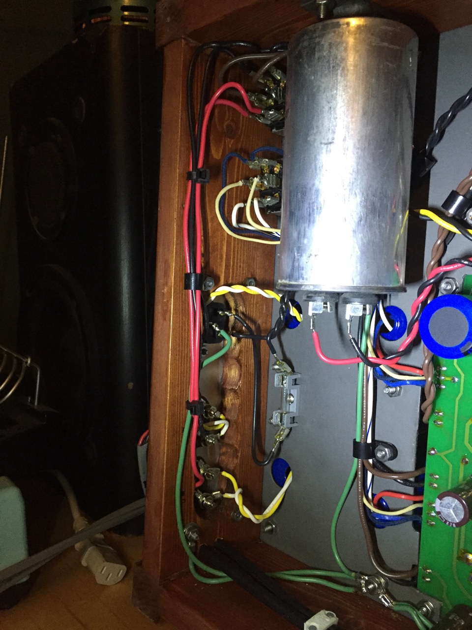

OK, I'm confused...kind of. I'm using the Edcor CSXE (5K primary, 8 Ohm secondary). The output wires are labeled as Yellow - 8 Ohms and White - Common. When I activate feedback (enabled), my signal gets louder. Obviously, that is an issue. Previously, I had the polarity reversed and I barely had any signal output, but the signal would be reduced when the feedback switch was enabled.
When looking at the wiring diagrams from the Tubelab pages, it looks like the polarity of the xformer output reverses when it is wired for feedback (follow the green and black output wires).
This is like beating a dead horse, but I either get very, very low signal out with signal reducing when feedback is enabled or decent signal output and signal increasing.
I drew my wiring many times and it matches the wiring diagrams. Just not sure why feedback is not correct.

My OPT only has a ground and an 8 ohm tap - the yellow is the 8 ohm tap. I can take some better pictures tomorrow if needed. I wired it exactly as it is shown in the left channel schematic (the one wire is clipped off the top of the right channel)... The secondary reference to system ground is on the 8 ohm terminal - this caused me to pause and think. Those more experienced than me can tell you why it is not grounded at the black speaker terminal.
Either way, I wired it exactly as per the diagram, and it works well.
-- Pete

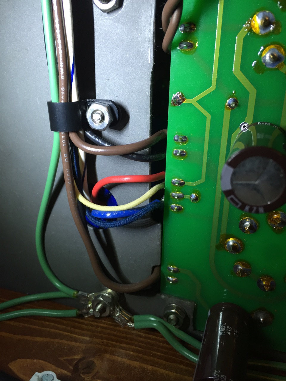

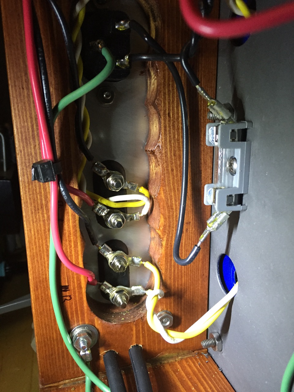

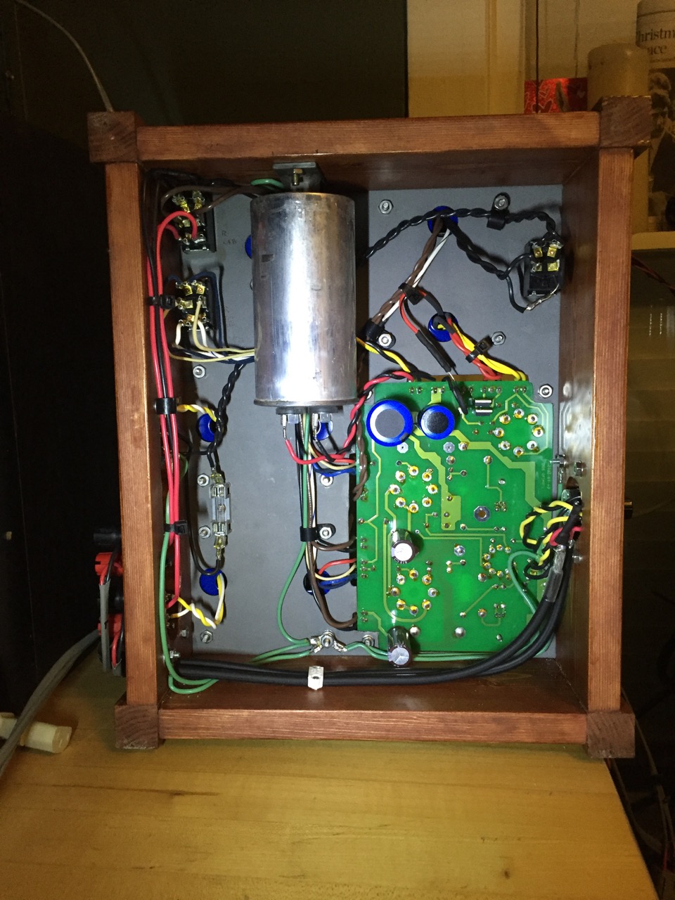

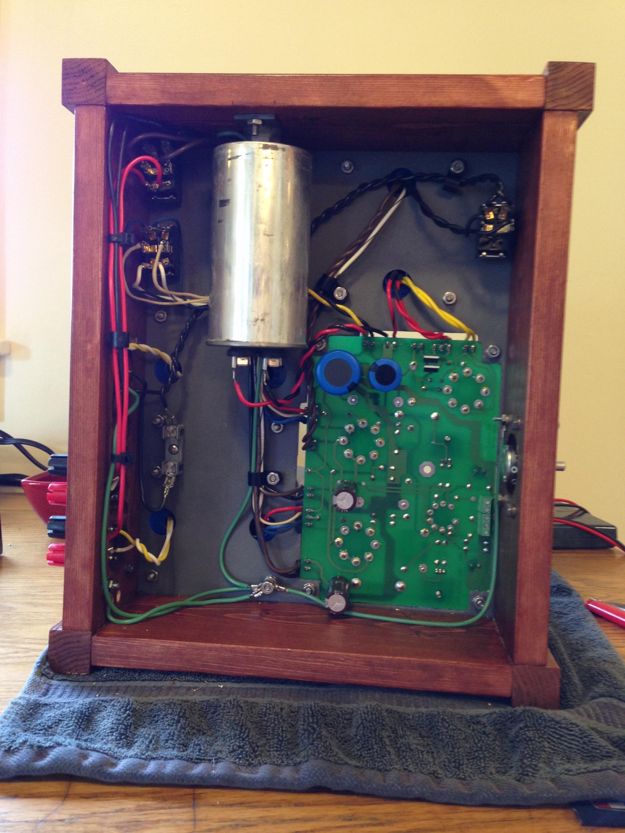

Pete, if not too much trouble...one more photo showing your red and black wires meeting your yellow and white on your banana jacks.
I understand what you are saying about your system reference ground. NOt sure why I am having an issue. I have the Edcors with the white and yellow output wires as well.
Hopefully this clears it up. Are you sure that you don't have it correct as is? When you send the 0 tap (white wire) to C22, it should get louder. When the 8 ohm tap goes to C22, it should get quieter (feedback engaged).

Update:
Amp is finished. My problem ended up being an issue with polarity. When connected for feedback, polarity reverses. I did not swap my test cables going to my load / oscilloscope. The oscilloscope ground was shorting the output signal. Inverting my test leads (for polarity correction) and everything was good.
Thanks for the photos again to keep my sanity!
