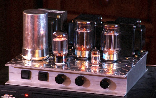

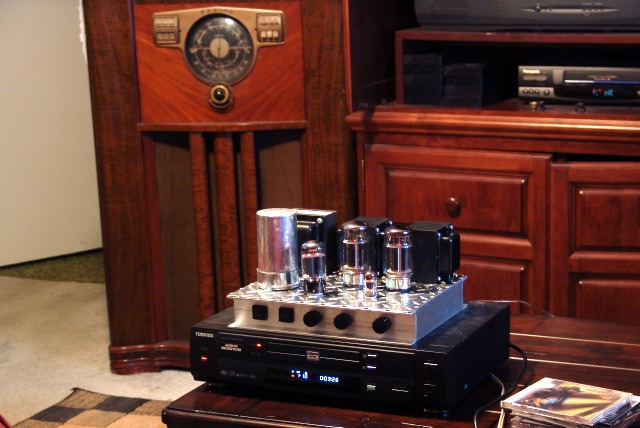

I had a switch with multiple different cathode resistors in my SSE to allow for current levels from about 60 to well over 100 mA. Most of the time these Electro Harmonix KT88's ran at 75 mA or so. They got cranked up to about 105 mA whenever I hooked the SSE up to these open backed old radios that contained Hawthorne Silver Iris 15 inch drivers. The extra current fixed the boomy bass in the uncontrolled damping of the open back radios. I also cranked up the current with my Yamaha's when playing something bass heavy like Depeche Mode or ZZ Top. The KT88s worked in the SSE / Yamaha combination for most music, but I tended toward EL34's with the Yamaha's unless I wanted to get loud.
I still have those old KT88s. They have to be at least 12 years old now and still work great despite the abuse. It seems that the newer EH and other Mike Mathews Russian brands don't last that long anymore.
Reactions: 1 user
