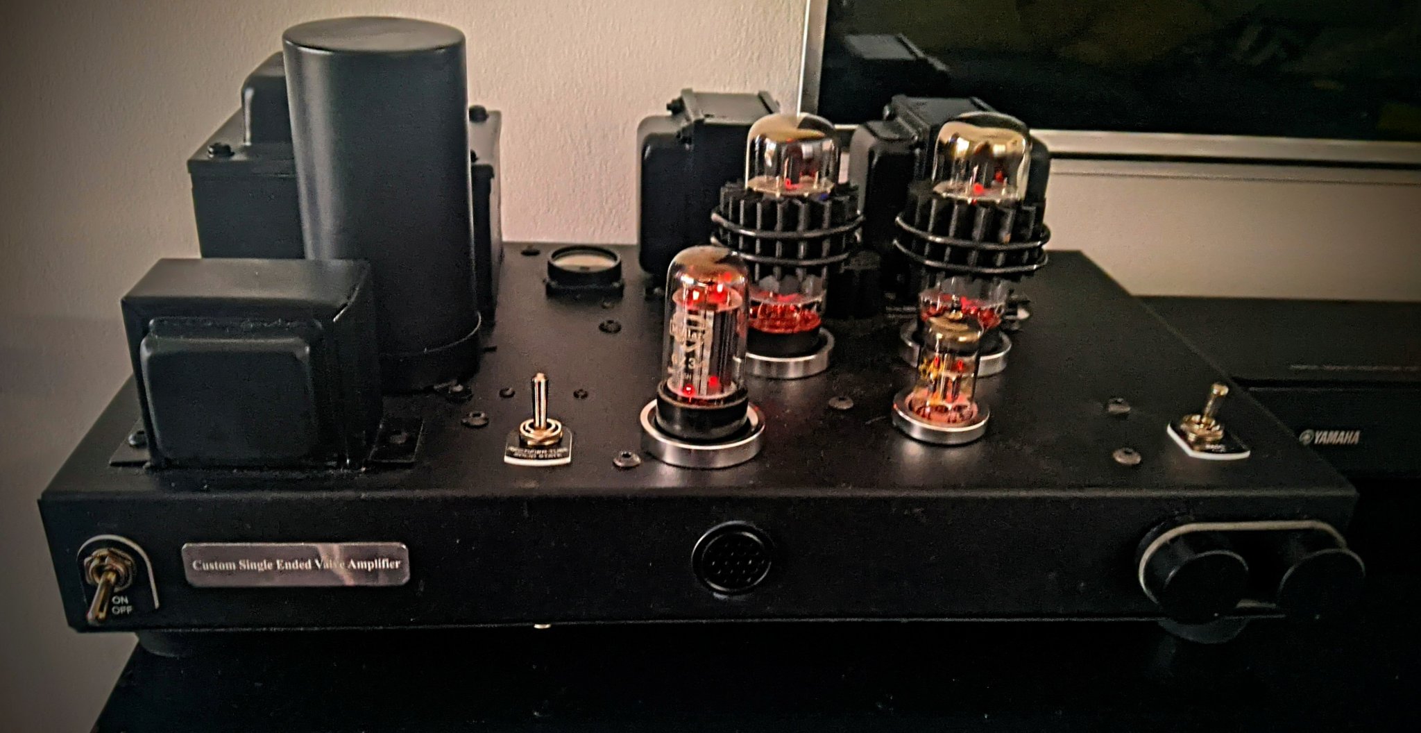

Today I retrofitted a cathode feedback switch.
I don't really hear much difference with it off (previously had it hardwired on permanently)
This is in triode more, which has now become my preferred listening since yesterday :) when I added a switch for it.

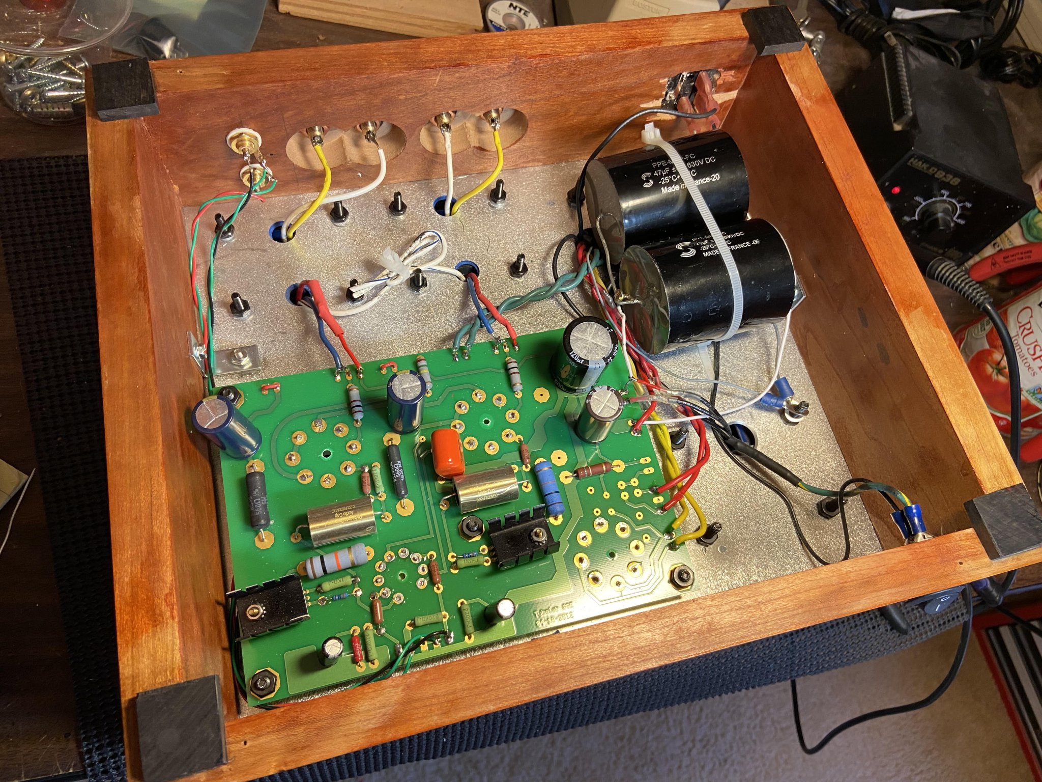

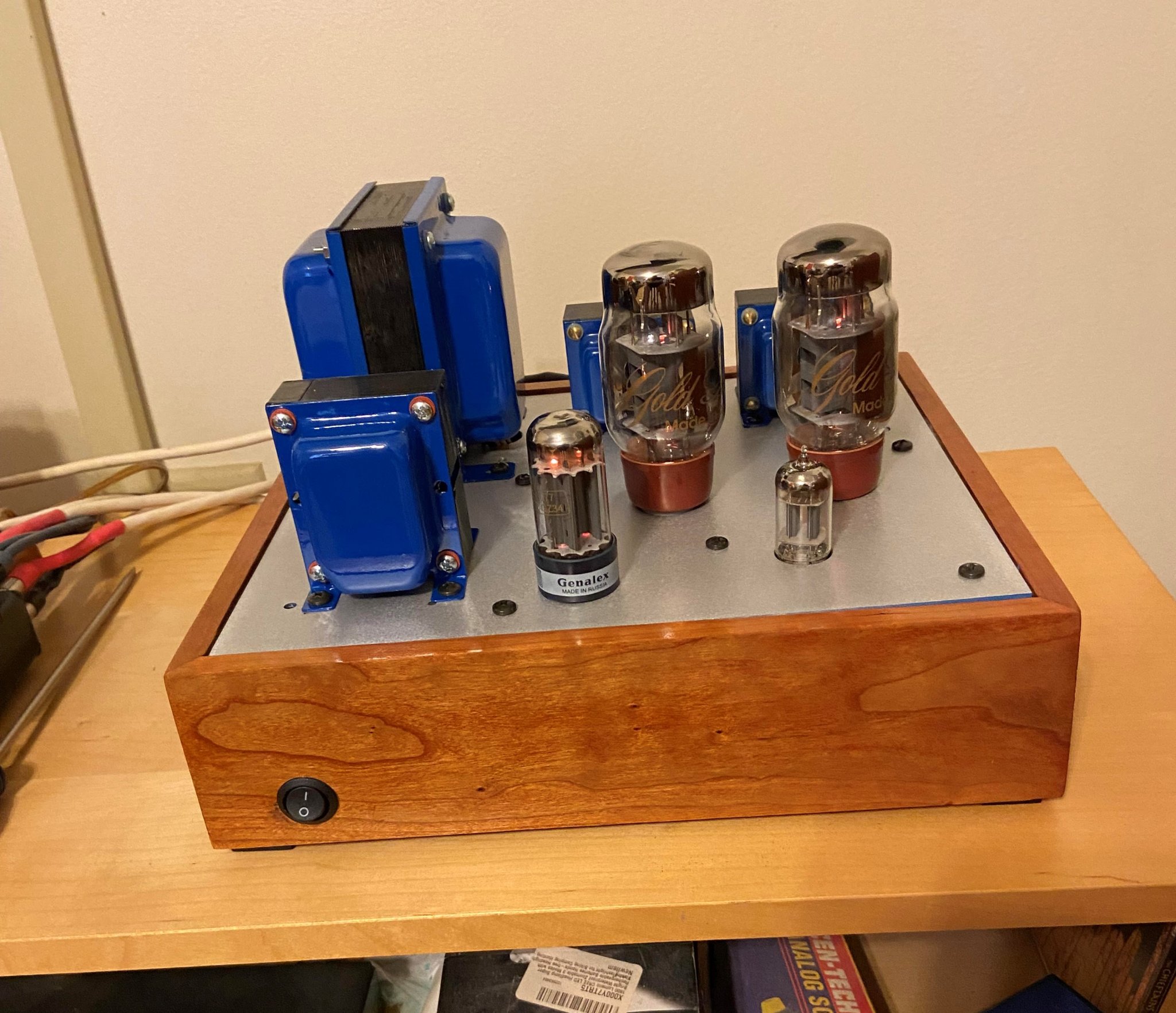

My problem SSE has been up and running for a couple of weeks. All it took was a new power transformer, the original from my first build almost 20 years ago, an Allied, quit. The center tap wasn't center tapping.

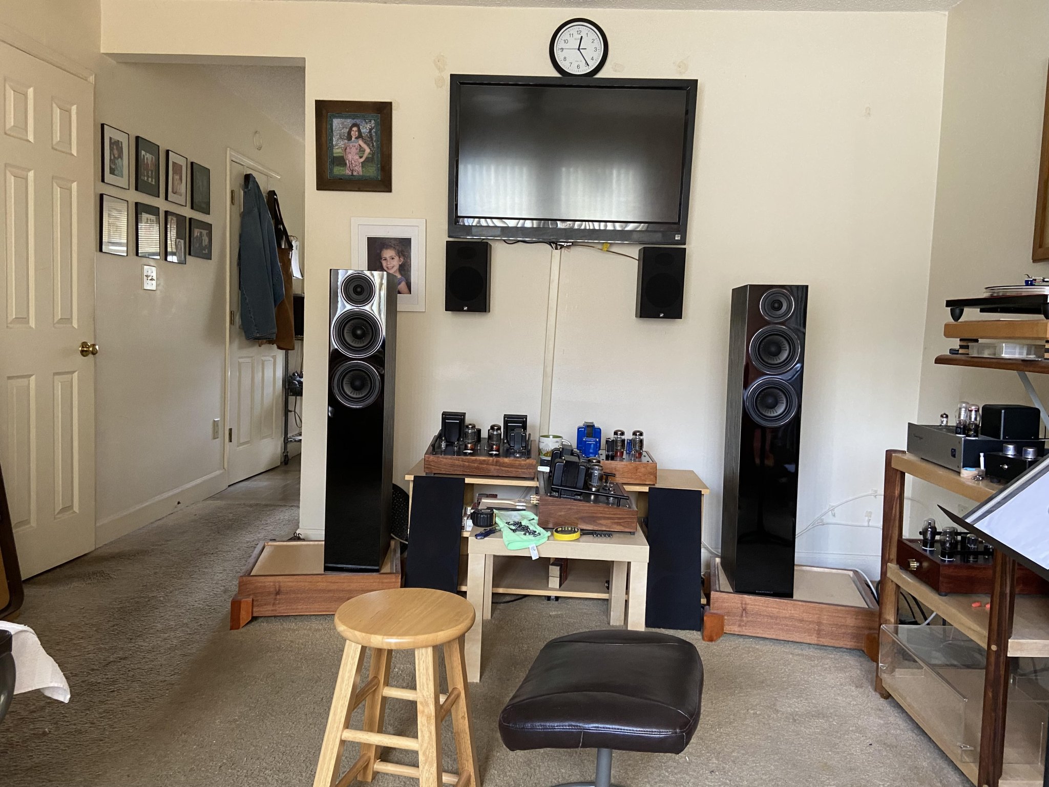

I've been snakebit these past few months, first one of my mono blocks failed which is why I built this new SE. Then, during the build, one of my 15 year old 4Pi Pros had it's JBL 2226 woofer blow. It's 16 Ohm and no one has a recone kit. I thought about a new pair of 2226H 8 Ohm, but the rather costly crossover parts are for 16. and a pair would be $1,000 plus new parts.
So I ordered a pair of Wharfedale Diamond 12.4s which arrived today. They sound great and the SSE has no problems even on large orchestral. I had been somewhat dissatisfied with the Gold Lion KT66 I included in the build sounding a little too romantic in the mids for my taste. That carried over into the Diamonds so I pulled a pair of GL KT 88s which sound great in the monos and that made the SSE/Diamond combo just right.
They're too high up perched on the sand boxes I had the Pi's sitting on which I'll fix as soon as I get some help to move them onto the spiked outriggers they came with. It was all 75 year old me could do to slide them onto the sand boxes and get them upright ;-)
