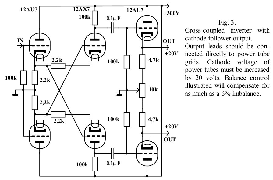

Here is am improved version of the Van Scoyoc cross-coupled splitter published in 1957:
http://www.next-tube.com/articles/cci/cci_EN.pdf

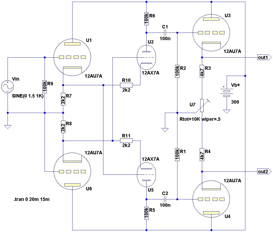

I ran it through LTspice, and it works perfectly. The only thing is, I don't get the bit about "cathode voltage of power tubes must be increased by 20 volts." My limited knowledge of tubes does not help, especially since the simulation works without this. Why is that necessary? To improve the voltage swing range? In practice, would this be implemented with voltage divider resistors off B+?
The phase splitter's O/P cathode followers and the O/P tubes' control grids that are DC coupled to them "sit" at +20 VDC. Correct operation of a tube, with few exceptions, requires the control grid be negative with respect to the cathode. Implicit in the remark is a cathode (self) biased set up. Since the control grids of the O/P tube pair are at +20 V., instead of 0 V., the cathode has to be raised above ground 20 extra volts to achieve the desired operating point. :yes:
If the cap. coupled O/P cathode followers are replaced by DC coupled ZVN0545A source followers, cap. coupling to the O/P tubes' grids can be employed and any valid biasing method will work. :)
