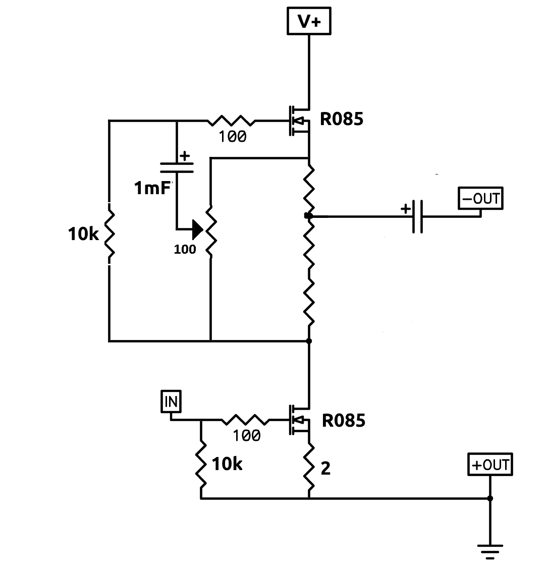

I think I understand the concept that the mu follower resistor network between the lower drain and upper source will work like the PLH-pot, going form push-pull to pure CS I have some questions about how this would be realized in practice with 2 R085 or similar depletion mode parts:
Would it really be as simple to do as the first schematic? Or do we need a cap and a resistor network from top/middle of network to the gate as per The Valve Wizard -Mu Follower
Or would the answer be: We use the cap to allow the AC signal to pass fiddle the pot to bias the top R085?

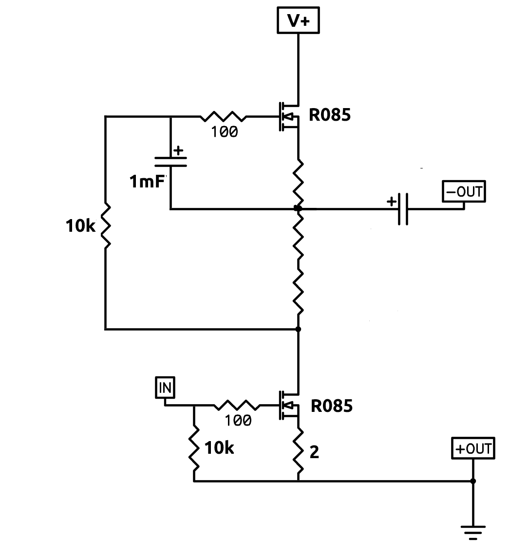

Cool, lets see if I understand it now: the zen pot over the resistors ensure that we don't need to move the output in the resistor network but can instead fiddle with the pot. If we don't want the pot we would connect the cap at the output and then move the output up and down instead, but a pot is of course easier if we want to trim back and forth.
If we turn it to the bottom the top R085 acts as a CCS, if we turn it to the top it will be quasi push pull and something in the middle is probably our goal where Nelson liked 2/3.

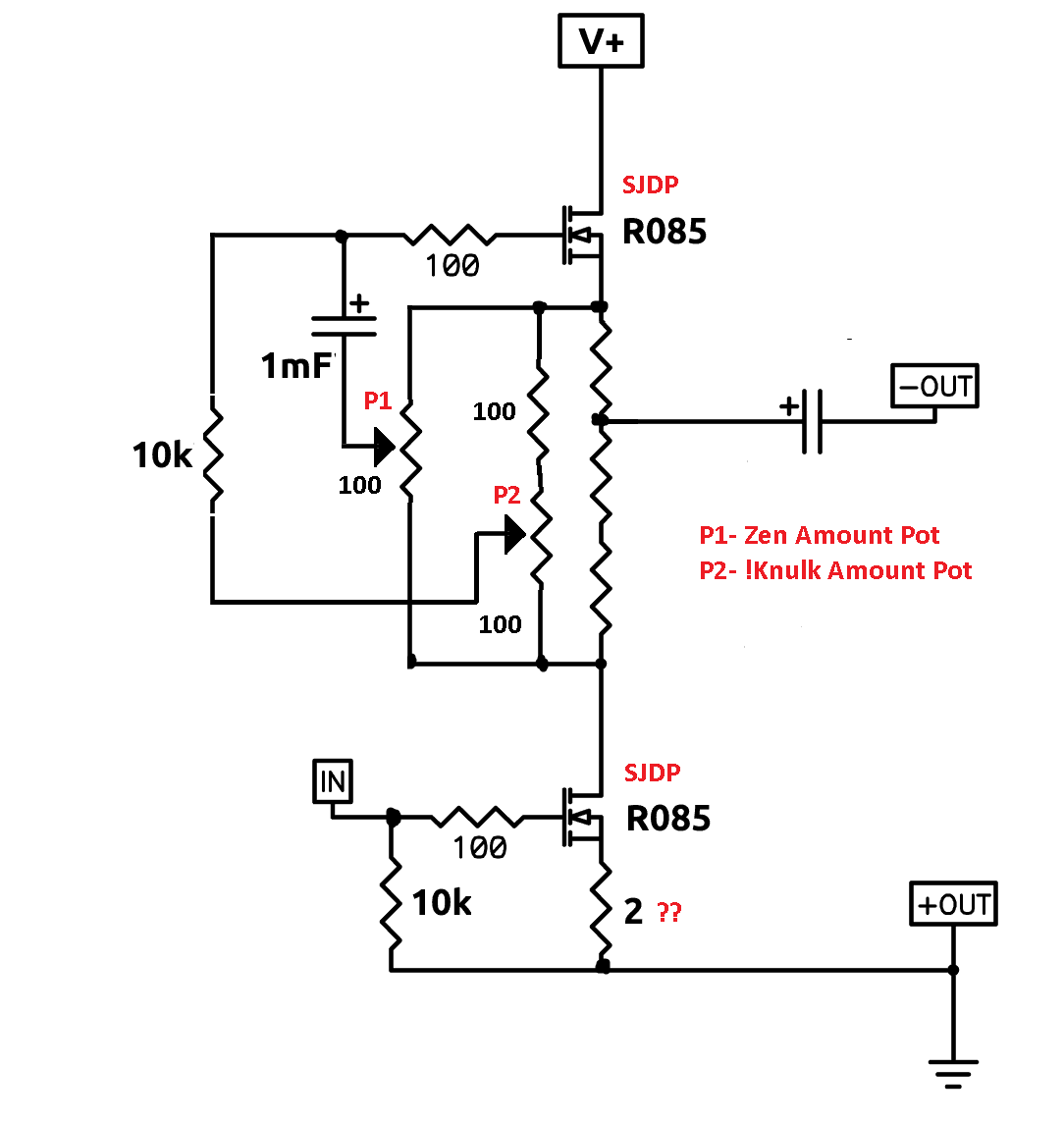

yup
you can put another 100R pot in parallel to existing one , and connect 10K resistor to wiper - handy for biasing that SJDP
first one is so called Zen Amount Pot
second one can be called ZZZZing Amount Pot , or AntiKlunk Amount Pot , or !Knulk Amount Pot
!Knulk being 1/Klunk!
:clown:

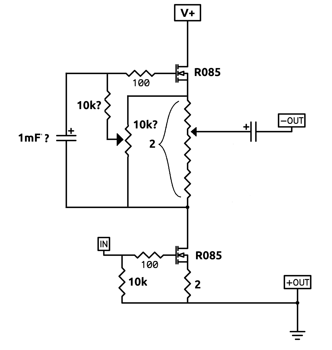

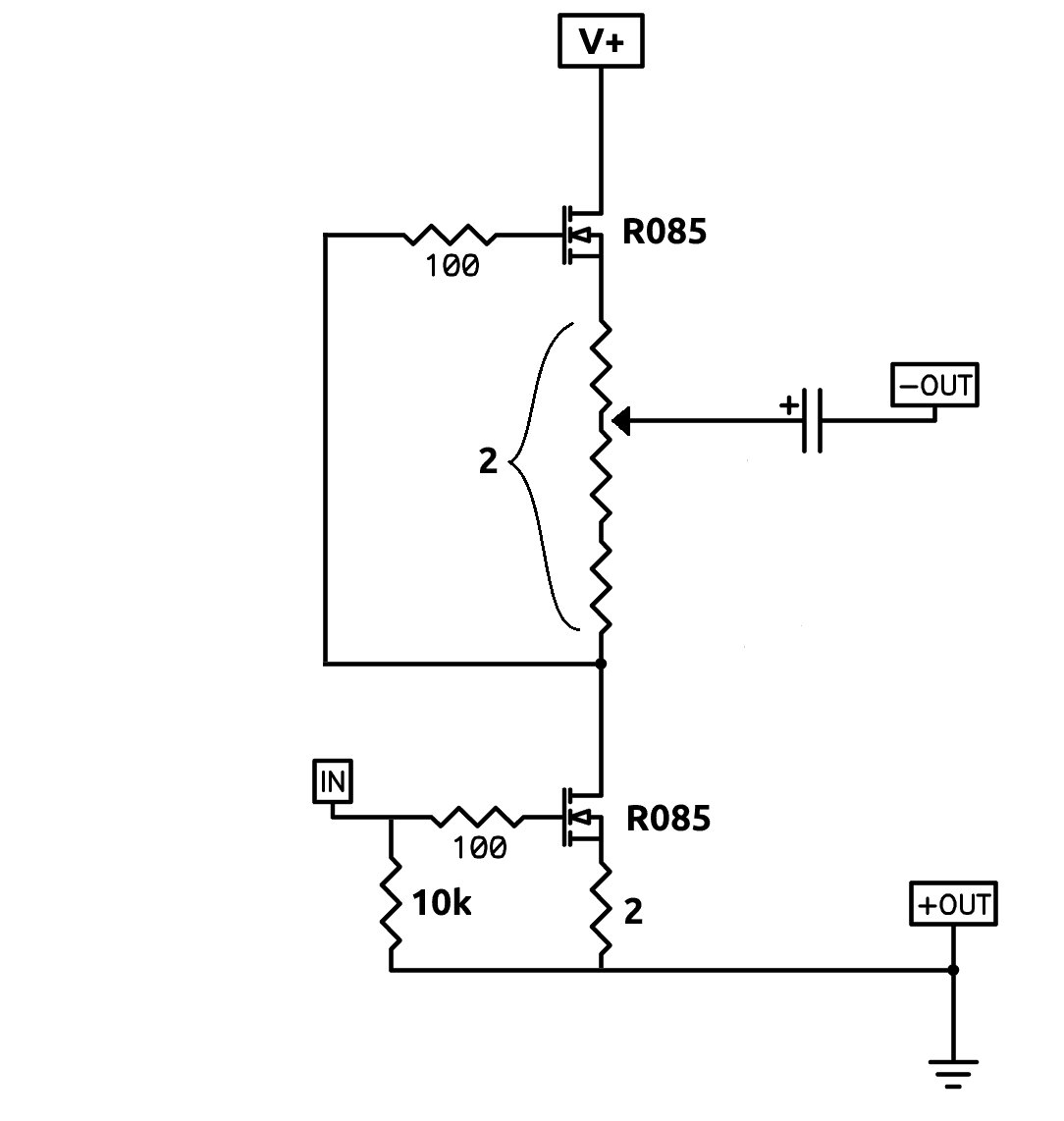

Re-done after initial obvious dumbness:

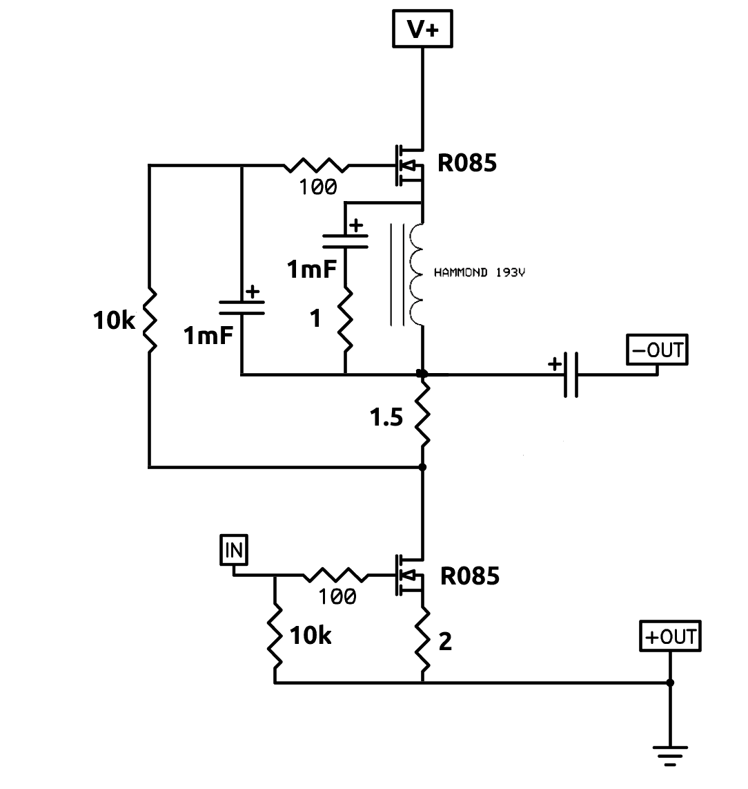

When we are at it what if we do something crazy? If I've understood correctly inductors as they make awesome and efficient current sources so can we make an inductor loaded mu follower? The idea would be to get mu follower distortion cancellation with an inductor efficient CCS.
The question is just if the cap in parallel with with the inductor will defeat the efficiency increasing properties of the inductor making it into just a big and expensive resistor =)
