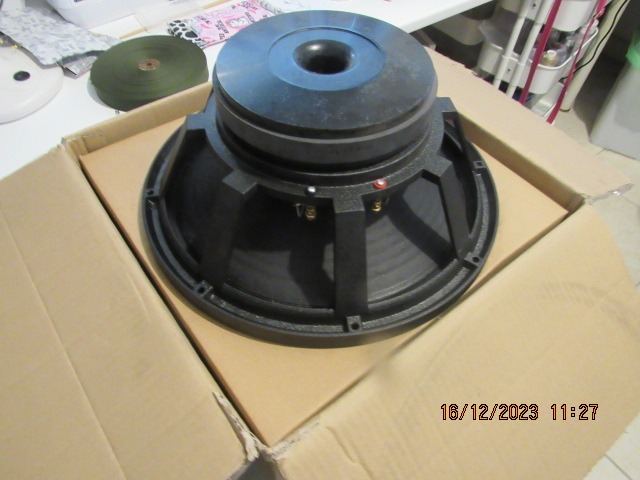

Asking because I have misplaced my Woofer tester. I cleaned off my desk and my wife put it away somewwhere.
I bought it second hand locally and only paid $50- so I am not too fussed.
15" and quite a large magnet, pressed paper cone and a double roll rubber surround
But searching I can't find any information and running it out of the box it sounds a bit bright for a bass driver
Any ideas while I search for the little black box?

Looks like I've bought a dud driver
I just opened Audacity and tried to play a 30Hz sinewave though it and just got a buzz
I think the voice coil is frozen in place
I'll contact the seller and try and get my $50- back

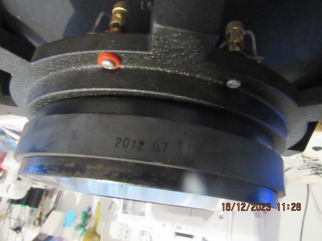

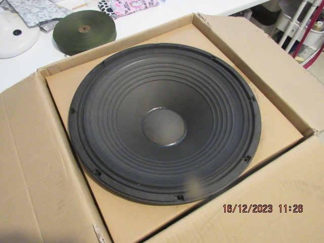

Well picture tells much more.
Pretty heavy duty cast frame
large magnet speaker.
Definitely not the SQ stamp steel
frame I was expecting.
If it feels locked up.
Usual overheated voice coil.
Would need new coil.
Either would need new soft parts as well.
Or someone that can recone / save soft parts
when just the coil is damaged.

If the magnet has shifted there may not be any reconing it. I’ve only managed to salvage two drivers that had magnets shift - and both of them had very loose tolerances and big air gaps. I managed to shim the coil with index cards (like when you are reconing) and put a bead of epoxy around the magnet and pole piece on the outside. They wouldn’t stand being dropped again that’s for sure. If the magnet is very strong (this one looks like it) or if the gap is tiny (a good driver would be) then getting shims in there will be damn near impossible.
