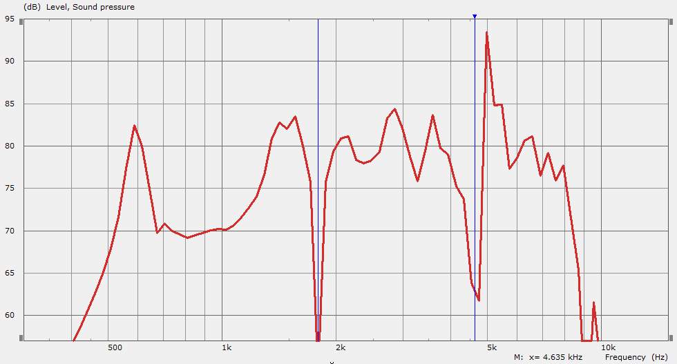

Well, I had a go at simulating the Paraline (see post 862with BEM in Abec3. It´s probably strictly not a paraline, since I didn´t really think about dimensions.
It was really an experiment to see if the BEM solver could handle it, and if there are any learnings from it.

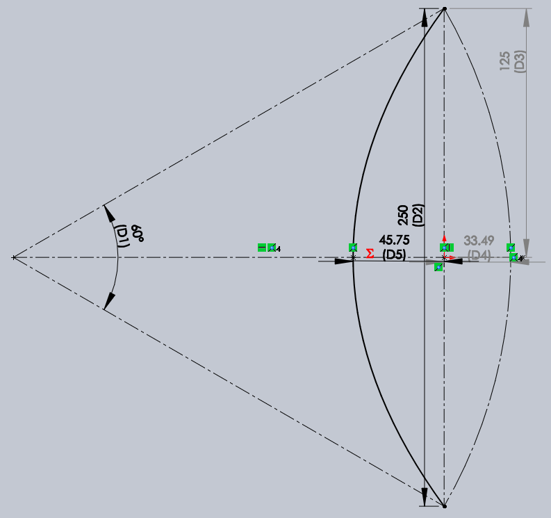

So, aiming for a 60 degree vertical angle, this is how to arrive at the curve. Draw the 60 degree arc, then make a parabolic arc with depth (D5) = D3/2-D4/2. This ensures that the total distance traveled is equal in all directions.
Note, the height (125mm) was randomly chosen - more on that later.
I thought it was a good idea to split the paths into segments - perhaps that was a bad idea, perhaps it works out well to reduce resonances in the material. ABEC doesn´t simulate that (i think), so it won´t matter here, but it could have other effects.
I won´t describe how all the layers look, I suppose it´s pretty standard, except I added 45 degree reflectors also inside the fold. (Easy to print, probably quite difficult to do with wood). The dividing layers are 2mm, while the other layers are 6.5mm, which I think ensures there is no additional compression at the entry of the paraline, disregarding the change in direction that is.
Horn added, like in the previous post.

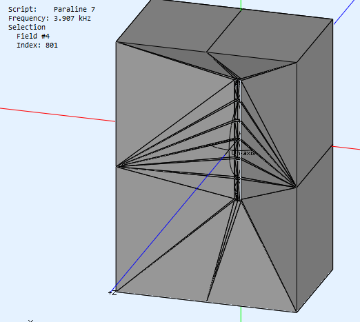

Getting the solid file into a mesh is quite easy, just export to STL. But for subdomain modelling, ABEC needs to know what´s the inside and what´s the outside. For that, I made a "negative", which basically shows the inside. That negative can be imported to ABEC, and normals reversed, so the mesh of the negative becomes the inside of the paraline and horn. From the image below, you can see the slanted reflectors inside the paraline.
In ABEC, the whole thing looks like this, after adding some simple walls to enclose the externals:
The model simulates everything inside the "negative" above as one subdomain, and then there is a boundary element across the horn mouth that lets radiation exit to subdomain 2 which is "everything else".
I set the mesh frequency to 10kHz, which translates into a rather fine grained mesh. Perhaps it´s too low, but with 10kHz it took about 1.5GB memory to solve, and memory requirements increase exponentially with mesh density. On my computer this took nearly 24 hours to solve for 100 frequencies between 100Hz and 20kHz.
The driving source for the analysis was a stock compression driver (i´m not sure which one even) that is included with ABEC. It has a one inch exit at least. If somebody has a known compression driver modelled in ABEC, let me know, and I can plug it in to see how the results are.

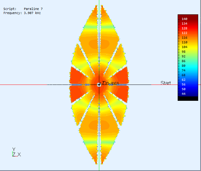

Anyway, here are the results:
Now, this is at 2m distance from the entry of the paraline driver. Pretty bad.

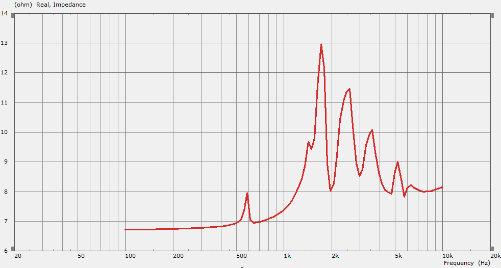

Impedance:
Ok, so how does this look "inside" the paraline. Since the paraline is folded, and I can only do "two dimensional" spectra, I chose the frequency of the second dip to examine, and only include the expansion layer after the entry.
One can clearly see two "modes" inside the paraline, caused by reflections I suppose. Why the SPL of the four center ducts are so much higher is beyond me, but it could be that the smaller path length to the bend cause the reflections to actually sum constructively there.
Anyhow, it does seem that the 250mm total length is way too much - set randomly as I mentioned.
It would be interesting to model one of the "successful" ones, or one with significantly smaller dimensions. Anybody care to suggest a length to try next?
I can also extract all kinds of charts from ABEC, but horn directivity etc is not that interesting with such a ragged response. But if there is interest, I could certainly post them.

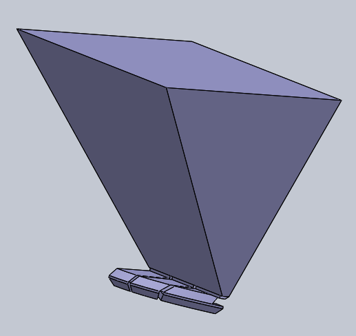

I ran some two dimensional simulations using Axidriver. Take these with a grain of salt - a real sim should be done in 3D. But the 2D sim will get you 'in the ballpark.'
Here's a side view. Your basic DOSC, from L'Acoustic
At 7429Hz, it's performing about as well as a conventional horn, but not quite as good
At 11714hz, the beam is starting to narrow. Basically it doesn't "see" the walls of the waveguide that it's attached to
At 16khz, comb filtering is rolling off the output of the driver. The beamwidth isn't much different than the device at 11khz, but the output is dropping off a cliff
