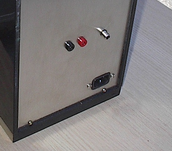

At home:-
I usually mark out with a soft pencil. Then drill copious holes (Centre punch the hole centres before drilling, so they don,t drift off centre when you drill through.)
Cut out extra material with a hacksaw. I have one where the blade can be set at 90 deg angles. Then its down to filling with a round and flat file set. You need to make sure that the files are sharp, and then removing material is easy.
Thanks all - lots of great practical (and not so...) ideas. Envious of you who have relatively easy access to Front Panel and the likes. Here we think we are pretty damn lucky just to get a pair of pliers and a 12 inch shifter...
Distortion of the panel is the biggest problem I have, closely associated with my impatience and tight-fisted approach to capital expenditure. Guess the first thing I should buy is a can of Patience and a two-dozen pack of Realism.
The key is to invest in good metal files. Rattail, triangle, flat, square in various sizes. If you've only ever used the rusty ones that were rattling around in the bottom of your dad's toolbox since before you were born, new files will be a revelation. Scribe the lines accurately, chew the hole out undersize with Unibit, nibbler, cutoff wheel, or saber saw, and file to fit. File in one direction only (away), holding the file with two hands. For small openings, like D-shaped holes for banana jacks, jeweller's files are helpful.
